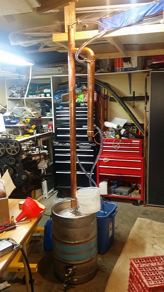

found some 48 inch dryer gas line at homedepot and it looks like it will work
getting close to finnishing went for this style with 2 inch copper, wondering colum height
have 48 inch piece or can cut smaller(packed with copper mesh), to 2 inch T, 12 inches above T 2inch with 48inch csst coil in it
and off T 1 inch piece of 2 inch then 2 inch elbow into 24 inch shotgun got 1/2 in and out with 4 (1/2) pipes inside
question where would temp probe go on this design bottom of T between lowest csst coil goes but above the packing
hope to have some pics up this weekend
thanks for the design dad and thanks for the help
javaman
javaman
Re: Condenser Controlled Columns
Make column as tall as your space/ceiling can allow. You must also reach top to adjust reflux coil.
The only place a thermometer is "needed" is on the coolant water output from reflux coil. Keep the collant temp below 140F and you will never send vapor passed reflux coil. A thermometer in the vapor path is useless after the learning curve is over, just my opinion....you can feel the column with your hand to decide when the vapor is reaching the top of column.
But if you have to have one...it should be above the packing, close or in takeoff and shielded from reflux dripping on it.
got it done tried first cleaning run 5 gal water 2 gal vinigar
question i have is whats proccess to get steam to come down shotgun
pulled ccst condenser almost out just got a few drip not much
pulled right out capped top with 2 In copper cap got good trickle threw shotgun
any help getting ready for sacrificcal run just wondered does it change with alcohol
thanks for sharring your wisdom
java
java
- Posts: 739
- Joined: Sun Sep 06, 2015 5:49 am
Yes it will change with the alcohol run. Ethanol vapour is heavier than air so will take the easiest path. Out the shotgun
http://homedistiller.org/forum/viewtopi ... 50&t=59420
Here's my still. It's only a 2" version but I do run copper scrubbers.
