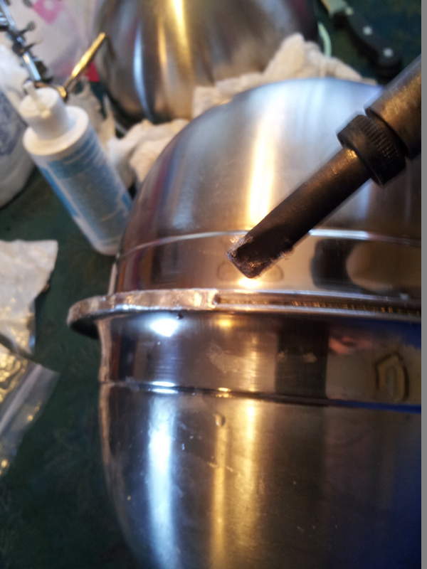

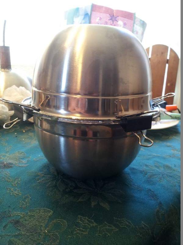

I have been working on things unrelated to home distilling. Tinkering with a couple salad bowels I soldered them together:
Pre-tinned the rim of the bowls. Used clasps to apply downward pressure and torched the rim around and around until the solder melted.
Back filled with my soldering iron to get a good seal:
Did a bit of grinding:
Put a tire stem valve in the ball. Ran the hose under a door jam...standing in the other room I pumped and pumped. The pressure rose to 130PSI and:
BOOM. The stainless ruptured at the valve. It must have shot it like a missle against the cement footer foundation...cracking the seal and denting the crap out of it.

Thanks for the tip on pre-tinning the stainless joint for ease. I discovered the hard way when trying to join copper to a mixing bowl.
Next time, I will start with pre-tinning
