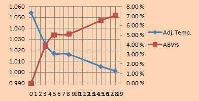

I am using the same recipie. (WPOSW) I do 55lt batches that strip down to 12lt. I am having the same issue with my fermentation times running a lot longer than I am hearing other folks ferments.
I have come to the same reasoning as you. I have tested my water and I make sure that the Ph of the wash is at about 5.5 I do this by adding calcium carbonate in quantities that bring the Ph to the desired level. As the fermet occures I notice that the Ph become more acidic. I had a stuck ferment on day 5 (Ph less than 4) and I added 5 tsp of Calcium Carbonate and one tsp of DAP. The ferment started off again and in a week the sg was down to ~.998 from ~1.055.
This weekend I am going to start another batch and I will try adding 5 tsp of Calcium Carbonate + DAP on day 3 to see if I can prevent the slowdown on day 5.

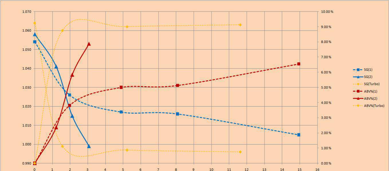

Below is a graph of the Sg and ABV% for the last run.
ABV Graph WPOSW - stuck at Day 5.jpg (14.6 KiB) Viewed 12797 times

Here is the follow up from the previous post.
This is where I had a stuck ferment on day 5 which I solved by adding DAP and Sodium Carbonate at which point it took off again. The question I wanted to answer was if I continuously added small amounts of DAP and Sodium Carbonate would this then prevent the stuck ferment and would it ferment faster given I was providing a better environment for the yeast (less acidic and more nutrients)
So
I have done another WPOSW wash identical to the previous one (see above) however each day I have sprinkled 1 teaspoon of DAP and 4 teaspoons of Sodium Carbonate. The thinking and from reading posts on the site is that the Yeast get O2 from sugar but needs nutrients (unknown validity to this thinking I am not a biologist just testing if there is an effect on the ferment) so added DAP for the nutrients and Sodium Carbonate the stronger form of Sodium Bicarbonate (baking soda) to make the wash less acidic. I have previously tested that I don’t get Ammonia or blue colour as long as I keep the Ph in the wash in the acidic range.
The graph below is what I have got after three days.
I am graphing both the Specific Gravity (SG) adjusted for the temperature of the wash and the ABV% calculated using the formula found on this site. The dotted line plot is the wash I graphed in the earlier post the full line plot is the new wash with the daily addition. I have also added a further plot of a wash I did with turbo yeast last year for a comparison.
What I think I am seeing is a huge improvement in yeast activity after day2 where the yeast is not being stunted by the high acidity of the wash. Unfortunately I am in the same boat as beelah I don’t know if the results on this wash are because of the Ph control or the extra nutrients. This is a question to solve in the next wash. Learning learning learning…
Interested in what you guys think about this.
click on the graph to get a bigger version

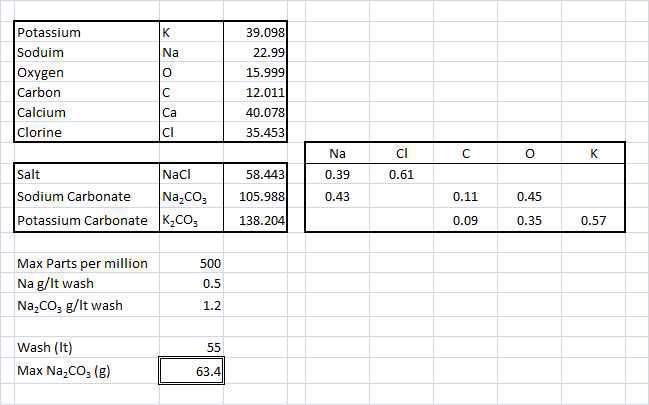

Again to support Dnderhead’s max Sodium content in a wash. Here is a bit of Organic Chemistry Calculations (If I have remembered it correctly from school See below) :egeek: . Working it out I should never have more than 1.2 g of Sodium Carbonate per litre to stay under the 500 parts per million recommended by White Labs. That results in 63.4g Max for my 55 litre wash.

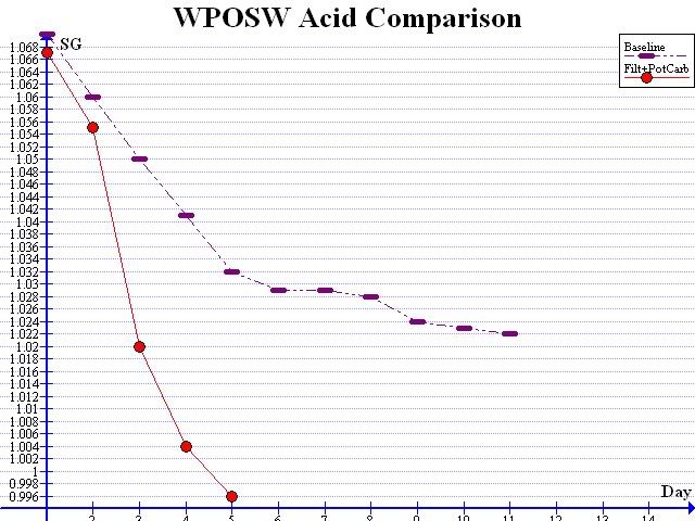

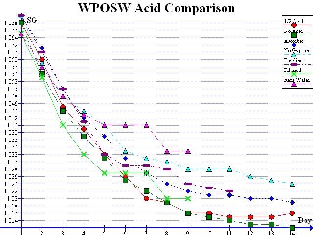

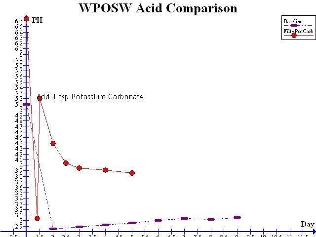

Another update. I won't catalog all of the runs but thought I would show a couple of graphs and a bit of explanation to show what I have encountered re: pH and WPOSW.
No question but that the addition of some sort of carbonate salt to adjust the pH was beneficial for me. My first run benefited from the sodium carbonate (and I might say that it smelled best). The calcium carbonate worked fine as far as bringing the pH up and presumably speeding up the fermentation, but it took a lot longer to clear than either the sodium or the potassium carbonate. The latter seems to have worked best. Mainly because it cleared faster than the calcium carbonate. I would say any of these salts would work at the concentrations I used. No sign that the use of the sodium salt inhibited the fermentation relative to the others.

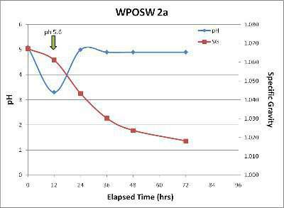

Here is a graph showing the pH versus specific gravity over time. At 12 hours I added the potassium carbonate which immediately raised the pH to 5.6, but by the next time point (12 hours later), the pH was down to 5.0 and from then on stayed at 4.9 without any additional potassium carbonate. Note, I did not use my hydrometer, but rather my "used" eBay Brix refractometer to estimate the s.g. during the fermentation. At the end of the run, I compared the Brix refractometer and the hydrometer and clearly the refractometer is "off" in the presence of the WPOSW recipe ingredient, but not by much. At least I can see how to interpret the "actual" s.g. from the graphs I have generated. Note, the graph shows a s.g of 1.017 (~4.4 Brix) at 72 hrs, but the hydrometer was less than 0.99 (-3 Brix).

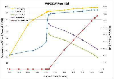

Here is a more complex (crowded...) graph of one of my stripping runs. I am showing as many parameter as I can, especially the refractometer (right out of the leibig) while the hydrometer is from the parrot (so is temporally behind the refractometer). Plus, I discovered the refractometer is consistently lower than the hydrometer after correcting for temperature. Anyway, I would appreciate hearing if my results look like what the rest of you see in your runs.

So I started 5 different washes, following the recipe exactly except to vary one ingredient per wash. The yeast was Superstart distillers. Basically the variations I tried are derived from what I've read in this thread and the main recipe thread in tried and true.
1) Baseline - exact recipe for all ingredients
2) 1/2 aitric acid - to start with a higher PH - someone mentioned in the main thread doing this allowed their wash to finish
3) No acid
4) Added a pinch of Ascorbic Acid - folks have mentioned doing this to neutralize chlorine in city water
5) No gypsum - I wanted to see if this helped / hurt the wash
In a later run (after I got some more fermenting buckets!) I also tried:
6) Filtered water - using an under sink rainfresh water filter with a VC-1 cartridge (1 Micron)
7) Rain Water - some folks have good luck with this
I tried to measure PH, SG and temp ever day. I did miss day 6 for 1-5 and days 6 and 7 for washes 6 and 7. The temps stayed right around 78-83 degrees so I didn't graph them as there wasn't much variation there. Here are my SG and PH results.
I didn't graph the end of the wash - just to the point where it looked like it was slowing down to an unacceptable level. My experience is that if I leave one of these washes for more than a month they will stall at around 1.010.
Notes:
1) This wash looses PH like super fast when it starts :shock: I wonder why that is? It must be responsible for stressing the yeast.
2) Starting with a higher PH definitely helps. I didn't notice any blue or ammonia smell in the wash with no acid.
3) Ascorbic acid didn't seem to help me in this case - it just reduced the PH a bit more which I don't need for this wash.
4) The wash without gypsum performed quite badly - so gypsum really helps! I was very surprised to see this...
5) Filtered water actually helped me gain a day right up front - very noticeable improvement. I use filtered water for all my washes, beer, wine now.
6) Our rain water is _crap_ :roll: scary what falls out of the sky around here... starting PH was so low - I guess that's why they call it acid rain...
So - using the info in this forum, I did another wash with:
- filtered water
- less that 1/2 tsp of Citric Acid
- adding 1 tsp of Potassium Carbonate after 10 hours.
Here are the graphs, with the baseline data incorporated for comparison:
Holy !@#$ :shock: - success!! Having this wash finish completely in 5 days is a record for me! Only problem is, I now have so much neutral I won't need to do another ferment until 2012 :D
Thanks to the folks who posted info on this wash - greatly appreciated!
