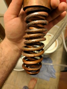

I'm reviving this thread because it describes exactly what I saw on my last few runs.
i noticed a little brown/Gray film begin to appear, just a tiny bit on the surface.
i separated it out to look closer it appear to be shiny or metallic.
so i wiped it off with a cloth and it appear black.
I have noticed this mostly since i began stripping with steam, especially when stripping with grains included.
I get strange black/brown sort of film, more like specks actually, floating on top of the distillate.
The sort of float around and if i disturb them the float back together and sort of reconnect into a floating debris field.
I leaves a blackish oily film at the level of the distillate when it comes over, which seems to be when the abv gets down to around 30% or 40%.
I thought this was just garbage coming over from the steamed grains, but on my last run I noticed a film inside my thumper plumbing that looked like liquid chrome.
When I gathered some on my finger it did look very shine and metallic and reflective. If I rubbed my fingers together it just turned to a black filmy smudge.
Has anyone ever run into this sort of thing? I've run the still many many times after cleaning runs, so I don't believe it's from any solder or flux.
My concern is that it could be something metallic getting into the works, either from my Corona mill, or my mash stirrer, which I believe is stainless, or even a brew pot.
I suppose it could even be from one of the kegs but they are both regular stainless kegs.
I only seem to get it when I steam distill on the grain, or less so when I steam distill filtered trub.
Sorry I didn't get any photos, next time I will post what I'm seeing.
For now I'm setting the likker aside, not drinking until I can get to the bottom of this.
Just wondering if anyone else has seen this specific effect.

Because it's floating on the top, it can't be a metal.
I know this from grain stripping runs. Especially corn. Looks like a metal, but between the fingers it's oily and black. I have this after the first half of stripping. At the end of the run the distillate often is more clean again.
After the run, when I clean everything, I see much of it in the riser and lyne arm.
- MichiganCornhusker
- Posts: 4527
Re: black/brown film ?
Thanks for the quick responses guys, it has settled my mind just a little.der wo wrote:Looks like a metal, but between the fingers it's oily and black.
Just like that, der wo, seeing it on my copper pipe it looked silvery, even on my fingers, but as soon as i wipe it or rub it, it just goes to an oily greasy blackish smear.
I've seen it before, but this time seeing it so much like chrome or silver it really threw me.
I've had it happen before with corn heavy recipes, but I think even more so with barley recipes. This one was about 65% barley, 30% rye. And 5% smoked grain.
I didn't get it at all when I stripped the racked clear ferment, but then I did that with my copper pot.

i think the ouzo effect is oils. lipids to be specific. I was having the same issue with dilution. 46% crystal clear, 45% cloudy...more it proofed down cloudier it got.
Swedish Pride hooked me up to a link that described lipids and the magic 46% number. the little buggers have a hydrophillic end and a hydrophobic end and they all get together and clump up at 46% and lower. higher ABV there is not enough water for the hydrophobic ones to try to get away from...it was just a couple weeks ago, i'll go find the link.
found it: http://homedistiller.org/forum/viewtopi ... 3#p7467963
look for swedish's post down a ways.
so long story short i tested everything i could think of and cleaned the snackers out of every goddamn thing...it still came through...in the HEADS
MCH what you describe sounds more like tail oil to me. shiny mica looking stuff floating on top. I always get it on strippers. The spirit run always cleans it up for me, except for a little comes through in deep tails on the second run.
multiple distillations cleaned it, (the ouzo effect) but that's a pain in the arse. strip/spirit should be enough. I was more careful on the ferment temps on the last few mashes and the lipids problem seems to be gone now (contra heads problem)...but i still get tons of tail oil through.(MCH's Problem)
what i get... that i have not quite figgered yet, is black dust in the bottom of the procap downcomers. It's pretty much like graphite, just dry dust but so fine it is slick. I think it's just really cooked grain from where the mash cooks down the steam jacket and cooks on the boiler wall. it gets quite a bit over 4 strippers, when i rip everything down and clean it for a spirit run.

Good information in that '.pdf''. Read it twice. It did not explain to my satisfaction however how the surface of an adsorption (not absorption) filter can cling to lipids under pressure. Searched for “chill filtration” and discovered many whisky links and conflicting opinions about the practice. Found a YouTube video showing some -chill filtration in progress in a small distillery and another where this German guy (some science PHD) built a little chill filtration unit using diatomatious earth as the filter. He just called it kieselguhr.HDNB wrote:
I figure my column was dark and slimy inside. Enough oils were getting through that water turned my spirit milky before the proof was lowered to 46%.
The still has been cleaned. After several days now the soda does seem to be slowly clarifying the milky looking spirit. At this point though it would make the most sense for me to simply 'chill filtrate' it some myself before one final cooking. I'll put it in a freezer overnight and later let it drip through a coffee filter while it is cold.

Look anything like this MCH?MichiganCornhusker wrote:I'm reviving this thread because it describes exactly what I saw on my last few runs.
... When I gathered some on my finger it did look very shine and metallic and reflective. If I rubbed my fingers together it just turned to a black filmy smudge.

Yes, rgreen2002, just like that, like liquid chrome, terminator juice.

I don't think it is a polymimetic alloy or anything....MichiganCornhusker wrote:Not sure how I lost track of this thread.
I've noticed it mainly after doing multiple runs of all grains. It looks silvery when it is dense on my finger but just oily when I spread it on a white paper. I assume it is related to the oily byproducts of grain distillation but I cannot be fully certain. I also steam mash as well which could possibly be related...but I don't know how....
The short of it.... just started noticing it.... not sure where it is from or what it is.
