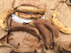

I browned the bananas on some wax paper in the sun during the day, then stored them in a brown paper bag at night. They smelled really good when going into the blender, but I think next time I'm going to wait even longer for more sugars to form up, so I can add less granulated.

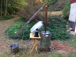

Well, I made it a long way today, but fell short of my goal, due to having to run the 5500 watt element at 110 instead of 220. Throwing 1375 watts at a keg doesn't get you very far...
It's a weekend of cleaning runs, first I fired up the keg with the 5' baseboard condenser: I thought it'd be a good idea to do it outside for the first run, just in case something weird happened. Everything worked out very well, except it goes sooooooooo slowly. I guess the point of the vinegar run is to have the innards bathed in vinegar vapor as long as possible, and I've definitely achieved that. I also realize how important reflectix could be for insulating it. It got really chilly this afternoon, which is probably creating some reflux of its own.
Then I fired up the stockpot with the 3' condenser, just to see if it was enough, and it was: It knocked down the ~1800 watts that I get out of the hotplate, so now I can run small experimental stuff while also running Big Bertha.

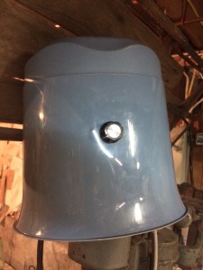

Of course, that requires having a controller box, right? Well, I didn't actually have a good *box*, and after digging through the house for half an hour or so, I ended up building it into a plastic wastebasket

Thanks, iCloud, here are the rest of the pictures...
The Control Bucket:
I'm seriously considering drawing a face on it for now.

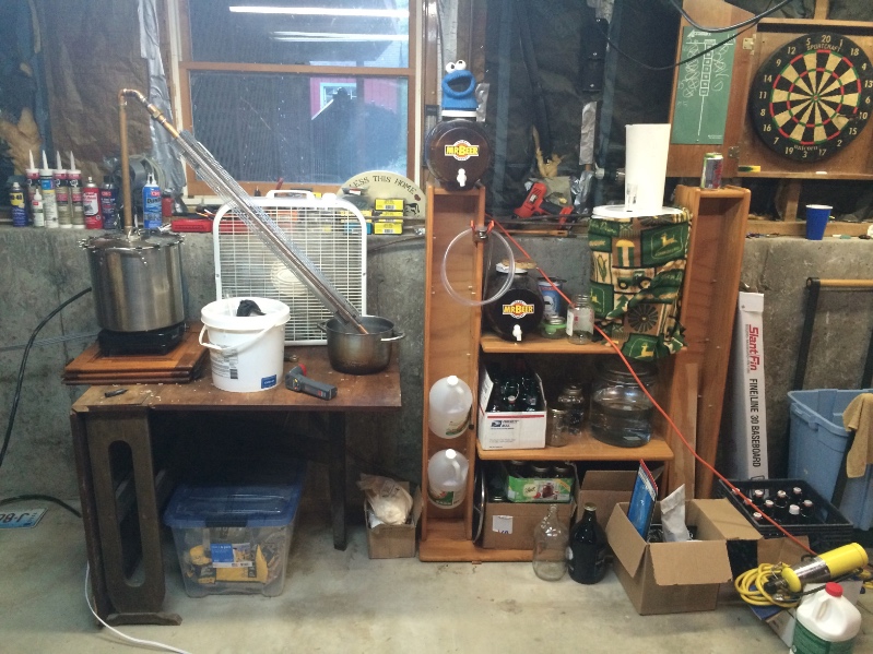

The inside: And a shot of my work area in the basement -- the plug for the keg is just to the left of this, as is the 32-gallon Brute that's currently holding the wash for tomorrow's sacrifice:
The Control Bucket:

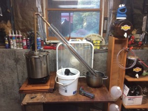

I finished up the cleaning runs today with the sac runs. The All Bran that I'd pitched on Tuesday, as I figured, was still up at ~1.018, but by the calc it was over 9% alcohol, and I also figured it didn't matter if there was still yeast flavoring in a sac run, so in it went.
I had run the keg boiler outside yesterday, and it took forever to get to drops, but inside today, even at only 1375 watts, it was like 3x faster. I guess the chilly air and cold breeze yesterday were refluxing the crap out of that poor vinegar. It was even pouring a thicker stream than the stockpot/hotplate still, which just goes to show you how much more efficient it is to have the element right in the liquid.
So, cleaning runs are done, the work on both stills passed inspection, and I'll be picking up the circuit breaker that I need tomorrow to get all 5500 watts so next weekend I can do it up Fo' Rizzle.
