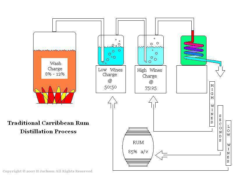

Postby Harry » Mon Feb 18, 2008 1:18 am
violentblue wrote:Do you think a thumper full of molasses wash be a good way to gain a little extra body in a rum?
Try this...

Postby violentblue » Mon Feb 18, 2008 8:19 am
building my still right now, what do we think of the mason jar thumper? I was planning to make everything out of copper, but have been thinking that glass might be nice for visual monitoring.
I've seen the diagram above before, considering the size of my pot, I'm not sure two thumpers would work (not enough steam to drive them both).
however if I ever decide to go into production, thats definatly the model to use.
