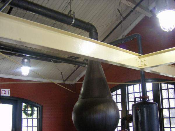

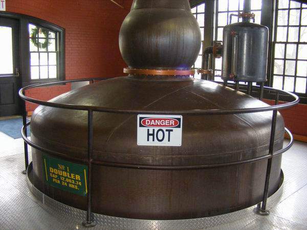

Four Rose's under the direction of Jim Rutledge has swung back the other way. Since their departure from Seagrams in 2004, they have gone back to the true Artisan method of doing things. One small stripping column and one small pot still with careful cuts sets them a cut above the others I have seen.
And their pot still isn't one of those fancy Carl stills either. It resembles a pot straight out of Scotland.

That looks like at least a 3000 gallon capacity. If this Vendome unit is any indication, I think large scale pot stills do use thumpers/vapour boxes, just look at this. Maybe this is a double thumper setup for rum distillation. Caption for this one says...."3000 and 5000 gallon pot still." The second picture is of a rectification collumn, like with plates, 92 ft long 13 1/2 feet across. How's that for capacity??!!! This thing could easily run 8-10 thousand gallons per day of finished product. Note lower left corner there's a dude standing there for comparison. This is proof (no pun intended) that commercial distillers are concerned with "quantity over quality," and that's why the clever home distiller and the small batch craft distiller can produce vastly superior product. I have to confess though, if I were going to run a legal distillery, this pot still arrangement is very attractive and the capacity is not so incredibly large that you can't control the quality.
