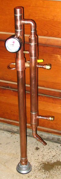

I know there are a few of these still heads out there and I wanted to share what I've done with mine to make it work much better. Granted, CMs aren't the greatest and they are a bit fiddly but I like fiddly (gives me something to do besides watch grass grow) and this style actually can be pretty versatile if you overlook its shortcomings and make a mod or two to it. Here are a couple stock pics of the still head being discussed:
I've been running this CM pretty much as a pot still with a copper scrubber-packed tower until recently. I had tried using the reflux coil with mixed results on the run before this last one then had an epiphany about the heat transfer from the reflux coil to the tower. I got out the mapp torch, heated up the reflux coil, hit it with some flux and soldered the coils to the tower. Much better. After incorporating Prairiepiss's mods (http://homedistiller.org/forum/viewtopi ... 17&t=25732) and reading Kiwistiller's thread about modding/operation of the Brew Shop CM (http://homedistiller.org/forum/viewtopi ... 17&t=11265) I took a crack at actually running the reflux coil to jack up the ABV.
Up until this time my highest acquired ABV was 72% with a fast heatup (propane, btw) and then back off to a slow broken stream. On this last run, once I started getting fores output I slowly opened the needle valve on the reflux coil and watched in amazement as the output from the parrot drain valve completely stopped. Remembering an earlier thread on equilibrium (http://homedistiller.org/forum/viewtopi ... 15&t=44263) I left it like that for fifteen minutes or so, closed the needle valve and took off about 200ml of fores then closed the parrot valve. The parrot filled and the alcometer hit 83%...a new best! (head slap :idea: ) Ok. Now I understand how this works. I'm sure on this next run I can do even better now that I've run this rig as it was intended. Next goal is clearing 90% on a BW wash. I can hardly wait! :thumbup:

Man, I love that boiler! I think it is shaped just right. Anyway, the setup is pretty cool. Can you get full reflux with that external coil at a high heat input?
I am trying to get my head around how a cm operates as I have been seeing more of them lately. I see the thermometer is above the reflux coils. If you are at 100% reflux no vapor would hit your thermometer. Do you have it there to monitor the vapor temp going past your coils? What if it were below the coils like a LM setup?

That's a good looking build. Might want to consider a flowmeter for your dephlegmater coil, it makes them easier to control. You set it to a certain flow instead of trying a setting and then seeing what it does, with a little driving time it makes it less fiddly. A cheap rotameter of 0-40 SCFH air would get you about 0-9 GPH, which should be in the ballpark for your setup.

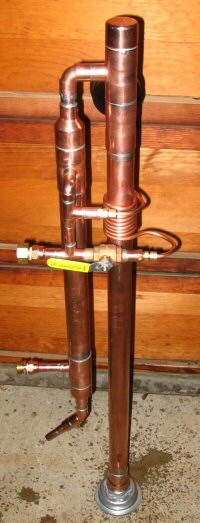

I had a couple of these from an old air compressor set up. I added a short piece of pipe on both sides maybe 1 1/2"long , cut my water hose and slid the hose on each side, add a couple of pipe clamps and it works perfectly for me to easily make fine adjustments to my condeser water flow.

Nice job mate, I've seen a few of this design modified now and they all seem to be working alot better!. I've found cm's the best to operate, bad designs are what have given cm's a bad name. When you first ever run one, it is fiddly and can be frustrating not knowing what your doing, but with study and playing with it it's pretty easy. I can now set mine and leave it and it will stay constant till tails comes on. It's always good to have separate flows to PC and rc, just to take away any inconsistencies with water heat up from PC to rc. the first few times i used quote, I had trouble getting the same run every time. But some.good.advice from.emptyglass fixed that. now I have coolant flow at max, take the heat up to it till the lymearm is to hot to touch just before the PC, back the heat down to a steady boil, just keep checking the heat on the lyme arm till fores start dropping out slowly, take fires then back the heat off till the drops stop. Let it sit of 5~10 mins then start closing the rc coolant valve till you get heads dropping slow, open it a but more to get a tinny stream then take.heads, when heads are done close the valve a touch more for a.steady stream then sit back.and take.hearts till the alc meter does a spaz and output goes erratic!. Take couple hundred ml s of tails. I don't use a thermo, never have, problem never will now lol.

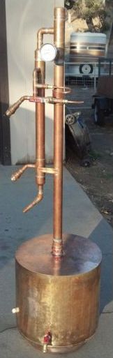

The boiler is the bottom end of an ancient water heater liner that I found at a friend's ranch. Cut it up with a Sawzall, bought an angle grinder and spent a considerable time and effort descaling the thing. The lid is a piece of the tank reverse rolled flat and cut to fit. Let me tell you this stuff is tough. The bottom skirt that gives the boiler a solid base to sit on is another piece of the liner cut and brazed to the bottom.
Sounds like a good idea. I was using a garden hose for the drain line but changed to a clear plastic so I can see the output flow from where I sit vs. going outside to look at what was coming out. That was a pain. Fixed now. Actually putting a number to the reflux coil flow would be good for repeatability.

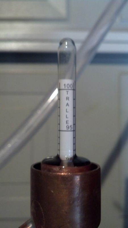

New personal best at 95% takeoff.
Ok. It's the heads after fores takeoff but the hearts are now coming off at 94% at 250ml every 8 minutes.

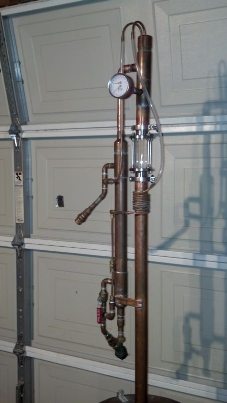

Not being a believer in "leaving well-enough alone", here's what it looks like today with a sight glass and coldfinger installed. :thumbup:
A reflux mod on a thumper? Sounds like it might just work as you intend, Cack. It would give you more versatility, that's for sure.
Remember, a packed column without reflux is just a pot still. You can pack the column, leave the reflux valve closed and run it as you're used to. Hmmm.

Not under any delusions that it's anything other than a pot still. The only purpose it will serve is a way to delay the vapor from going to the PC long enough to assure that the thumper is up to heat. It's all about trying to avoid as much smearing as possible. You might say it's a way of extending passive reflux a little longer.
I see the tubes going into the top for the cold finger, but where is the cold finger inside the column in relation to the vapor takeoff? I was always under the impression that the cooling in a CM took place below the vapor takeoff. The sight glass is a nice touch. Have you run it with these new changes yet?

The coldfinger is between the top of the sight glass and below the takeoff. It's 6" long x 1" in diameter. The column itself is 1.5".
Indeed I have run it with these changes and they definitely improved the way the still runs and the way I run the still. The sight glass allows me to see the level the distillate is in the column. If I keep it boiling in the sight glass itself, I know I'm running at optimum and not boiling over into the takeoff or running low giving me less purity than I could be getting. The coldfinger backs up the external reflux coil which isn't really that efficient and allows me to knock down that much more power.
Improvements that ultimately turned an originally poor design into a still that is efficient and fun to run.
