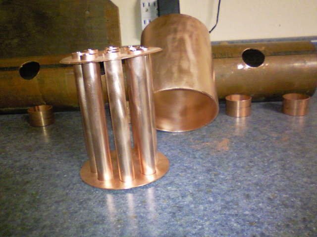

Re: PF's flute build

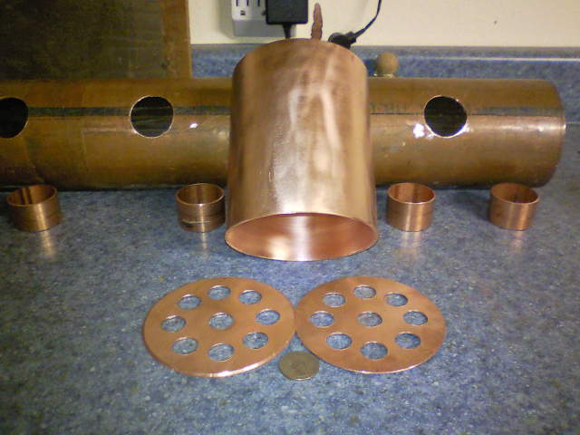

didnt get much done but here are some pics. The holes line up perfectly the camera is at a funny angle.

Interesting. Why do you have sight glasses on opposite sides of each plate? Are you going to have a lot of company to watch you distil and need more seating space? Back lighting? Slide show? Peep show? You have a bunch of holes to keep from leaking.
Are you going to shape your 1-1/5” with easy flanges than solder on to your four inch? You may do great but it is typically easier to shape and solder them on before drilling through with a whole saw.
I use trap adapters and even than they are a bitch to get everything to seal. I look forward to watching your build. Everybody has a different take on things and different skills to bring to bear.

no not a burn at all, I really like your build Its just I am nit picky as all **** when it comes to what I build. and I dont wanna have to take a single jack to something and beat it to death. I have already ruined 4 plates and found out that when you get angry and throw them across the garage they fly and embed themselves into your garage door like frisbees of death.

as for the glasses a mistake is what made me go for two 1.5". I was gonna do 1 sight glass each of two inch so I orderd what I thought was 10 2 inch tri clamps, they came and were 1.5 inch so I thought and decided I wanted a backlight/ see straight through. I am not to worried about leaks. I am going to make an easy flange with grounding wire and braze it on then cut a fish mouth as close as I can then solder to the column.

The end of a belt sander works well for shaping sight glass flanges to fit pipe.

I have been using a flapper wheel and the results are good but I think your right on with the belt sander with a real fine grit. I have made a few flanges for the sight glasses and dephlag using #6 grounding wire and I like it so far except that it when flattened it is a little too big for the 1.5 inch triclamps but the ever handy flapper wheel is here to save the day. I am going to solder up the dephlag tonight wish me luck.

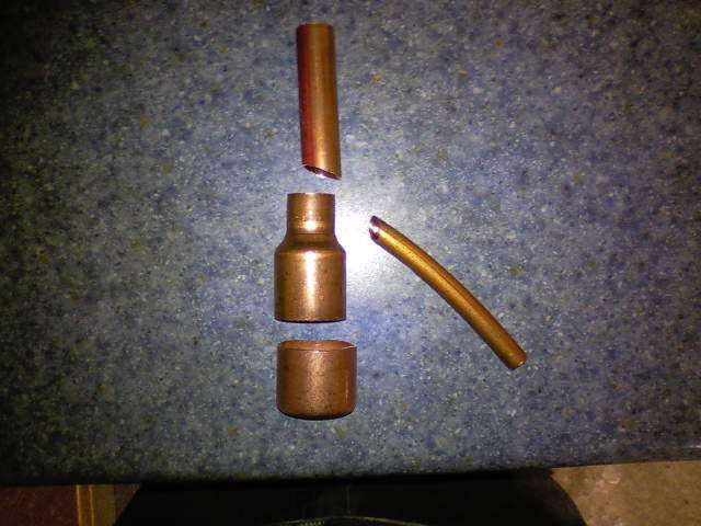

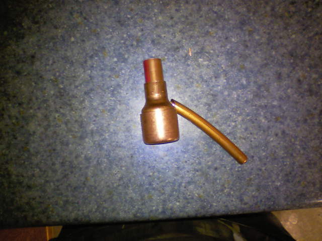

now you got me thinking, maybe like a bottle trap configuration with a spout going down right next to my plate tree rod. maybe a 3/4x1/2x1/2 tee with a 3/4 cap soldered on and the arm goes over and 90s down near the center or even on a 45 to slow decent.
- pfshine
- Posts: 3106
- Location: Vegas
I was looking at parts and pieces in the garage and was thinking that a 1x1/2 st reducer and a 1" cap with a 3/8 outlet to the center as a bottle trap would work great. I know I know reinventing the wheel. But I think it would work great, and with the advantage of another cap or more sieve holes if needed.
- pfshine
- Posts: 3106
- Location: Vegas
I have a mock up of what I want to do. This will sit right under the plate and gently put the reflux in the center of the plate below as to not disturb any bubble cap action going on while giving more room for another bubble cap below. here it is tell me what you guys think.
- Posts: 22
- Joined: Tue Nov 27, 2012 7:51 pm
Interesting idea PF but would an accurately placed J tube be easier and do the same thing?
Placing the bottom bend of the j tube so that it is touching the centre support would allow the returning distillate to run down the centre support minimizing disturbance. From what I've seen in all the other threads, the returning distillate coming from the down comer doesn't really shoot out but more or less over flows the j tube. allowing the distillate to run down the outside of the j tube to the lowest point of the tube before dropping to the next plate.
- Posts: 2228
A little complicated. Not sure you need the reducer. What about using a 45 degree fitting to direct liquid against your centering rod?

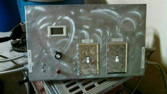

Well i finished my build almost. Controll panel cooling tower boiler and still are done. All i need to do is make some element guards. Now all i need to do is move pictures from my phone to computer and remove metadata so i can post pics.

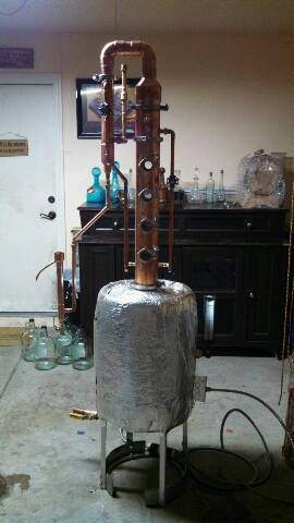

So i am doing my junkohol run and somthing of an idea struck me. I need to install a toilet in my garage. Other than that the run is great the third plate up is leaking down the sidewall slightly. Easy fix but i think its to efficient because its coming out dang near azeo.
- pfshine
- Posts: 3106
- Location: Vegas
Wow i love electric f propane. Now i can listen to music while i do a run without the roar of a burner and its faster and easier to controll. 25 mins for ten gal at 8% at 75 f to all plates loaded.
