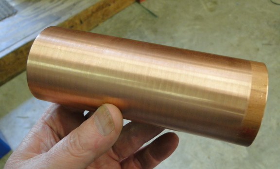

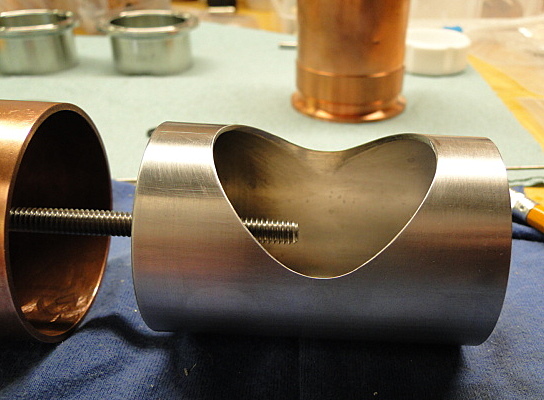

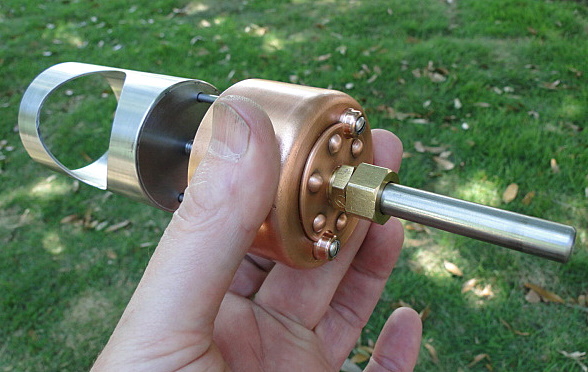

Next came the slide valve, made from a short piece of 304 SS tube (2" OD) and a SS disk soldered into one end. This required a huge boring on one side, and the end cap was drilled and tapped for the adjustment screw, a 1/4" X 20 stainless threaded shaft.
The shaft is installed into a Pb-free brass compression fitting installed into the end of a normal 2" copper cap. Two viton o-rings keep the shaft secured and sealed inside the compression fitting. I had huge grief trying to make a shaft and valve that was straight and true. This thing slides inside a 2" copper with hardly any room to spare, and things tend to bind up badly when everything isn't lined up perfectly.
The other issue is that the valve must not be allowed to rotate. If it does, it can theoretically seal off the vapor path to the boiler, and that equals big boom... In this state, as pictured, it CAN rotate. Had to fix that, and that was the hardest thing to do properly to this point.

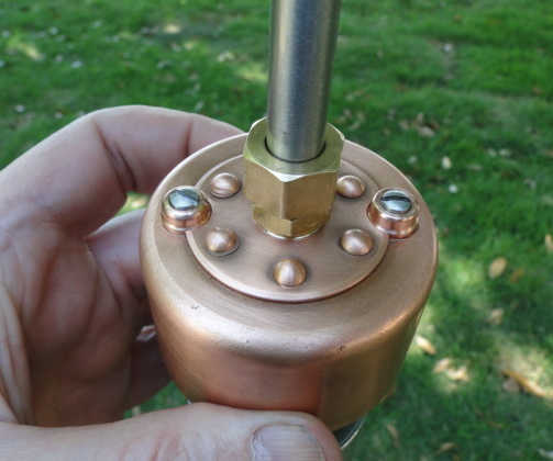

The solution was a pair of 1/8" stainless shafts that were secured on the same end as the main shaft itself. This does two things... it definitely prevents rotation, and it also forces the slide valve onto an accurate, linear path.
Inside the cap are a pair of small stainless slugs that accept a screw each from the outside, and support the two 1/8" rods. Two holes in the slide valve accept the shafts, and everything lines up nicely.

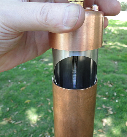

I added a temporary handle, and ran the valve back and forth to ensure all was OK. It'd be nice to have a big bronze or stainless handle, but this thing is going to get hot, so I'll either use this cheesy black plastic handle, or make something fancy from linen phenolic.
The final test was to install the entire assembly into a standard (type M) copper tube, and run it back and forth. In the end, I had to knock off about 0.008" from the slide valve diameter to make it work, but as it is now, it'll run full travel with no issues.

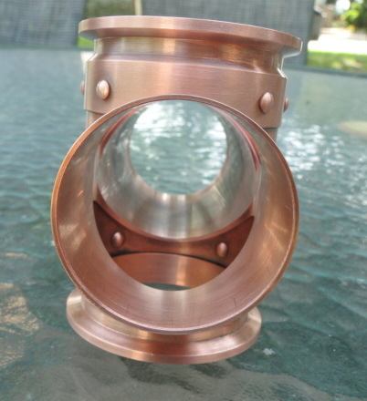

Knocked off a BIG (and a bit scary) hurdle today; successfully bored a 2" coupler straight through the side a full 2.125" for a regular 2" pipe to make the valve body. This procedure leaves only a thin web of metal to support itself during the cut.
Back earlier, I described the valve body... a short vertical section of coupler between 2 copper tri-clamp ferrules. Another piece of 2" goes straight through that for the stainless slide valve. Basically, a "tee" section. For the valve to work, everything's got to be plumb, square, all that jazz.
I decided to rivet the two ferrules to the coupler. This adds massive strength and rigidity. The ferrules and coupler were mounted in a dividing jig, and the rivet holes drilled 1/8".
The rivets were annealed. They go from inside out, and the pre-formed rivet head rests in a little formed anvil mounted on a big piece of steel round. Hand tools from the outside upset the rivet bodies, hold them in place, and then, after another annealing, another punch rounds them off. This next pic shows them after the first "upset" and then annealed. Got to round them yet. We'll see finished rivets later.
Now came the scary part for me, the big hole boring into the coupler. Most of us think copper pipe is round. To a machinist, it's not, it's grossly out of round, and to make this work properly, I took the section of 2" I'd need and skim cut it in a lathe, took off about 5 thousandths. This made it properly round for the next operation.

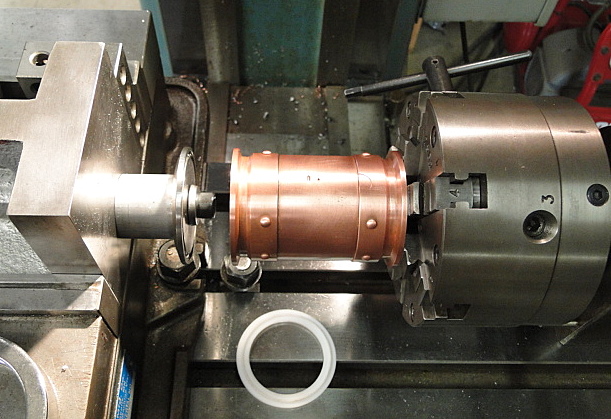

For this big cut, I needed a freakishly firm support that would also not compress the piece. Normally, you'd stick this in a big vise and have at it, but if I did that, it'd collapse as the cut neared completion. So I supported it on two ends. One end, the dividing head, the other, I bolted a regular 2" tri-clamp cap to a big angle iron. Shoved the whole thing together, then used a regular 2" clamp to hold it. Worked perfect.

Re: The MixMaster
I used a hole saw to start the hole, but no hole saw made will make the hole I needed to pull this off, so I used a boring head.
A boring head is a single point cutting tool that rotates and is adjustable for infinite diameter, so if you need a 1.772" hole, it'll do it. It's also nice in that I can work as slow as I need with light cuts.
Getting close... by this point, I'm going slow and measuring like a fool to make sure I don't go oversized. Piles of gooey copper swarf build up beneath the cut and inside the valve body.
Near the final diameter, about 1.120", I started to try the pipe. Finally took a cut where the pipe would "wring" in with some twisting. I'm not going to lie, did a little happy dance right there. This was a tough operation.
Note the shreds of ductile copper hanging off... the edge there is like a knife.
After some clean up, took her outside to cuddle and drink a nice beverage this evening. Couldn't be happier with how it turned out. This thing is probably gas tight right now with no solder at all.
Next step... the through-pipe is solid. I need to solder it in place before anything else, because I need to take that same boring tool and bore through the entire valve body top to bottom, so the slide valve can work. But this was a big hurdle. The remainder is pretty routine stuff.
I'm really liking having parts fit/hold together by themselves prior to soldering. It makes the solder op so much easier, and all we are doing with the solder is simply sealing it, rather than using solder to hold parts together.

I made some nice progress today; the head is about 70% done. The setup I used to bore that big hole cross-wise through the valve body worked so well, I decided to use it again to bore out the 2" cross-piece before soldering it in place. To reiterate, the little stubby piece sits vertically on a packed column. Above it is a reflux condenser, or a LM had AND a reflux condenser, if I want to do LM and pull fores or simply not do VM.
The vertical piece (I call it the valve body) accepts the 2" tube perfectly, but the 2" tube, when it's in there, needs to be open on the vertical as well as the horizontal path. Basically, I needed a true cross piece, open in four directions. I'll call the cross piece the slide tube, since the SS valve slides in there.
Step one - soldered yet another copper ferrule onto the slide tube. Love them ferrules, the wallet does not. But they sure are pretty. Very well made, too. Anyway, with a good fit, it didn't take much solder.
So, back onto the mill, I roughed out the slide tube with a hole saw. I was frankly shocked at how well a cheap hole saw cut through. While the cut was ragged and certainly not round, it went through without much fuss. This was a 1.875" hole... goal is a 2.000" hole.
The rigid setup rocked, it came out clean and nice. I clean up copper after machining or soldering in the kitchen sink with 400 wet-dry paper and scotch-brite + soap.
The moment of truth... the tube slid back in and formed a perfect 4-way junction, AND the slide valve still moved smooth as can be.
Re: The MixMaster
I designed the beast so that with the product condenser removed, if I unscrew the SS slide valve, it'll come right out the right side of the slide tube if I ever need to do maintenance.
One other thing I noticed, there is a good 1/2" of valve movement where there's no opening yet to the product condenser... you can see it in the first picture. I think I'm going to scallop out that area of stainless so the moment the slide valve enters the vapor path, it'll start to draw for VM.
All that remains... solder the control shaft cap onto the slide tube, solder up the valve body itself, give her a nice buff, and start plumbing for cooling water. Can't wait to give it a whirl.
I think for the first run or two, I'm going to do pure LM and get a feel for that part of it. If I don't understand LM, I certainly won't understand VM, and I don't want to flail away between the two modes, running the valve back and forth without a clue.
