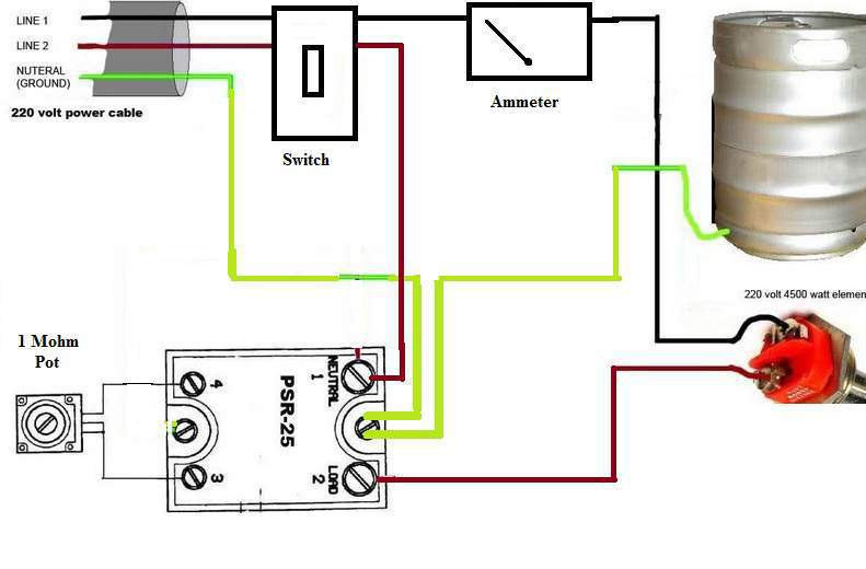

Thanks for the reply.
To make sure i understand this (and for any buddy else that doesn't) the SSR i listed above uses a voltage signal of 3-32 to control the SSR and to just use a POT to control i would have to get an SSR that is controlled via resistance signal.
Now just so i get this clear in my own head. In the "New Distillers Reading Lounge" under "phase angle control modules" in section "distilling with electric heat", MuleKicker you posted a setup using a an SSR controlled by a voltage signal. But if i understand correctly that is possible b/c you also used a "SSRman-1P Intelligent Phase Control Module" and transformer which i can presume is what controlled the rate of fire of the SSR via signal voltage and not resistance signal. And that the "SSRman-1P Intelligent Phase Control Module" is controlled via resistance signal.
I've read other threads where PID controllers where used in manual mode (or percentage mode) to control an SSR. Would the signal out of the PID controller not be voltage? Then may i presume that the SSR would also have to be voltage controlled?
Thanks, if i have that clear, i've just learned something new today. I will be sticking to the PSR style setup and will be ordering parts this week. I was hoping i could source them locally, but oh well, simplicity factor wins.

Correct. Some of these guys are just buying a standard 3-32V SSR and connecting it to a pot. This will not work, and I was basically saying, dont be fooled by the way the ssr looks, you have to read the specs for the way you are using it.
