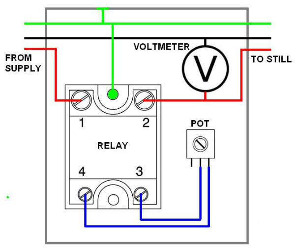

Postby Pyewacket » Mon Oct 01, 2012 1:57 pm
It has taken a while to read through this post. I have decided on Panda's SSR plan with the following purchased from uxcell:
a11052300ux0061 85L1 AC 0-250V Rectangle Analog Volt Panel Meter Gauge 1
a11062400ux0101 Solid State Relay SSR Voltage Resistance Regulator 40A 24-380V AC + Heat Sink 1
a11121400ux0233 Replacement 6mm Shaft Dia 470K Ohm 2W Pots Potentiometer w Knob 1
I would like to put a fan as part of this circuit. I found the following for 10bucks.
Dimensions: 80mm x 80mm x 25mm
Fan Speed: 2300-2700rpm
Air Flow: 24 CFM
Noise Level: 33 dBA
Bearing Type: sleeve Bearing
Rated Voltage: 220V AC
Power Consumption: 11 W
Power Connector: 2PIN
This appears to be an easy thing to do since it is a 220V fan. Would you folks recommend this? Is there a better/easier way? If this makes sense, where would you place it within Panda's schematic? Is there any other component that should be included to do this properly?
Thanks

Postby MuleKicker » Mon Oct 01, 2012 5:29 pm
I have built alot of PSR based controllers. I have a 4x4 aluminum heat sink with about 1.25" fins, open to the air. I have never used a fan on it, and havent needed to. I think it is overkill, unless you are going with a tiny heat sink stuffed up in a box with no air movement.

Postby WIski » Mon Oct 01, 2012 6:17 pm
PSR module and SSR Module are being used and confused within some of the element controller threads. Is there a difference?????

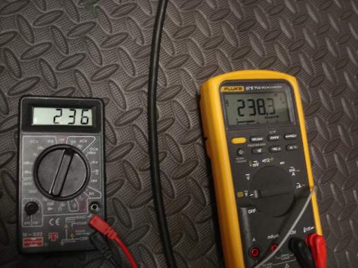

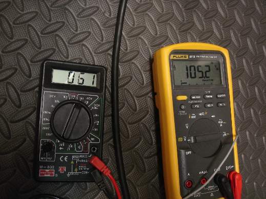

Postby sambedded » Mon Oct 01, 2012 8:33 pm
I believe that voltmeter will be pretty much useless . To get proper reading you need voltmeter marked as"True RMS"

Postby Pyewacket » Mon Oct 01, 2012 9:39 pm
Thanks Mule, I was going to mount it inside an old computer Power supply case, but I will just use an electric box...cut a hole and stick the fins outside of the box...er something to that effect. Sounds like I was making more difficult than it had to be.
Sambedded, heck you are probably right...I know very little about such things. I was just hoping for some basic way of knowing what sort of output I was pumping through the element. Just a visual cue so that I can get a basic setting of the dial...not a true measurement of voltage...

Postby sambedded » Mon Oct 01, 2012 10:08 pm
Let say you set full power - and voltmeter shows 220v. Everything is correct. Then you start decreasing power, turn you knob 10 degree, 20.. 30.. What the f.. It still shows you 220V ! You can probably think - my controller doesn't work, but no. This voltmeter will show you constantly 220 V on 100%-50% of power interval. And only when your heating element starts getting less than 50% of power - voltmeter reading start declining.

Postby rad14701 » Tue Oct 02, 2012 8:47 am
sambedded wrote:Let say you set full power - and voltmeter shows 220v. Everything is correct. Then you start decreasing power, turn you knob 10 degree, 20.. 30.. What the f.. It still shows you 220V ! You can probably think - my controller doesn't work, but no. This voltmeter will show you constantly 220 V on 100%-50% of power interval. And only when your heating element starts getting less than 50% of power - voltmeter reading start declining.
On every power controller I've ever built the voltmeter gives an accurate reading over the entire power range... Not sure where you got your information from but it surely doesn't match my real world findings... If you really want an accurate voltage reading you can connect it to the two power terminals on the element itself, but across anywhere in the output circuit should provide the same readings...

Postby sambedded » Wed Oct 03, 2012 1:03 am
rad14701 wrote:On every power controller I've ever built the voltmeter gives an accurate reading over the entire power range... Not sure where you got your information from but it surely doesn't match my real world findings... If you really want an accurate voltage reading you can connect it to the two power terminals on the element itself, but across anywhere in the output circuit should provide the same readings...
Sorry I din't provide enough details. little bit of theory. There are 3 basic methods of AC voltage measurement - Amplitude, Average and RMS (ROOT MEAN SQUARED).
Most of analog voltmeters uses Amplitude or average method. In case of sinus wave thee is linear dependency between all 3 values. Vrms=0.707Vamp, Vavrg = 0.637Vamp
If we talking about power the only Vrms gives us correct value to calculate it (P=Vrms*Vrms)/R). So all voltmeters (doesn't matter which method is used) calibrated to RMS for sinus wave. So all 3 types of voltmeters will show you accurate value.
But in case phase-angle controller we don't have a sinus wave. Scenario I described applicable for amplitude voltmeters. Most analog voltmeters either measured amplitude or average. If you are measuring average - it will behave differently. It will show you voltage change immediately as you start rotating your knob, but value will be inaccurate.
Today I created dangerous experimental setup (don't try it at your home :) ) to demonstrate a difference.
I connected 2 voltmeters to the load powered by phase angle controller. One voltmeter is chip one and measure average voltage, another one is True RMS.
On firs picture I set full power - sinus wave is un- cutted and both voltmeter shows almost the same voltage.
On second picture I significantly decrease a power and you can see a difference!

Postby rad14701 » Wed Oct 03, 2012 6:58 am
So, the moral of the story is don't use a cheap multimeter, which I never have... Thanks for documenting the quirk, sambedded... :thumbup:
Master Distiller
Posts: 20882
Re: Heating Element Control
Postby Pyewacket » Wed Oct 03, 2012 7:56 am
Thanks Rad and Samedded. I will use the cheapo above analog voltmeter for now...I will look for a better solution in the near future. If nothing else, it will tell me that the element is getting power. I am glad I know what I might expect. As you suggest Samedded, I am just the type of person to think everything is broken, that I did something horribly wrong, when I don't get the reading I expect. This probably saved me hours of pointless troubleshooting.
