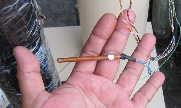

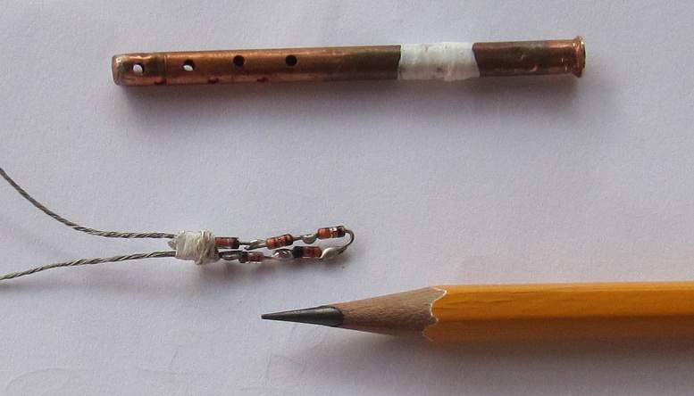

Temperature sensor:
I used 5 pieces of glass diodes (1N4148) wired in series. A diode’s forward voltage has a temperature coefficient of -2.1mv/˚C. What that means is that the diode’s forward voltage (typically 0.6v at room temp) DECREASES as the temperature is increased. Having 5 of these diodes in series gives me a temperature coefficient of -10.5mV/˚C. That is a big change in voltage and it makes the circuit very easy. And these diodes are very cheap. Plus, the glass package makes it ok for use in alcohol vapors.
After soldering, the diodes are wrapped with PTFE tape for insulation then placed inside a length of 5/32” copper tubing with one end sealed.

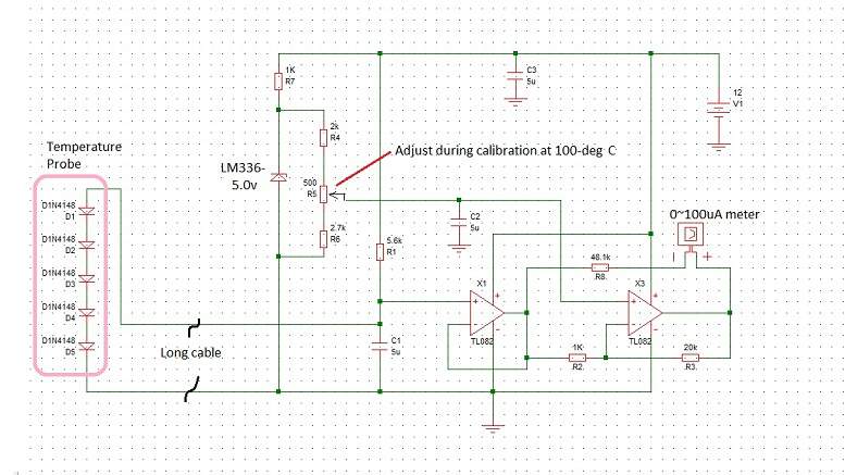

Voltage Reference:
I used LM336-5.0 voltage reference and as the name suggests it is 5.0v. This reference is VERY stable which means the thermometer will also be very stable. Once calibrated you can expect it to hold it’s calibration for more than a year. DO NOT use an ordinary zener diode in place of this reference because your readings will drift over time and ambient temperature change. Your thermometer is only as good as your reference.
Circuit Description:
The Temp sensor and voltage reference plus the trimming resistors form what is known as a “bridge” circuit. The op-amps (TL-082) serves to present a very high impedance to the bridge so as not to upset its balance. The diode sensor when forward biased will have a voltage drop of approximately 3v. The trimmer resistor is adjusted so that at 100˚C we get a full scale reading on the meter. The op-amp also provides gain, in this case 20x. The gain will multiply the tempco of the sensor to:
10.5mV/˚C x 20 = 210mV/˚C
And it is this voltage that we feed to the meter to get a reading.
Meter:
I am using a 0~100uA analog meter. It has an internal resistance of 1.9k ohms. (Do a search to see how you can measure the internal resistance of your meter). I wanted it to read from 75˚C to 100˚C because this is the range of temperature that is of interest to distilling. Above and below that temperature range is of no use to me so there’s no need to display it.
I will write on the meter’s dial “75....80....85...90...95....100” so I can read the temperature right off the scale on the dial. Since the sensor’s tempco has been gained by 20x we get 210mV/˚C. The difference between 75˚C and 100˚C is 25˚C. So that means the voltage across the meter will be 5.25v at full scale reading. To get 100uA (my meter) out of 5 volts means a resistance of
5v / 100uA = 50kΩ
Since my meter has an internal resistance of 1.9kΩ I need to put a
50kΩ - 1.9kkΩ = 48.1kΩ
Resistor in series with the meter. It can be seen on the schematic diagram. If you meter has a different internal resistance then you must compute for what series resistor you need to put in there so that the total resistance of the meter and series resistor is equal to 50kΩ.

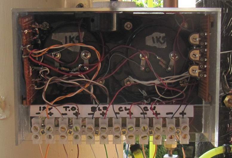

Rear view shows the rat's nest wiring. I did not bother to make it pretty.
Front view shows my meters, selector switch, gain switch, and coarse & fine adjustments for the 0.4-deg C full scale reflux thermometer. I still need to write on the meter's faces so it reads in deg C.

For sensing temperature near the take off valve I use bare diodes, no PTFE tape wrap, no copper housing. The tape is an insulator and it slows down the response time so I took it off. I staggered the location of the diodes relative to each other so there's no chance for the leads to touch each other inadvertently. The diodes are bathed in vapor all the time.Maritimer wrote: I've been looking at your thermometer, and I'm thinking of using it to measure vapour temperature. You say you wrapped it in PTFE tape. I use that tape on the joins in my column--I don't have tri-clamps, I just insert the sections of the column into couplings. The tape gets rather stringy and disintegrated, so I put a few turns of electrical tape over it. I'm wondering if you get the same effect, and if so, does vapour get to the diodes? I don't think vapour on the diodes would matter very much. They are forward-biased, so have low resistance and pure ethanol vapour has very low conductance (and probably water vapour, too). And even if a very high resistance is in parallel with the diode, its voltage wouldn't change much. Thoughts?
M
For temp sensors embedded in the column packing I needed to house the diodes in copper tube, PTFE tape for insulation, just enough tape to prevent shorts while inserting the diodes into the tube housing. Even so the response time is a lot slower. You might want to try filling the copper housing with cooking oil to aid in temperature conductivity.
Please add a 100nF capacitor across R3 in the schematic. This is needed otherwise the thermometer needle will be jittery. Haven't edited the schematic yet.
