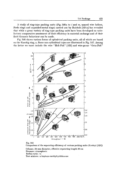

This is the first chart (1982) I would throw at anybody. It shows a sub 3 cm HETP for several designs of SPP. While tight packed SS Scrubbies come in at almost 12 cm HETP.
Pages from [Krell, Erich.]_Handbook of Laboratory Distillation With an Introductio...(BookFi.org)-2 r.jpg
While practical experience showed me it work well in a flooded state, I thank Odin for describing the flooded states and giving me understanding of it.
