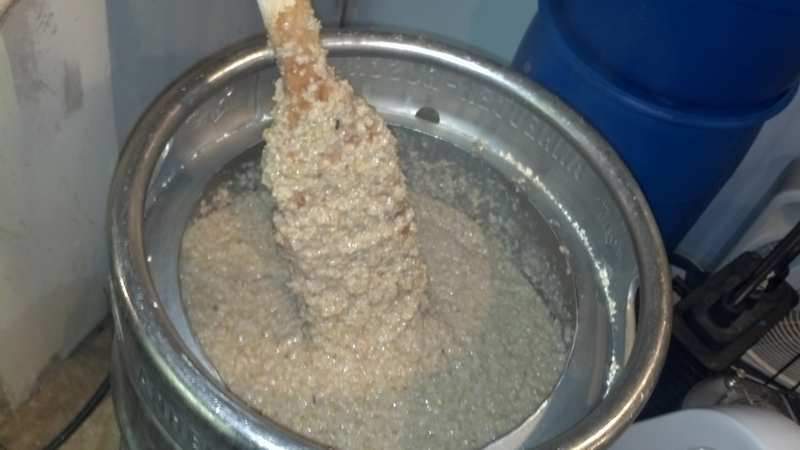

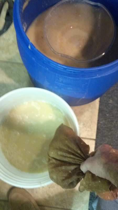

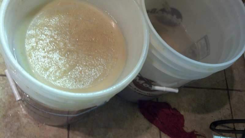

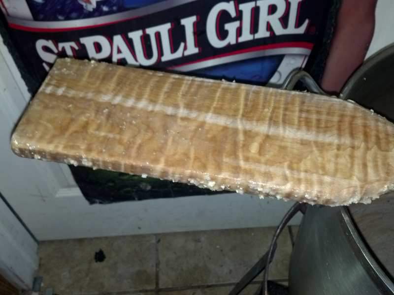

Alright lads, I made my flaked grain AG Barley mash this weekend. 15 lbs rolled steamed barley and 5 lbs 2 Row malt. (Avg DP 35.3)
I started by grinding the rolled barley a bit in my grain mill with the rollers scooted closer together than a typical malt grind. Barley came out nice, cracked it up some. Then boiled 15 lbs of this for 15 minutes in 10 gallons water, and let it steep with an insulator on the mash barrel, stirring occasionally, about 200 degrees. Hello oatmeal. Nice grain on my tiger striped maple mash paddle tho eh?
Pulled insulator off and stirred more often to drop temp to 151, dumped in 5 lbs malt and stirred for 5 minutes, it started to thin up pretty quick. I then wrapped a foil keg insulator blanket and a quilt around it and mashed it for 3 hours, stirring every 30 min. It started at 150 degrees and ended at 141.5 after 3 hours. I was hoping with the beautiful St Pauli Girl watching over things the mash would thin out a lot.
No such luck thinning out much, this crap would have nothing to do with sparging in my false bottom mash tun keg. Trying to sparge just gave me slippery slimy goo the consistency of motor oil in the winter.
So I said to hell with it and dumped the whole lot in a barrel, added 2 more gallons water, cooled it to pitch temp with my wort chiller and pitched a huge starter of US-05 (half gallon). We'll see what happens and hopefully I can get the result to strain through a mesh bag. I'll report back in a week. Wish me luck.

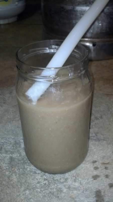

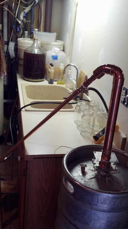

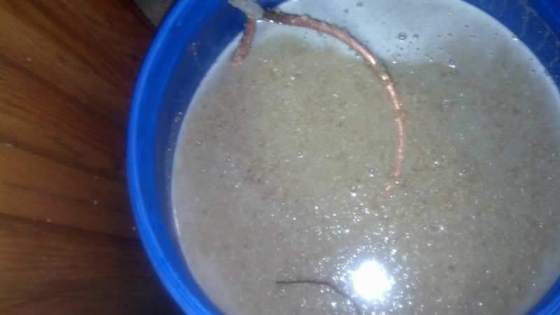

Ok, The barley AG is strained and cookin.... Of 15 lbs Rolled Barley, 5 lbs 2 row malt and 12 gallons water I strained and squeezed out 10.25 gallons of 1.002 for the boiler after a week fermenting.
After I strained and squeezed it through a mesh bag I poured it through a paint strainer that sits in the top of a bucket. Damn handy these things. All set up and cookin... Running, into the hearts now, tasting fine. I think Ill keep a quart of this on oak and cycle the rest as feints into the next batch. Cheers!

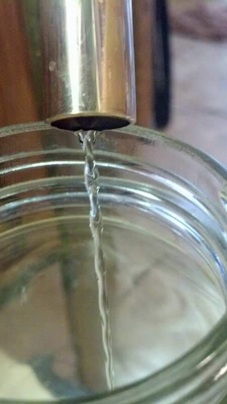

Awesome incognito! Im sitting here watching the tails run and sipping my quart of hearts LOL, its freakin good! Might not make it on oak for long LOL.
I agree on rye. From limited tasting, its just sharp with little flavor. I was hoping to see more spice like everyone writes about. Oh well. That Breukelen wheat is insane, you should try a bottle. I cant even tell you how good it is, its crazy.
From what youve said and what I tasted I might skip the rye. I have a shitton of rolled barley, cracked corn and 2 row to get through, then Ill pick up a bag of wheat malt. I gotta try and duplicate this Breuckelen 77 New York Wheat, its jsut too damn good. And only 222 days old, marked on the bottle, and the darkest whiskey in the bunch, crazy. Not sure how he pulled that off. Maybe stuffed the barrels with oak sticks too? haha,

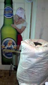

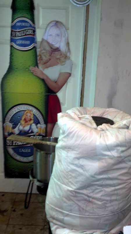

* I brought the 12 gallons water, gypsum and backset to a boil.
* Added the corn and stirred constantly until it returned to a boil. Then shut off the heat. Done for now, went upstairs to watch TV and have a beer, going downstairs every 30 min or so to stir the goo.
* After 3 hours I used a wort chiller to finish dropping the thick gelatinized corn to 149. Damn it smells good, like corn bread. Then I slowly added the 5 lbs malt, stirring constantly to avoid clumping.
*wrapped it up tight with a quilt blanket, and let it sit. It settled at 148. Done for tonight. Ill stir a couple times but then going to bed. Tomorrow morning Ill pitch the yeast.
