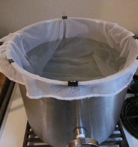

I've recently been doing a a version of NCHooch's NC Bourbon mash recipe using a BIAB mashing method with good results. (consistent 1.063-1.065). So, I thought I'd post some pics of the method for those who might be interested. I have an 8 gal brewpot/mashtun with false bottom screen that I used for this. The bag is a medium 20x24 grain bag I got from a brewstore for a few bucks. It fits perfectly for the 8 gal mashtun. The real advantage of the bag is mainly that it allows you to lift the grain bed, as well as squeeze the heck out of it.....(I knead the bag against the bottom of the mashtun screen). And, it offers the option of brewing on or off the grain. You can just lift the bag out and put it in your fermenter. OR, as I do...strain all the liquid off while it's warm, and then turn the bag inside out to dump the grains. The grains are fairly dry after a good wringing out, and just fall right out. It leaves the BOP near pristine..in need of just a good rinse (no more scrubbing!!!! yea
But, I think the biggest thing that made a difference for me in this recipe using this method...was the use of "flaked" corn over DIY ground dent corn/cracked corn. It doesn't require long cooking time, and it pretty much disintegrates everything but shell bits. This leaves a "lot" of liquid....I get back "most" of the liquid volume I start with! When I've cooked cracked corn for several hours (steep/cook) you lose quite a bit of water. Since the flaked corn has already been dispersed, it basically just turns to snot as soon as you get the water hot enough. I typically, bring it up to a boil, let it roll for about 10mins..that's it. Total cooking time.
So, Here's the run down on how I do NChooch's bourbon mash as BIAB:
Ingredients:
6 gal of filtered water (treated with 1 tablespoon 5.2 stabilizer, and 1/4 teaspoon gypsum)
8lbs of flaked corn/maize
3.5lbs of 6-row barley malt (1/2lb is for pre-malt)
1 teaspoon Alpha enzyme
1 teaspoon Gluco enzyme
1/2 teaspoon wyeast yeast nutrient
1 packet EC-1118 yeast
Procedure:
I start with my BOP — 8 gal brewkettle/mashtun with false bottom screen Place the brewbag in the pot, overlapping the top, and use binder clips to hold it in place and fill it with 6 gals of water Heat water to 165F and stir in the 8lbs of flaked corn and 1/2lb of the 6-row for pre-malt. This should come to rest somewhere around 150-155F. Keep stirring and bring it to a full boil. Boil for 10-15 mins..the pre-malt will keep it loose Turn off heat. Keep it covered to steep, and stir frequently. It will thicken up. When it gets to 150F, add the 3 lbs of 6-row and 1 teaspoon of alpha enzyme
Ingredients:
Procedure:

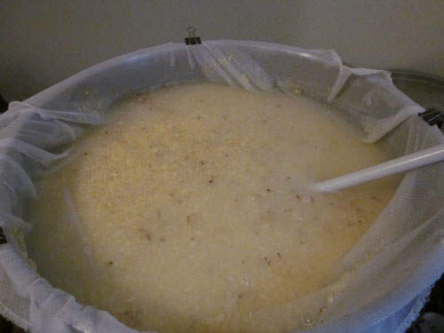

Re: BIAB (Brew In a Bag) Mashing
Stir every 15 mins until the temp drops below 140F. If your pot loses heat too fast...try wrapping in a blanket, or add more heat to keep it in the 140=150 range. This took about 3 hours for me. After it dropped below 140F, I let it sit covered for another hour. Then stuck in my wort chiller and cooled it down quickly to just under 100F. Your mash should be very liquid/watery and easy to stir. I kept stirring it to move it through the wort chiller coils.
Viola! The SG was 1.063 (last one was 1.065). This will strip out a good gallon or so of AG low-wines. You dont' "have" to use the enzymes...but I find that they add a point or two to the SG and seem to help things along. If you need more premalt...add 1/4 teaspoon of the alpha when you do the 1/2 lbs of barley. The yeast nutrient and aeration is mainly to help make a good, strong, healthy ferment. Anyway, this method has been working really well for me, the yields are way better than what I get with cracked corn, it doesn't take as long, and clean up is a snap compared to scrubbing out a BOP that corn has been cooking in for a full day. If you haven't already, give it a shot.
After it cooled to just under 100F, I drained the liquid off, took off the clips, and squeezed the bag good. I put in 6 gals (22.7L), I got back 21.5L of pure strained, corn/barley juice. I aerated it for 30mins with aquarium pump/stone, then pitched yeast, gluco enzyme and wyeast yeast nutrient. Let it sit for about 10mins, then stirred it all in.Viola! The SG was 1.063 (last one was 1.065). This will strip out a good gallon or so of AG low-wines. You dont' "have" to use the enzymes...but I find that they add a point or two to the SG and seem to help things along. If you need more premalt...add 1/4 teaspoon of the alpha when you do the 1/2 lbs of barley. The yeast nutrient and aeration is mainly to help make a good, strong, healthy ferment. Anyway, this method has been working really well for me, the yields are way better than what I get with cracked corn, it doesn't take as long, and clean up is a snap compared to scrubbing out a BOP that corn has been cooking in for a full day. If you haven't already, give it a shot.

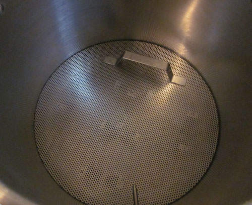

By the way I forgot to complement you on your very nice looking mash tun.
For larger mashes, I've been thinking about using a big cheap strainer to remove part of the solids before using the bag.
Ha! That's funny. I get a lot of use out of that mashtun/brewpot. I use it for beer as well. Wish I'd sprung for the 10 gal version instead of 8 though. At the time, the price difference was "huge". But, the 8 gal will "just" hold everything in this recipe (ie., 10lbs of grain, 6 gals of water) with the screen in the bottom. It will hold a bit more without the screen.
