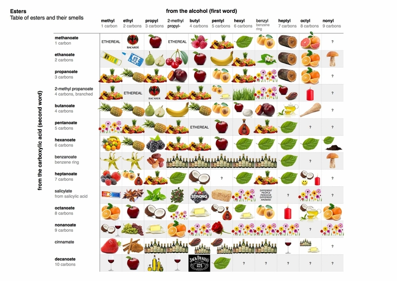

Not sure which forum is best for this, but considering most ester formation is done in fermentation I'm putting it here.
Taken from here:
https://jameskennedymonash.wordpress.co ... ir-smells/" onclick="window.open(this.href);return false;" rel="nofollow
Table of esters and their smells
