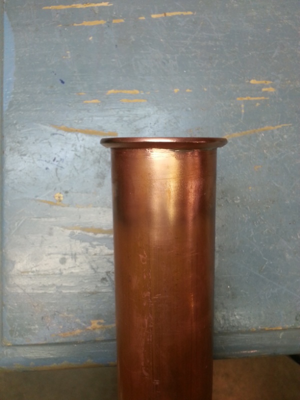

This method is super easy! And cost $1.69 (4 gauge copper grounding wire per foot)
Takes about 20-30 minutes :thumbup:

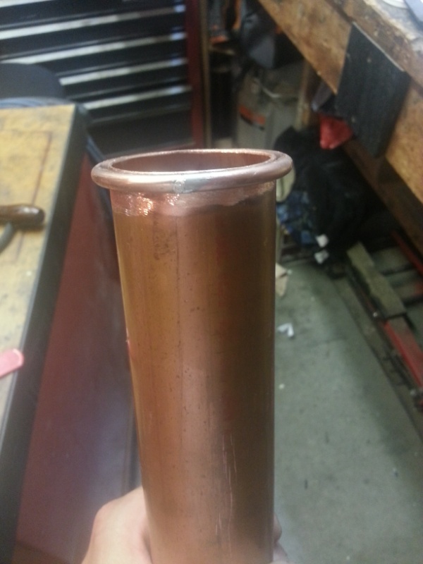

MoonWhisky i think ill go your way because that looks like when it completed there's a hella sense of achievement. But also buy from the link posted just to have a back up.
eck

Plus 1 moonwhiskey, so easy to do, and cheap!. It is satisfying woo tech, even if things go wrong, there's heaps of help.here, and even more satisfying when you nail it :D . Look, I.made this with my bare hands :D .

My whole column is made with 4 gauge copper wire ez flange fittings
The tip here is to wrap the wire around the pipe, mark the wire where the wire meets up. Use a hacksaw and cut on the mark. You now should have about a 1mm gap between the wire when it's on the pipe. This is OKAY! Use a "c" clamp to close the wire gap and solder the 4 gauge copper wire together. Now it won't fit on the pipe but that okay! Now file the inside of the wire with round file until it fits on the pipe (doing this also provides a better soldering joint) it shouldn't take much. Now that it fits file or grind the angle 20 degree angle on the wire before soldering on the pipe then solder it on the pipe. Lastly file or sand the bottom flat for a better seal.

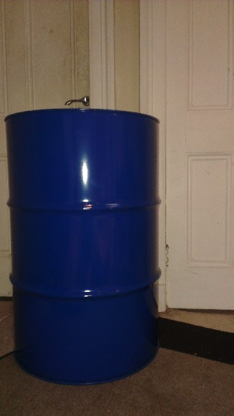

200l boiler. God only knows if it's plastic lined or not. Ether way it's making for a great boiler or at least fermentation device.

Im not worried about the flange. Just need to work out what the barrel is coated in. The cap was not a metal colour (i feel like an idiot saying that)... It was some bage colour coating. May need to cut a whole and scrub the whole thing clean.
What's peoples thoughts. It was originally used to contain 96% ethanol. should i be worried? Anybody have any experience with these cans. Looking to the semi pro/pro members or any one that can help.

Thanks for your input tap. but can I stress that I'm not worried about flanges. If I fail at doing it myself then I have two furrules coming in the mail with my clamp and gasket.. that I ordered.
What I'm most interested in/ worried about is the coating that may be in barrel that I have gots my self.
God I hope that someone has some know how.
Suppose it would do as an impressive fermentation device but I would really like to be able to quadruple my capacity of boiler without having to do lots of extra work... With out having to scrape it out that is. It's got a beautiful threaded top connection. Easy as, to just screw a column to with a new few parts that Id be able to buy.

With no one able to inspect the barrel, you're a bit on your own there, I'm afraid.
You should be able to detect any sort of lining. If the barrel is a proper stainless steel, a magnet won't stick, or it'll be very, very weak compared to regular steel. I can see in my mind how companies might ship industrial ethanol, and it might be regular carbon steel lined with some polymer, because it's so much cheaper than stainless. I hope that's not what you have!
If that's the case, it'd probably work great as a fermentation vessel, so it's not all bad. If it's stainless, there'd normally be no reason to add a coating inside.

yeh there defiantly is a lining of some kind :(
haven't been home since the beer festival and this is my first opportunity to post any images...
this is the barrel. when I get home tonight ill test with a magnet, post a photo of the lining and test the lining against fire/heat
