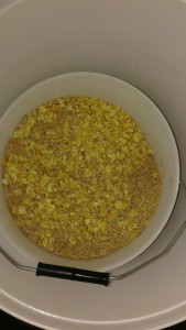

following on from my equipment upgrade New equipment, AG is my destination :). I'm on my way.
the recipe Ive put together on brewers friend is:
40l of fine Scottish water
7.5kg flaked corn
3kg rye
2kg 2row pale
with 500g of rice hulls
@100% brew efficiency it should work out at 10.06% abv
or
@ 75% brew efficiency it should work out at 7.55% abv
NChooch's Carolina Bourbon wrote:]BigR has a stepped corn cooking method that works really well (heat to 130F pause 30mins, heat to 165F, pause 30mins, heat to 200F, pause 30mins. Done.
following this method for the mashing of the corn.
*adjust temps as necessary for your own equipment.
all the corn in the tub. add 22.5l @60°C
mash @54°C
drain off as much as possible in my case +-10l add 10l and bring to 76°C
mash @74°C
drain off 17.5l add 4.5l bring to ??°C
mash @93°C
add 3l of cold water
then bang in the barley @64°C and the rye @60°C.
ill be adding in Amylase in the grand hope for 100% brew efficiency.
going to leave it over night to let the grain fizzle out and add yeast in the morning.
*note* i skipped the 93°C mash because of work commitments. fucking work :evil: lesson learned don't start if you don't have an excess of free time. going to let the corn soak for 24h
will update as i progress
eck

You should be good skipping the 93*C step, as your flaked corn has already been cooked.
Are you draining off due to your brewing vessel size? It seems you're losing some of the corn's starches for the conversion doing so. I'd suggest using a larger vessel. *Edit- Are you heating what you drained and adding that back or replacing what you drained hot water?
All in all, you should still end up with a good product. Perhaps just a lower SG then calculated. Speaking of SG, be sure to record yours, I'd like to know how this turns out with this method. Thanks for sharing.

the steep and drain is because i only have enough capacity to boil about 25l at a time and the end goal is 40l the vessel is 60l.
every thing that comes out of the tun goes back in.
wish i had thought about it being flaked yesterday would have saved me some time :?

Here's a chart for whole grain gel temp, flaked just needs 160-170*f to gel and bring down to mash temp.

Wootec yea that method takes a long time and heating on grains you run a risk of scorch. Give this a read, it does the same thing with zeor chance of scorch and lots easier. http://homedistiller.org/forum/viewtopi ... 14&t=48126
WooTeck
Posts: 1775
Joined: Thu Apr 24, 2014 1:37 am
Location: scotland
Re: on the road to AG
Post by WooTeck »
frunobulax wrote:You should shoot for 70% efficiency, and if the OG is too high, you can water it down and just have more product. Once you get your process dialed in you'll know what to expect each time you use different grains. 100% eff. is grandiose and impossible to hit.
I do realise that’s its a ridiculous hope but I figure if it works out lower then the yeasties wont get stressed in the same way as if it was the other way around. 7% would do fine :).
SoMo wrote:Here's a chart for whole grain gel temp, flaked just needs 160-170*f to gel and bring down to mash temp.
Ive been using this one.
halfbaked wrote:Wootec yea that method takes a long time and heating on grains you run a risk of scorch. Give this a read, it does the same thing with zeor chance of scorch and lots easier. http://homedistiller.org/forum/viewtopi ... 14&t=48126
Ive skim read that in the past. that’s kind of the method I went for in the end left it wrapped through out the night and for the foreseeable next 3 hours. Going to get the rye and barley in after work. ill reiterate a point from earlier... fucking work :evil:
