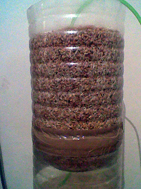

I use this for malting. There are 2 PET bottles of 10 liters one over the other. The upper one has a perforated bottom and the air is pumped with a 2W aquarium pump. It sprouts very nice and uniform.

I don't know if anyone else is interested, but how is this setup? i would like to try rye whisky and malting.Rachiu wrote:I use this for malting. There are 2 PET bottles of 10 liters one over the other. The upper one has a perforated bottom and the air is pumped with a 2W aquarium pump. It sprouts very nice and uniform.
Re: Malting your own rye
This is the scheme of the germinator
Never seen anything like that before, I am interested. How do you dry the malt Rachiu?
I don't dry it , I use it "green"... green malt. There are some reasons for using it fresh, not just commodity.
I grind the sprouted grain with meat grinder and turn it into a paste. I add the paste to a decoction at certain temperatures for liquefaction and saccharification. I keep a small amount of malt paste to add with yeast. The green malt is richer in gluco-amylase than dry malt because some of the enzyme is denatured during drying. The green wheat malt is more rich in gluco-amylase.
The gluco-amylase brakes the maltose giving glucose and ease the work of yeast.

Thanks for the pictures. I'm thinking I could try that malting set up with a couple of old 5 gallon polycarbonate water bottles. Polycarbonate is perhaps not the ideal material but they are big and available for free.

Awesome. Thanks for that. Looks like a simple solution for malting rye at home.Rachiu wrote:This is the scheme of the germinator
Your idea is great. I will use the polycarbonate bottles too. I think there is very little contact with plastic and no BPA could leach. I advise to seal somehow the bottles (maybe silicone) and the air will not escape through the gap between bottles. It must be forced to pass through the grain layer.
I think, with the 5 gallon bottles you will sprout up to 8 kg grains. It's pretty hard to take out the sprouted grains. They will hook together, but works well with a fork
How do you grind the green malt? With my meat grinder is terribly hard and slow. I search for a better idea.
If you wash it often it will not mold/rot. I made a sprinkle from a bottle, puncturing the lid wit a hot needle. I wet the grains multiple times per day. Tap water has some chlorine in it. Sprouted grains are very fresh and tasty and no strange or bad smell will form.
I have a cold climate here in winters but the temp rises quite well in summers (up to 38-40*C). In winter, the temperature drops below -20 degrees celsius. In my house is about 4*C (40*F) but the sprouting works well because some heat is built up during germination. You can feel the heat if you touch the bottle. I think the heat is proportional with amount of grains, like the fermentation does. I don't know what happens at higher temperatures, my house never exceeds 24*C (75*F) in summer because is a basement and is cooler in summers but warmer in winters.
In winter I need to help the rising temperature of the fermentation bath putting some light bulbs under the tank, putting some fire bricks around it and cover with something thermo-insulating material, even blankets or coats. Thus, the fermentation bath stays around 20*C. Otherwise the fermentation stops due to low temperature.
" If you wash it often it will not mold/rot'
thats going to be a bit hard when its in a bottle.
You have to cut the top of the bottle as I do.
Otherwise you will never get the stacked grains within the bottle. They hook very tight all together.
Anyway, I think is far much better idea than making malting floors in our narrow apartments.
I also think this can be used as malting floor. But putting some gauze on the shelfs
