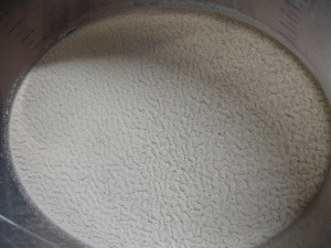

The second mash:
Here a picture from the pit the day before mashing: The goal was to get the acids from the infected backset, but to kill the bacterias. To kill the bacterias but not to kill the enzymes. With a two water mashing this is very easy:
I used water for the first water and backset for the second water.
The first water only 60°C (before mashing in). This low temp saves the enzymes. They will work during fermentation and lead to a low FG.
The backset (second water) was brought to a boil before mashing in the malt again. This high temp kills the infection (but the already produced acids will form esters with the alcohol) and gets much sugar out of the malted barley. After cooled down to 55°C or lower I poured it to the first water. To keep the pH up I used calcium hydroxide and carbonate.
Unfortunately after stripping the result is not so much different to the low wines of the uninfected mash. The first fraction was very interesting fruity, but all in all it's not much. Probably many of the esters were driven out by the CO² during the fermentation. It's no real surprise for me. I had a similar result with my infected wheated Bourbon. But I wanted to verify it here.

With the infected backset and the spent grains I did a sugarhead. I boiled it shortly to kill the bacterias, poured it onto sugar for about 10% alcohol and some calcium carbonate, let it cool down and pitched bakers yeast. Fermentation started a bit slow, but finally it worked well. It developed soon a very surprising banana and tropical fruits flavor. At the end of the fermentation one day before stripping I added the feints of the Malt Whisky to the wash. This pushed the banana flavor. The peat flavor is less than with my original Malt Whisky, probably much of the peat is distilled over or driven out of the airlock. This helps identifying the fruit flavors.
Because of the feints the abv in the boiler was high (16%) and I collected per 10l wash 4.2l low wines at 38%.
Then I added per 10l low wines 3.1l filtered infected backset, which I had seperated from the backset, which I boiled and fermented.
So the abv in the boiler was 29% for the spirit run. It was not needed to cut more fores than usual and also tails started late. I don't know why I got more hearts than usual.
Here a pic of the now 3 months old infection: Conclusion:
I think I did a good work for a Rum backset pit... The tropical fruits flavor and the comparision with my "Infected Wheated Bourbon" -project tells me, that I had many butyric but not much lactic acids esters probably. For Whisky the flavors of the lactic esters would be more typical I think. So perhaps after aging I have peated Rum...
