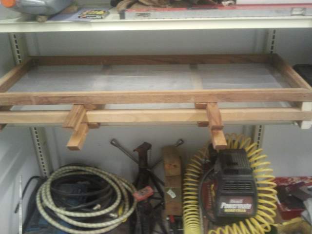

These are a couple of my trays. I malt and dry in them as I mostly dry in the smoker.
In the summer I dry outside on a rack in the sun for a day or two then into the smoker. Our humidity here is very low. We are located right where the high desert meets the mountains. In the winter I put them directly in line of the shop heater again for a couple of days then smoker. Trays are made from cull 2x2s from the local lumber yard and screen. Trays are 2x4 ft. Works great and can fit 100 lbs in the smoker at a time. 10 lbs per tray so the bed is thin.
