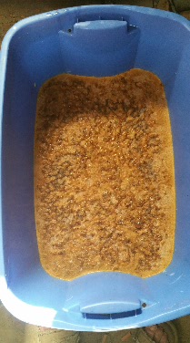

Well that was a fast ferment! I'll put it in the open 55 gal fermenter and make another 15 or so gal wash and let her rip. Once I have the 55 gal full I'll see if there was any type of infection starting.
I may run this one just to start the dunder pit, I have some malted barley and wheat ( red and white ) I might try and start a lacto with one and see what happens. I still have a lot of learning to do before I can isolate and keep certain strains but hey I'm here to learn. Even if it be by trial and error. Lol
I'll still have some rum and dunder to play with, if nothing else I can get drunk while fukn something up.
