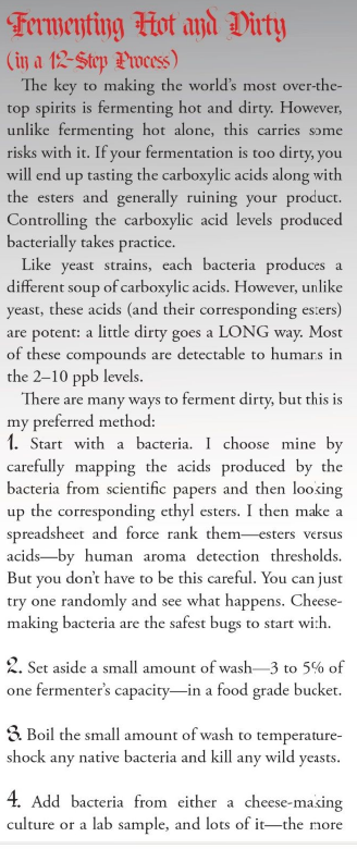

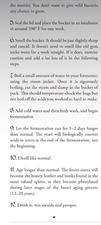

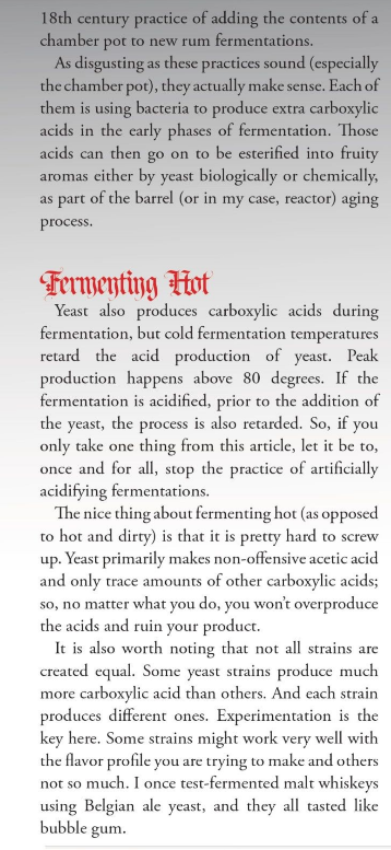

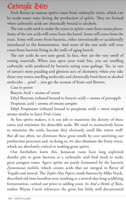

Re: Feed grade molly and brown sugar wash
Cool ref chris! That article was a good read, for the zymomonas mobilis / tequila reference if nothing else. Fully off topic here I guess, but I wonder if its a missing link in agave syrup attempts?
Shine, couple on topic things I learned. He says, practically screams, stop acidifying washes pre-fermentation as yeast produce more carboxylic acids without "artificially" acidifying wash. He says its the one thing to take from the article if nothing else. Very interesting.
Actually, lemme just try to post the article...
Here it is, minus a couple pull quotes and layout, but legible.
It's not just yeast that produces carboxylic acids at higher pHs, 5-5.8 favors bacteria as well as yeast. I've never tried to maintain the pH that high for a whole ferment, but I'll give it a try, at least for the first ferment of this series.
