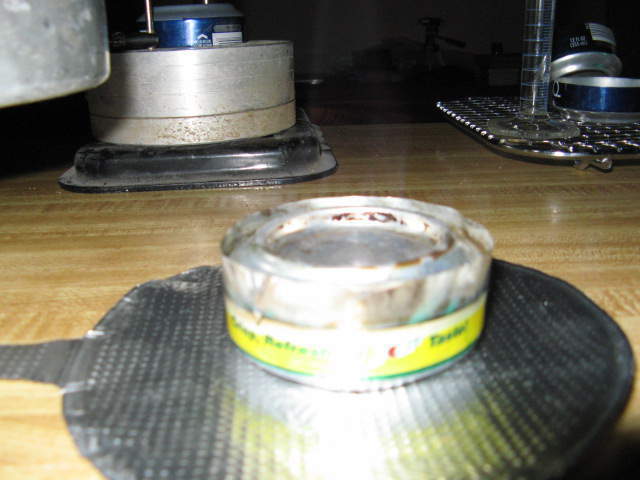

alcahol stove made from 2 pop cans weighs about .6 of an oz. boils 2 cups of water in 6.5 min. with 25 ml. high strength alcahol. can be made with a leatherman in 10 min. more refined builds yield better results. search; pop can stove, pepsi can stove, penny stove, or zen stove, the zen stove site is the hd of pop can stove sites. a safety note. the stove IS lit in both photos. cob

Don't get me going with my vast collection of alcohol stoves... One of my other addictions... Yet another hobby that gets you looking at every small container and wondering if it can be used in one way or another... Every aluminum bottle or can becomes an item of intrigue...

Must go hand in hand, I too have a few stoves from aluminum bud lite bottles and a few Pepsi can stoves with wire mesh supports. Was even thinking about getting a Petromax Alcohol lantern, foreshots should burn nicely in that.

i was aware that posting pictures of a tinkerers delight like this was akin to throwing skittles on the floor in a kindergarden, but i could'nt help it. cheap, efficient, a little dangerous, fun, and puts my $80 whisperlite to shame in many respects. cob

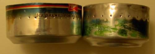

My latest one can design with a rolled top edge seal in both 12 and 24 ounce sizes... Pot stand optional due to the side jet design...

looks good. i haven't gotten past pressure stoves yet. the one in the picture and it's stats are my first build 20 #70 jets, modified penny design, haven't yet made one that equals the first, going to try to clone it soon. the up side is that a massive collection will fit in a shoe box or two. the truth is i havn't done any backpacking in years let alone ultralite back packing. i heard myself tell someone recently "the best backpack i ever bought had a 460 and a shower" . that one last brain cell still needs exercise. cob

Hey, piratesteve, I have several designs here that I use... Most of them are self-pressurizing and boil 2 cups of water in under 5 minutes on less than a shot (1oz/30ml) of alcohol... Several of the designs I have can be found on YouTube by searching for "alcohol stove" or "pop can stove" along with building instructions... Another addictive hobby...
The design above is one that I created last summer... I think it unofficially won "stove of the month" on one of the hiking sites back in June 2009... I say unofficially only because all other potential entries were withdrawn...

Ok... Here is the rest of the collection, aside from a few experimentals I have packed away... The ones in the photo above are kept in the van at all times so they aren't in the photo... Gonna try making one out of the aluminum bottles whenever I get the time and have the ambition to do so...

rad14701 wrote:Ok... Here is the rest of the collection, aside from a few experimentals I have packed away... The ones in the photo above are kept in the van at all times so they aren't in the photo... Gonna try making one out of the aluminum bottles whenever I get the time and have the ambition to do so...
Absolutely Brilliant rad!
Although I'm starting to think you have too much spare time on your hands!
