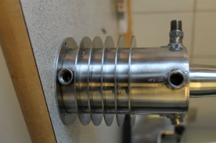

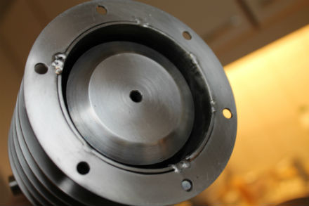

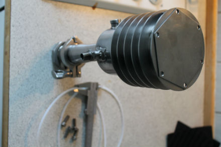

Still waiting for parts etc. for my "proportional splitterhead", i had a few hours in the workshop.
So i decided to make a project come true i have been thinking on for a long time now.
The goal was:
A compact stillhead, that uses a minimum of water and could run without a pump.
Further it should be suitable for running both..a hard strippingrun on full power and a spiritrun.
The basic idea is the compact potstill head.
As i read in here i stumbled on a older post, that gave me inspiration for it: http://homedistiller.org/forum/viewtopi ... =16&t=8046
A few improvements had to be made.
First i wanted two outlets, to prevent smearing. One of them would act as a drain and can be operated with a 1/4" ballvalve.
Next...i could under no circumstances have a enclosed spiritchamber, i would have to be with a possible vent to atmosphere.
That's why you see a piece of flourdough on top of it on the video.
It will be sealed off with a thermoprobe and some PTFE tape. Should a situation occur and the chamber pressurises, it would simply blow the probe out.
Function is as follows: The vapor rises from the boiler through the "riser" and into the spiritchamber.
The chamber is surrounded by water (holds 250 ML) and product condensates on the sidewalls.
Now, foreshots would run to the bottom and can be discarded by opening the small ballvalve on the side.
The takeoff is flush with the bottom, so it will drain the whole chamber.
The valve is then closed and as the still comes to operating temperature, the spiritchamber starts to fill with product.
Cause the chamber is surrounded by water, the spirits will cool to a acceptable temperature before leaving the still, hence my small Liebig.
Eventually it reaches the takeoff point 20 mm from the bottom and up, and overflows to a copperpipe.
The video shows also my little mini Liebig i build for this project. http://homedistiller.org/forum/viewtopi ... 87&t=54834
The 12 mm pipe on it, would not be sufficient if i had to deal with vapor, as in a VM...but as "aftercooler"...it is...well..cool.. :mrgreen:
I had a lack of silicone hose, so it's not operational. I also forgot to make a little driplip...so i used a stainless bolt as a "racoon pecker"... :lol:
As you see, my pump is unplugged...the whole thing runs purely on the capillar effect..you han hear it in the video.
Height: 260 mm
Condenserhead 76 mm, holds 250 ML water
All connections are 1/4"
VIDEO of the testrun: http://1drv.ms/1BfEpJG" onclick="window.open(this.href);return false;" rel="nofollow

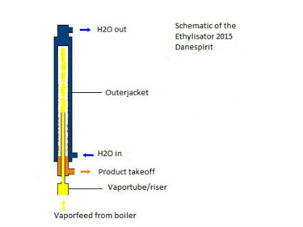

The inside of it looks as on this drawing:
Boiler supplies the stillhead with vapor, that rises all through the inner tube.
It condenses on the walls of the cold outerjacket and falls back down to the bottom.
The inner tube has a "roof" over it, to prevent the distillate to run straight into the tube again (i might have spared that part).
Basically it's a bit like RAD's concentric...
The drawing shows only one takeoff, mine has two.
The first is flush with the bottom and has a 1/4" ballvalve attached.
Before the still comes to operational temperature, the foreshots will already condense inside.
I drain them with the ballvalve, close it again and let it come to temperature.
The second takeoff is a good 20 mm higher upwards, so there will be a pool of distillate that cools in the spiritchamber before exiting.
My mini Liebig will take care of further cooling, as the distillate comes of a bit warm for my liking. ( around 40 C).
I don't run full power in the video i made. I guess i could run it a little harder in a strippingrun.
