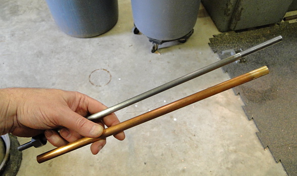

The tubes (7 of them) are 14" long. Outer diameter is 1/2", inner diameter ~ 0.430", i.e. a hard-drawn 3/8" pipe. To start, the ends were annealed and quenched.
I prepared a fixture from mild steel rod. I threaded the rod, but a 3/8" all-thread rod would work as well for what I did. I threaded two special nuts to fit on the rod, one a base, the other, a flare tool.
The base nut was clamped in a vise, and the flare nut was firmed up and turned a single turn so as to flare the Cu tube. This was repeated for all the tubes, plus a spare.

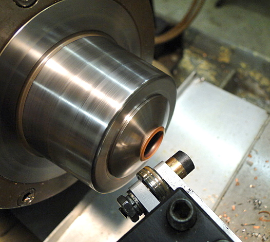

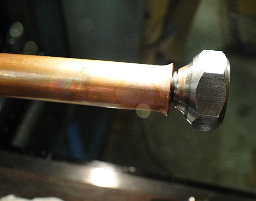

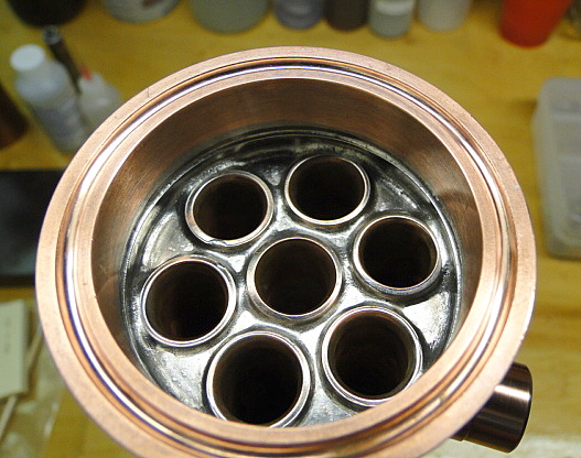

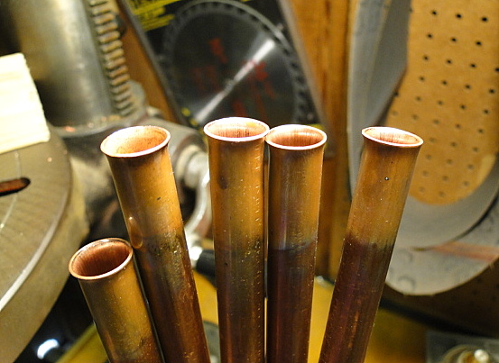

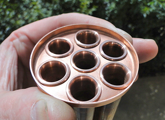

The seven tube ends were annealed once more. They were then mounted in a lathe, and a simple tool made of a ball bearing bolted to a stick of aluminum was applied at an angle to curl the flared copper ends into a nice flange...
It's amazing how quickly copper work hardens. The copper flange starts to flow immediately and easily, but the forces to continue build almost instantly, until you get to a point where the pressures are excessive. At that time, the copper must be re-annealed.

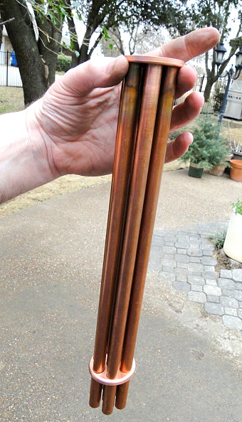

All seven tube ends were folded over, test-fitted into one of the end caps:
This thing should solder up nicely with no leaks. I'm trying as much as possible to make everything self-supporting, so that subsequent solder ops, even if solder liquifies, shouldn't case any of the parts to move or shift.
I'm still pondering how I want to plumb this thing. I'm leaning towards copper ferrules tapped 1/4" female pipe... this is a flexible arrangement that would allow ANY 1/4" pipe fitting to work, anything from a compression fitting, a hose barb, or maybe a stainless steel quick-disconnect coupler.

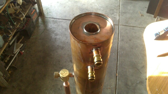

Appreciate that guys, TY. I'm struggling mentally with how to attach the water fittings. I built a little product liebig condenser that can be used to cool the distillate on a LM still, and all I did was turn a pair of copper ferrule buttons that were tapped 1/8" FPT. These were c-clamped and simply held and soldered above a hole I drilled in the outer jacket.
I could do the same with this condenser, except using 1/4" FPT threads... this shotgun will need greater flow. Would a 1/4" FTP opening be adequate?
The problem with this approach... by the time I have a 2" ferrule on the end of my pipe, an end plate, and 7 pretty heavy tubes, the heat sink is going to be massive, and unless these little ferrules are physically captured without solder, they are going to fall off when heat is applied for the other components.
I need to figure out a way to have water attachment devices/ferrules/whatever that are self supporting. All I can think of is a small copper doubler plate at the H2O locations that are riveted in place, with a hole that is threaded perhaps with a straight thread. In turn, the 1/4" FTP ferrules are screwed on. Once there, I can apply a dab of solder at any time in construction to seal.
How do guys attach water to a 2" copper pipe? :econfused:

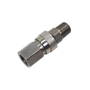

Has anyone tried Quick-Disconnect couplers (come in stainless and brass) for condenser water? They come in various sizes, with the most compact at 1/8" pipe thread being only 1.75" long when coupled. Like this:
A condenser could have a pair of either the stem or the coupler portion permanently affixed. Water lines pop on and off in seconds. Helps keep things stealthy and compact.
I know it's total overkill - a vinyl tube hose clamped to a copper stub would work - but it's obvious I'm a fabricator geek. I think these would be both cool and useful.
I'm aiming for 1/4" NPT at a minimum to allow for an adequate water flow.

I've tried several different versions of those on my brewery and sadly every one leaked. Not badly but the drips were a pain and made a mess. I settled on cam locks and am very happy with them, just wish they had an internal closing mechanism when disconnected.
I think that if I were to go with QDs I would go for the Colder QDs. The brewing world has nothing but great things to say about them.

Wow, that is both surprising and sad. I was really interested in them for their convenience. Odd that they'd leak water at only a few PSI, yet deal fine with compressed air or CO2. Maybe it's the type of coupling that REQUIRES higher pressure to seal.
Appreciate the heads up before I blow a chunk of $$ on cheaper Chinese jobs... I'll look at Colder couplers.

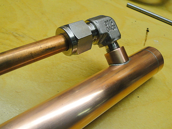

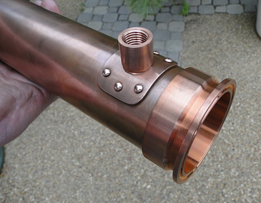

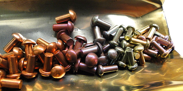

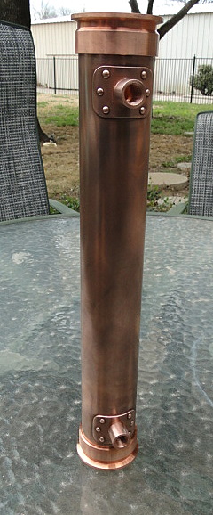

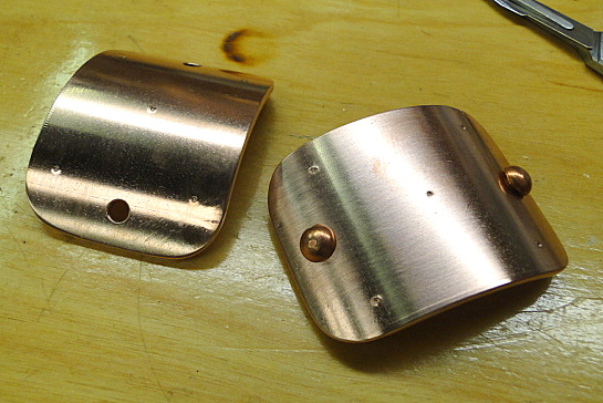

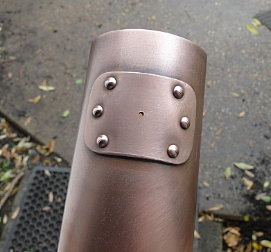

Got some time to knock this thing out. It's ready to solder.
I went with the basic copper ferrules for water in and out, but I did execute riveted doubler plates. This let me thread the ferrules, so they'll hold themselves in place when the entire thing is at heat to solder all the tubes and end plates, along with the tri-clamp ferrules.
Doubler plates... these have two initial rivet holes drilled, and the rest are center-popped:
Copper rivets. These things are fun to work with. I wrapped this batch up in some stainless steel foil, tossed them in a bench furnace to anneal. It's always fun to see the colors due to heating in an oxygen-void atmosphere. Like little jewels:
Rivets hammered to shape:
The doubler plates were drilled and tapped for 3/8" pipe. Not easy to do because tapered taps really tend to go crooked in what is essentially sheet metal, even doubled, unless forced to go straight. I also splurged on copper ferrules...
All I need to do is squirt some solder into the threads of the water ferrules, and obviously solder up the vapor tubes and big ferrules. The doubler plates themselves are just support.
I should be able to use it for both reflux and collection. It's kind of steam-punkish, but I like it. I've never seen a full-sized, old-school still anywhere,but my guess is they'd use copper rivets extensively to connect huge spun copper portions of boilers and columns. Next up for my modular still is a set of Bokakob slant plates in a section of tube maybe 8" long, also tri-clamped on each end.

Hey, thanks guys. Been doing machine work for probably 20 years, but really, the only thing machined on this was the spinning of the inside tubes to make flanges, and the end plates themselves. Everything else is a drill press, files, hammer, etc.
It soldered up well. I'd hate to try and solder one of these when you'd have to protect tubes, connections, ferrules, etc from loosening or falling off. It was hard enough as it was.
It's set aside right now while I'm working on my LM head attachment. Eventually, it'll be either a LM reflux condenser, or a VM or pot still product condenser.

BigSwede: would you be able to share some more details on this build? Here are a few questions:
Your riveted doubler plates: is there solder involved here after riveting? How do you get all the holes sealed? Where can I read up on how to work with those strange (to me) but awesome looking rivets?! I have 2.5 ft of 2" cu pipe but only plan to use 2ft for my shotgun... Would the cutoff piece be a suitable source for the doubler plate?
Your threaded water in/out fittings.. Where did you pick those up from?
Thanks for any spare thoughts you might have!!!
