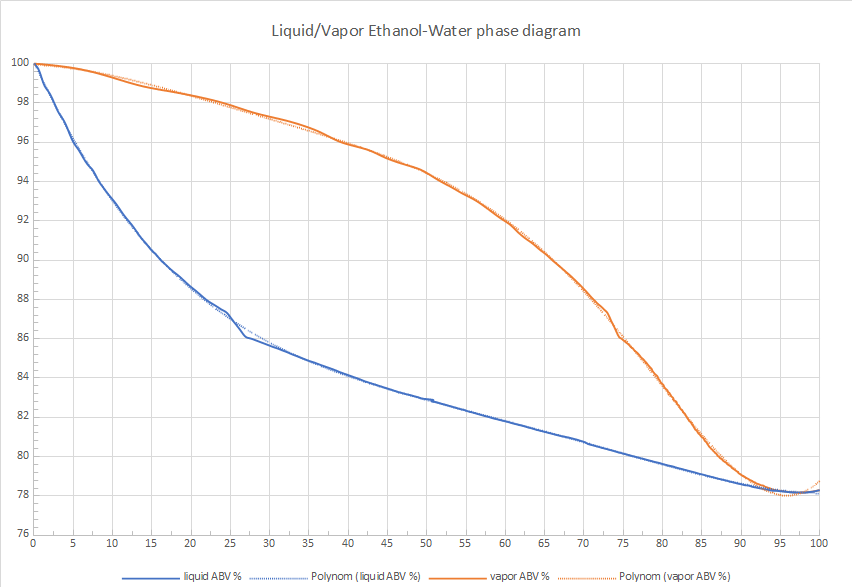

I am using the liquid/vapor phase diagram for ethanol/water solution all the time. It gives me all the information I need about my still by just measuring the temp in the top of the column while running. I found this nice chart by googling:
This chart is not perfectly accurate, but good enough for me. But I would like to make a prettier one for print, and it should be prominently placed in the wiki to in my opinion.
But I have not been able to find (or understand) a better description on how to generate this chart. Or a tool that could calculate the data. I'm guessing that this is a common enough thing that needs to be calculated in the process industry, so there are certainly tools out there that could do this. But where? And how accurate are they?
Do any of you guys have a mathematical formula to generate this chart? Or know of a tool online that could do it? Or a better search term so that I can find it myself?
When searching for "ethanol water phase diagram" I do not get the results I want except one instance of the same chart as above with F scale, and in horrible quality. When searching for "alcohol water temperature diagram" I get something similar. But it is all rather low quality images, no generated graphs.

That is some solid work MtRainier, thanks a bunch. It is all numbers though, no formula as you say, but it is just what I was looking for. Basis for a nice looking graph that I can put up on the wall. The formula wonkiness is just the approximation breaking down as I can se it, not to worry about anyway.
This is the graph from your data. Great stuff.

There is no real formula for this. The formulas of those calculators and graphs are polynomes and base on only a few values. Like the "Equilibrium data" list in the stupidityshouldhurt-link.
This one from member hefezelle is much better:
viewtopic.php?f=1&t=10158&sid=ece93a526 ... 0#p7558917
Based on much more values and connected with spline not a polynome.

The vapor liquid equilibria you find online you see are generated from readily accessible equations. At a base level they are simply algebraic. At a refined level it is a little more.
I have made a study of this for the last year or so and maybe this will be helpful. This learning is solidly in the realm of thermodynamics but don't be intimidated by it.
The liquid line is a graph of the 'bubble point' calculation. You'd input the known molar fractions of the liquid and atmospheric pressure and derive the vapor fractions and temperature. The vapor line is the 'dew point' calculation. Here you'd input the known molar fractions of vapor and pressure to derive the liquid fractions and temperature.
The simple form of bubble point needs 4 equations:
1) conversion from ABV to ABW.
2) conversion from ABW to molar volume. I am using Edwin Croissants' algorithm.
3)Antoines Equation. This establishes the saturated vapor pressures at its boiling point. It's an iterative solution.
4)Raoults Law. To solve for the vapor component fractions.
The Raoult calculation is valid only for an ideal mixture.
I believe that the Brau data and the excellent work done by Mr. Ackland (and Husker) are valid only at standard atmospheric pressure although they do account for non ideal. I would be delighted if someone could confirm this.
The refined solution uses an additional activity coefficient in Raoults Law. This coefficient is determined by a half dozen or so empirical models. The one most appropriate for water/ethanol seems to be the Wilson Model, which I am using. Wilson is not a simple calculation but it is necessary if you are interested in any kind of accuracy or control.
After some head scratching I abandoned the notion of solving this as equations of state (temperature). 10 unknowns; 10 simultaneous equations. Far easier I think to solve for each mol fraction of liquid mix and generate a table. I am doing these calculations in C.
I have to run now but later I will provide a couple spreadsheet oriented solutions that have been enormously helpful in my learning.
