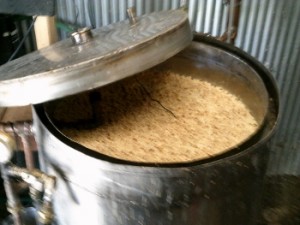

Yak, here's the value of a water sealed lid.
I cooked the mash yesterday, pitched the yeast this morning.
In another 3 or 4 days the ferment will be done.
I'll clamp on the condenser and turn the heaters on.

Man that is art! The problem we are facing with the water seal is the large rounded edge on his boiler. It's a lot of questions and ideas on fairly new territory, know what I mean? We both agree, having the lid still functional would be the cats ass, just got to work on the design for this application while keeping it under a budget.
