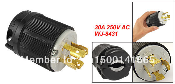

The final question is about what type of twist lock plug I can use for my 10-3 SOOW cord to connect the dryer outlet. It's rated at 250v 30amps on a 30amp breaker. Below is what it looks like:
Would this plug below work on the end of my cable for this outlet? I'm a little confused because all the dryer cords I've seen have the rounded ground plug/pole. All the twist locks have a bladed look. Also could use a dryer cord as long as I cap off the nuetral wire? I really wanted the extra length of the 10ft SOOW cord though.
