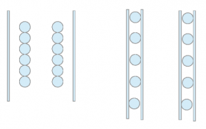

Hi NZChis, I'm just confused. I interpreted what you meant as per the left hand drawing, with water going down the coiled pipe, but if its coax then it is like the right hand drawing where the blue circles are the coax, and the water runs in the white gaps? The LH one has a surface area per unit length equivalent to 3X what you'd get with straight pipe.
If I've still misunderstood maybe you could post a pic? 1000 words and all.
Wishing to save people time rather than being critical, its not clear to me that the RH arrangement is any better than not having the coax because the area in contact with vapour is the same. It may be worse because it cuts area in contact with water. I'm happy to be wrong in this, its understanding I'm after.

NZChris
Posts: 13957
Location: New Zealand
Re: Do turbulators actually work?
Post by NZChris »
RH drawing.
The vapor contact area is the same.
The velocity of the water is higher because the cross sectional area it travels through is smaller and the same volume has to travel 3X the distance in the same time.

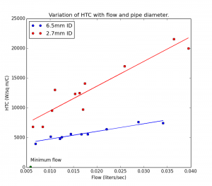

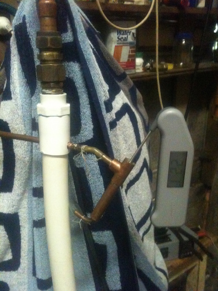

Measuring HTC
Measuring HTC
This summarises the measurements of how HTC changes with flow rate and with pipe diameter.
These experiments were done with 2.7mm ID and 6.5mm ID pipe. (I think its 6.5. Its 8mm OD and I've misplaced my vernier so this is close enough.)
Theory predicts that HTC should be higher in thin pipe compared to thick as the heat has less distance to travel, and the water velocity is higher and so the flow is more turbulent. One also expects HTC to increase with water velocity for the same diameter pipe as the turbulence increases.
See the photo. A piece of copper pipe was passed through a plastic pipe exposed to steam at temperature 100C. The length of copper that is exposed to the steam is 29mm. The steam was generated with a 2kW boiler (wrapped in a towel and stuff). There is too much power to be absorbed over the length, so the length over which power is absorbed is fixed.
The temperature of the water at the inlet (Ti) and outlet (To) were measured with a thermometer (see pic). Inlet temperature was measured with the boiler turned off. The water flow rate was measured by timing the filling of a 750ml bottle with a stopwatch on a phone. The flow was varied by adjusting the tap. The energy absorbed can be calculated as (To-Ti) x flow x specific heat water.
By knowing the area of the surface of the pipe, the HTC can be measured, as the power absorbed is: [100-(Ti+To)/2] x HTC x area.
The first surprising thing in the data is how much power the thin pipe can absorb. In just 29mm it was absorbing between 200 and 400W, depending on flow. So a 2kW condenser only needs about 30cm of pipe ! ... plus safety margin of course. The thicker pipe absorbed more, but not as much as one might expect because of its lower HTC.
The graph shows the data points. The dots are measured values and the lines are best fit. The minimum flow is the flow below which the power cannot be carried away for any condenser design at all.
The HTC values are quite large, but consistent with the 2000 to 3000 W/deg/sq m measured previously. The red points were measured over two days. It took some practice to get into a groove of what had to be done. The blue points were measured on the second day and are much more consistent.
The Reynolds number for the 2.7mm pipe is around 7000 at the minimum flow point which puts it into the region of turbulent flow.
Conclusion ? Coil based condensers (Nixon Stone, Dimroth, Boka etc) have very high HTC values and so take very little material to do their job. They rely on turbulence to do this, but this is obtained naturally from the narrow diameter pipe and high fluid velocity it creates. This makes NZChris probably right that increasing length for the water to travel improves the performance of a Leibig (Eyeballing the red line I get about a 30% improvement from that). So would making the outer pipe to inner pipe gap as small as possible, allowing for water flow of course.
I'd love it if someone else repeats these measurements and calculations. It is not science till its done in two places getting the same answer. My work is not checked for dumbf errors and that makes me uneasy about believing it too much. I'm just about to start my new head, which will be a Boka, plan changed after a helpful comment.

still_stirrin
Posts: 10372
Post by still_stirrin »
Good stuff engunear. Confirms hypothesis learned 35 years ago in school.
An old adage, "figures lie and liars figure" seems off basis here. Your tests and analyses have proven the suppositions.
Thanks for the revelation.

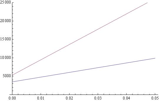

Hi engunear,
If you were to take the slopes of the lines in the graph you've presented, you could have a single number that would describe a condenser. The units of the slope would be HTC/Flow, or (W/m2 C)/(liters/sec).
There are various ways to express the units. The flow rate could be eliminated by turning the watts into joules/sec, giving joules/(m2 C liter), or if you elimate the liters and turn it into m3/1000, you get kJ/(m5 C). When you get such unwieldy units, it's time to name it.
So, your graphs give
(18000-9000)/(.035-.01) = 360000 unnamed units for the 2.7 mm condenser
(7000 - 4500)/(.035 - 0.01) = 100000 for the 6.5 mm condenser.
M
engunear
Posts: 309
Joined: Thu Jun 20, 2013 10:01 pm
Location: Couch
Post by engunear »
Hi Martimer
Not quite sure what you are thinking as the lines don't pass through the origin so two points are required to describe them.
To save your calculator, the lines are 3483+flow*128,482 and 5322+flow*416,318 (from the trusty NumPy polyfit function).

Maritimer
Posts: 716
Joined: Sun Jul 01, 2012 6:09 am
Location: Nova Scotia, Canada
Post by Maritimer »
Hi engunear,
Hmmm, yes, I hadn't considered that the lines don't pass through the origin. Would it be possible to do the 2.7 mm experiment over? It would be interesting to see how close the lines would come together at zero flow with a more accurate experiment. From your equations, they are 3483 and 5322 W/m2/C.
What does zero coolant flow mean? The still coolant would heat up at a certain rate.
engunear's graph.jpeg (13.24 KiB) Viewed 2703 times
Given the broad distribution of the data set for the top line, it might be possible for the lines to be much closer at zero flow.

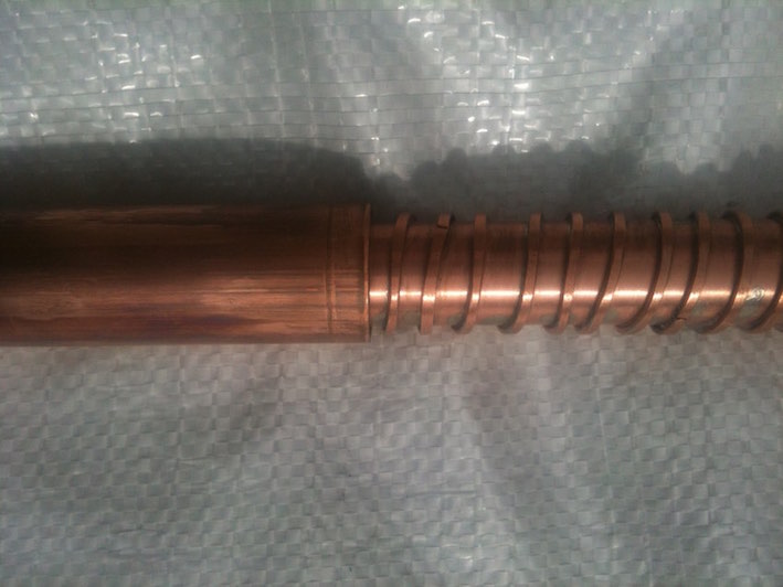

Having done a lot of expts on turbulators and reading about fluid dynamics and heat transfer, and having built a Leibig with a turbulator, I'm gonna summarize the gospel according to St Engunear. I want to do a final dump to empty the brain and move on to other things to think about.
There are (at least) four kinds of turbulators:
1) Coolant stream ones that create turbulence by disrupting flow, usually with a spiral. See youtube under "laminar flow" https://www.youtube.com/watch?v=WG-YCpAGgQQ" onclick="window.open(this.href);return false;" rel="nofollow.
My measurements showed that they don't make any difference. The hypothesis is the scale of the turbulence is too large compared to what is needed. The layer of water that provides the thermal barrier is around 0.1mm thick. The turbluence a spiral turbulator produces is of order 1-3mm.

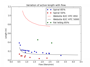

I think the book numbers for HTC on the calculator are wrong because they are for industrial size condensers. Our little toys are just outside their worldview. That being said, if you build off the website calculator this error puts a safety margin in there, which is a good thing. Just don't add a second one or your unit will be big and unwieldly. But HTC varies with lots of factors (alcohol purity, coolant velocity, jacket dimensions) so measurements in context are the most accurate source.
Heat transfer coefficient is lower for alcohol than water. Pure alcohol seems to have the lowest HTC. (Thanks DeepSouth)
As evidence of the above, see the plot that shows flow vs length data for a variety of Leibigs. The red line is the website calculator with HTC=850. The two green dots are mesaured from a Leibig with a 3mm gap bewteen the inner and outer pipes, and straight flow. This is measured with 85% alcohol. The blue dots are tighther fit (2mm) and a 10X spiral. See pic. The black line is the website calculator with HTC=5000. The red dots is 50% water 50% alcohol with the spiral. This is a little odd as I had previously figured that 50/50 would be worst. But this is data that is hard to argue with.
It is also probably true that a nearly horizontal Leibig works better than a vertical one (limited data on this, but the distillate slops to one side rather than coating the sides evenly and adding to HTC.). If you do a saxophone design you can get the balance to work for you as well, so the unit is easier to support. See pic.

Performance curves of sax condenser with coil

Sorry if I wasn't clear.
Anything that increases the velocity helps to increase HTC. This can be having a smaller gap between inner and outer pipe. This helps because the velocity is the volume per unit time divided by the area ; smaller area, larger velocity.
Adding a spiral that fits against the outer pipe also increases the velocity so it helps as well. This increases the path length. It is easier to get an increase in velocity this way than with a narrow gap. HTC change with velocity is weak effect but because you can get 10X or 20X increase in path length, you get a significant (2X) shortening in the overall condenser.
A spiral that does not fit against the outer pipe does not help. The youtube clip is instructive but misleading for us. A spiral that fits against the outer wall but only gives a small increase in path length will only help a little bit. The effect is weak so a 2X increase in path length will not give a dramatic reduction in required length.
It would be possible to make the spiral fit snugly against the outer wall and solder it to the outer wall as well as the inner. This increases the area of copper in contact with the coolant so gives an extra benefit there. Need to be careful you don't get a blob of solder blocking the path. This would take a lot of thought and care to do right, but should work well.
Just turning the flow up increases velocity. You get more benefit from the extra flow from the extra velocity, but they do both contribute.
Although it is off topic for this thread, the coolant velocity in a coiled condenser (offset Nixon, Boka etc) is much larger than in a Leibig so these can be very small for their cooling ability because the coolant pipe area is comparatively small. There is a related thread "Engineered coiled condenser", which talks about this and drifts into Leibig's as well and has a lot more discussion of HTC and flow velocity.
I found no other things that you can do with coolant flow that help.
These benefits allow us to build shorter condensers. Once you have built one, and its working to your satisfaction: not venting at reasonable flow, and not too unwieldily, then it works. And if you build one and its too short then its a prick. If you have one that is unwieldy and you suspect is too long, before you cut it down, you can stick a thermocouple up it and measure where it is condensing and cut it down based on data. If you do that, remember to do it with the highest concentration of alcohol you normally make.
Other people can talk about how to expand the destiny of mankind. I just want to talk about how to make whiskey. I think that what we have to say has more lasting value.

Thank you. That is more clear. So basically your saying, "Forget turbulation, do whatever you can to make the water run faster." And then you equate faster running with 1) smaller cross section, and 2) longer path.
The first is true up to a point. The second is just rubbish.
1. Yes the river runs faster through the rapids, the fluid flows faster through a venturi, until the restriction passes a threshold where the river backs up into a lake and the fluid builds pressure. Beyond that point the restriction is counterproductive. I'm still not clear whether you are advocating a 0.1mm gap, or a 1-3mm gap, but I suspect those may be in the counterproductive zone.
2. Making the river longer doesn't make the water hurry to get to the end on schedule, it just makes it arrive later.

If it arrives later then the velocity is lower.
If the flow (litres/sec) is the same, and the path length is longer, then the flow velocity is higher.
The outer diameter of the inner pipe is 19mm. With no coil, the cross sectional area of the path is pi * 19 * height (2mm) i.e. 80sq mm.
The gap between the spiral wires is 4mm. Cross sectional area = 4mm x height (2mm) = 8 sq mm.
Decrease in cross sectional area 10X.
Flow is the same. Therefore increase in velocity is 10X.

No. Arriving later just means it spent more time in the condenser. Liters per second is flow volume. Velocity is inches per second.

engunear wrote:The outer diameter of the inner pipe is 19mm. With no coil, the cross sectional area of the path is pi * 19 * height (2mm) i.e. 80sq mm.
Pi*19*2=119. Your new cross section is 119mm2 minus the area of the ellipse described by the intersection of your spiral wire with a plane perpendicular to the axis of the condenser. I think it is evident from the photo that wrapping the wire didn't eliminate 90% of the cross section. To calculate from the gap between the spirals, you would have to account for the increased length of the spiral path.

Yes you are right, I did make an error. The area before was 120 sq mm. Apologies if I missed that the 2X in your calc which is the height.
The area after is 8 sq mm less the wire thickness. So the difference is > 15X. But that does not change the basic premise, since we don't have the exact function relating velocity and HTC. You can measure the change in path length by comparing a length of a piece of the wire before and after coiling. And its about 10X. Its a bit sloppy as I don't have the means to make a neat spiral.
The problem with the river analogy is that if the path length increases due to uneven bottom, but the depth stays the same, then the volume has increased. In this case the volume has stayed the same, or reduced even.
But if you want an argument, please pick someone else to have it with, preferably on another website. I really don't have the energy. I'd also suggest you try out a few of these ideas and see for yourself. The data on performance speaks for itself. If you take a measurement and find differently I'd be interested to discuss. Maybe I'm missing your tone, if so I apologise.
