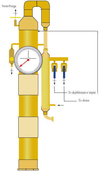

This might work for you!
My representation of the dephlegmator is symbolic not actual, but the main coolant flow will be through the upper chamber. The dephlegmator chamber should be able to achieve lower flow rates, with the baffle preventing excessive mixing of the coolant.

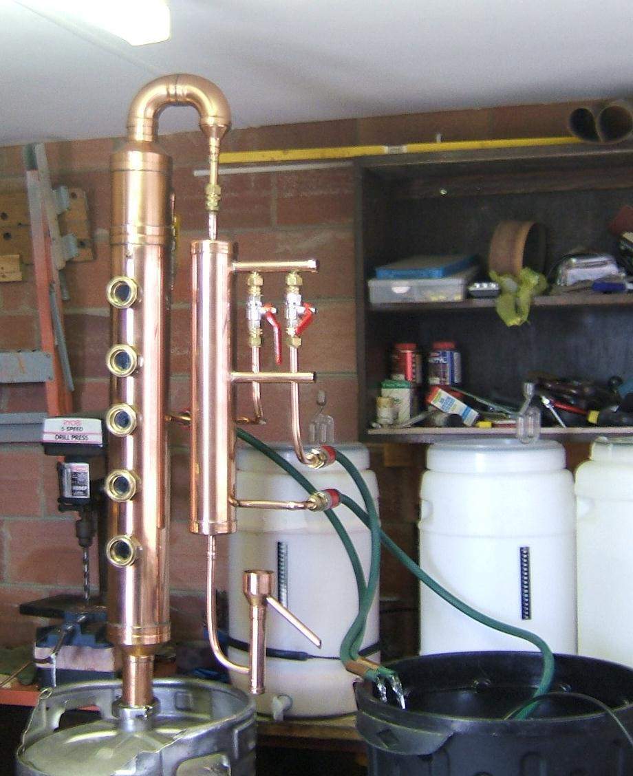

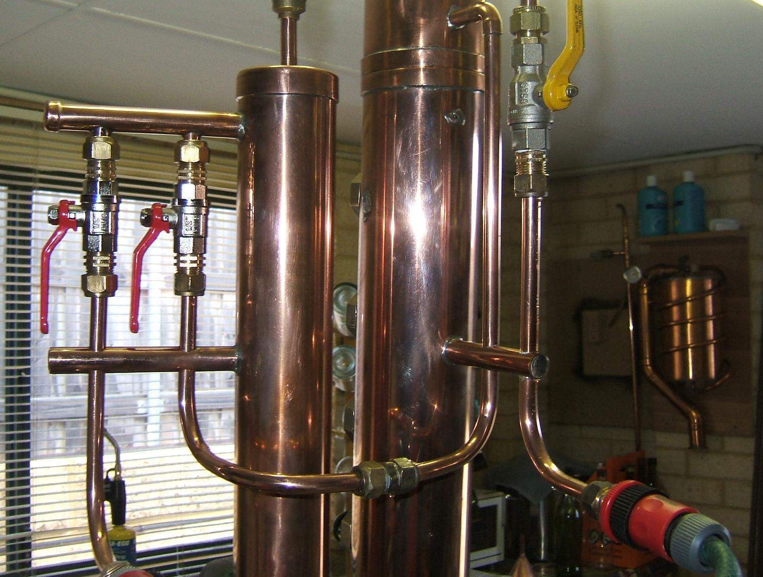

That is the valve system I designed for the original Flute
OD
Here is the rear view showing the restrictor valve on the dephleg output.
I have since changed this system design to a single 3 way valve with an internal T configuration, this automatically bleeds the pressure when the supply to the dephlegmater is reduced.
There is no need for a restrictor valve using this system as the pressure remains constant automatically. OD
