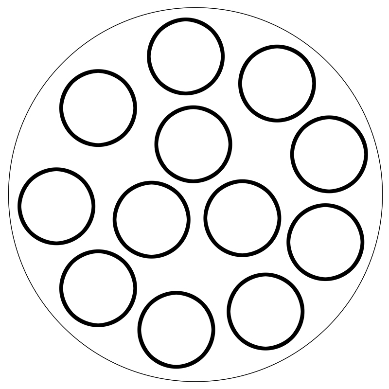

Hi guys,
I've just built a 3" Bokakob to make basically neutral spirit. My heat element is 5500W and my packing is SPP. So looking at this table
( http://pracowniametaloplastyczna.pl/en/advices" onclick="window.open(this.href);return false;" rel="nofollow ) I will have to work at about 4600W. I trust this table because I was working nicely with a 2" column at 2700W
I built a dimroth reflux condenser but looks like it is not able to knock down more than 4000W. Anyway as I have a 12" SS spool tube I'm thinking to build a Shotgun.
Using 15mm OD copper tube I could build a 12x12" lenght in a 3" ID (72mm). Setting 5000w in the calculator estimates about 2.75m of 15mm tube and If I build this condenser I would have 3.6m
This is my idea, but I would like to know if I'm on the good track.

As I wrote in the other thread, I don't have practical experience with dimensioning shotgun dephlegmators. But unfortunately no one answers, so I try:
The parent site calculator gives you not the right results for reflux condensers. Reflux condensers can be noticeable smaller than product condensers.
BTW you have to type in the inner diameter. 13mm, not 15mm. This results at 5000W in 3.04m. So perhaps you need 2m. Your plan is oversized. But it looks very symmetrical with 3 tubes in the middle and 9 besides. So I would go for it.
But perhaps look in other builds, what other members have written. Google search shotgun perhaps.

Re: Shotgun reflux condenser for a 3" column
I finished the deplhegmator. In the Bokakob configuration it will be fed with water from the liebig.But I have a question...
I think if I connect the hose at the top of the dephleg (counterflow) water will flow at the bottom and the dephleg will not be full of water.
Should I connect water in at the bottom of the dephleg?

Great advices cranky, As you say my RC supposedly is overkill. It is 11" long x 12 tubes (13mm ID). But my idea was to work peacefully. Anyway at the moment everything are suppositions but I think i'll be working at least about 4000W because SPP works better with power. So that's why I wanted a beast condenser
... But you are right a mirror will help me to know what is going on.
I have some concerns about air inside the water jacket... I will try first the hose loop and if I have some issues I will connect water in at the bottom of the dephleg.
I don't know exactly why but it was quite difficult to seal it completely.... I was making some test connecting the dephleg to tap water and when I blocked water out I realized that with the water pressure there were some pinholes. I think is completely sealed now. Besides that, it won't be subjected to a such pressure.... But if you think it is a serious issue and must be guaranteed a perfect seal I will try to check it 100%...
Thank you guys, I really appreciatted your help ..

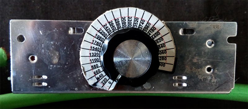

I made this rustic scale to measure my power, so nothing to say...
- cranky
- Posts: 6513
Looks pretty good to me.sergiolis wrote:I made this rustic scale to measure my power, so nothing to say...
On that scale I probably run around the 2200-2640 area.
I was at 2700W with a 2" column packed with SPP... Let's see what I get with the 3"...
