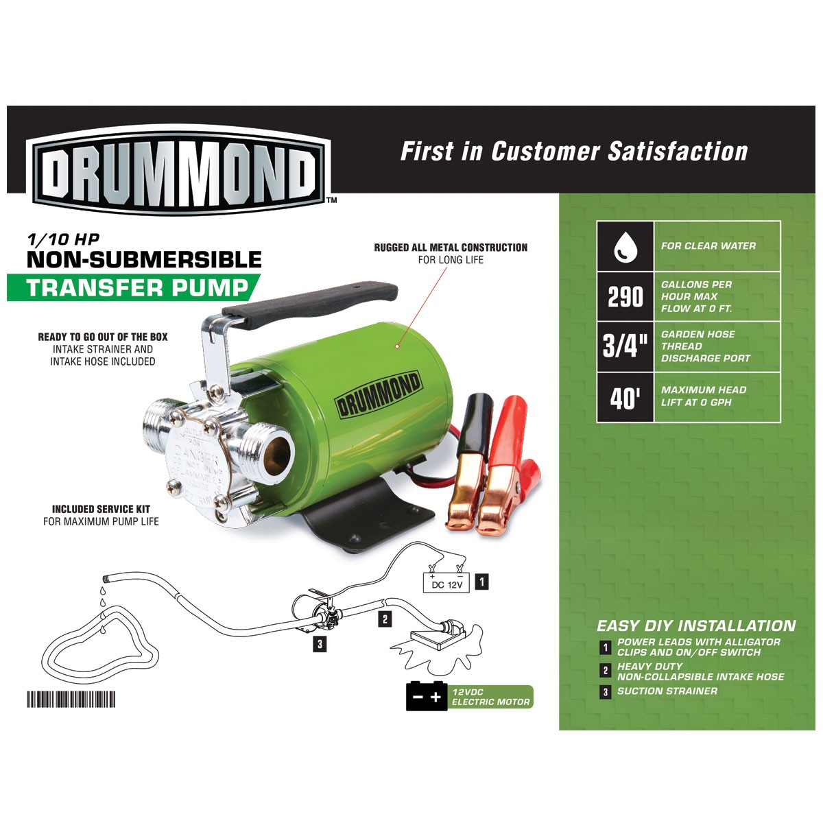

I've been reading a few hours a day for a week and I still cant choose which pump to order, we have one store in my location and I'm not good at ordering stuff I don't know about online, at this point I'm very frustrated and confused. It has to run off a car battery and hook up to a garden hose so I can distill away from electricity. I don't want a worm, the ground is too uneven to deal with all that. Can someone recommend a pump for me to order? I've found this one but it seems overpowered but it's the cheapest one that comes with clips for the battery I've found. Would it drain my battery too fast?
https://www.harborfreight.com/12-volt-d ... gJ3ofD_BwE" onclick="window.open(this.href);return false;" rel="nofollow

So getting back to your harbour freight pump . It can do 290g/h ... thats over 1000liters / hour ..... so this implys to me that that pump is about 10 times more powerful than it probably needs to be to do a typical distilling job .
Now another thing I noticed is it draws ( at full power ) 9.4 Amps ...... now that is going to suck the guts out of a typical car battery and running flat out for several hours would most likely kill a good battery pretty quickly .
So guess what I’m saying is its the wrong pump for what I imagine you are trying to do .

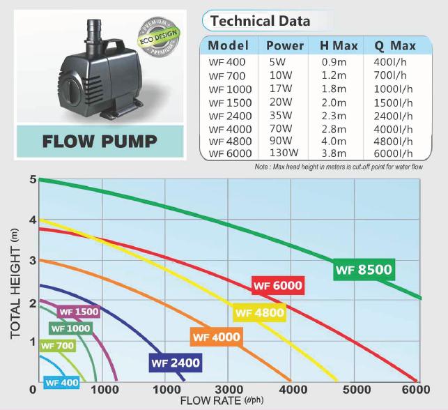

The pump you provided a link to should work but it is dependent on how and with what it is used.
If you are just recirculating water and the only pressure imparted will be that of the head head height, than that will work.
Most sellers will provide a chart like this, to show how many L/ per Hour at what head height. Your site only has basic info 290 G p/hr at 0 head height, then it jumps to 0G at 40ft.. This is how you work out head height, if you are pumping from a bore where the level can change dramatically you need to take that change into consideration.

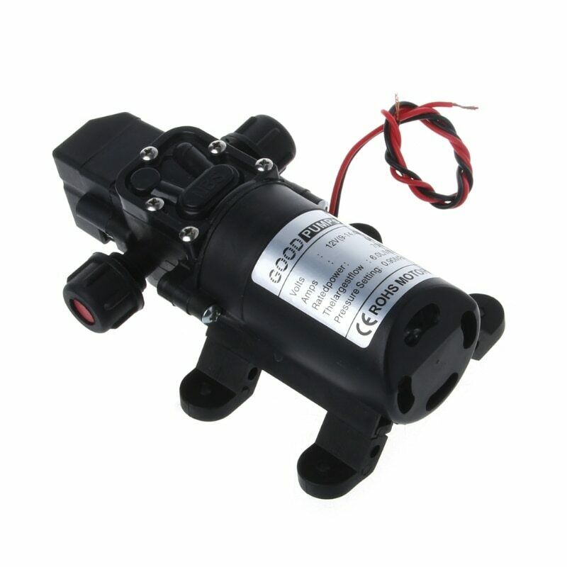

I use a 12v Diaphragm pump like this to feed multiple 1/4 and 3/8 condenser coils through a transmition radiator.
You do not need very high PSI, you need to balance flow v pressure to suit your needs.
Pump power consumption is proportional to the pressure and flow rate needed.
you can also add a DC speed controller to control flow rate.

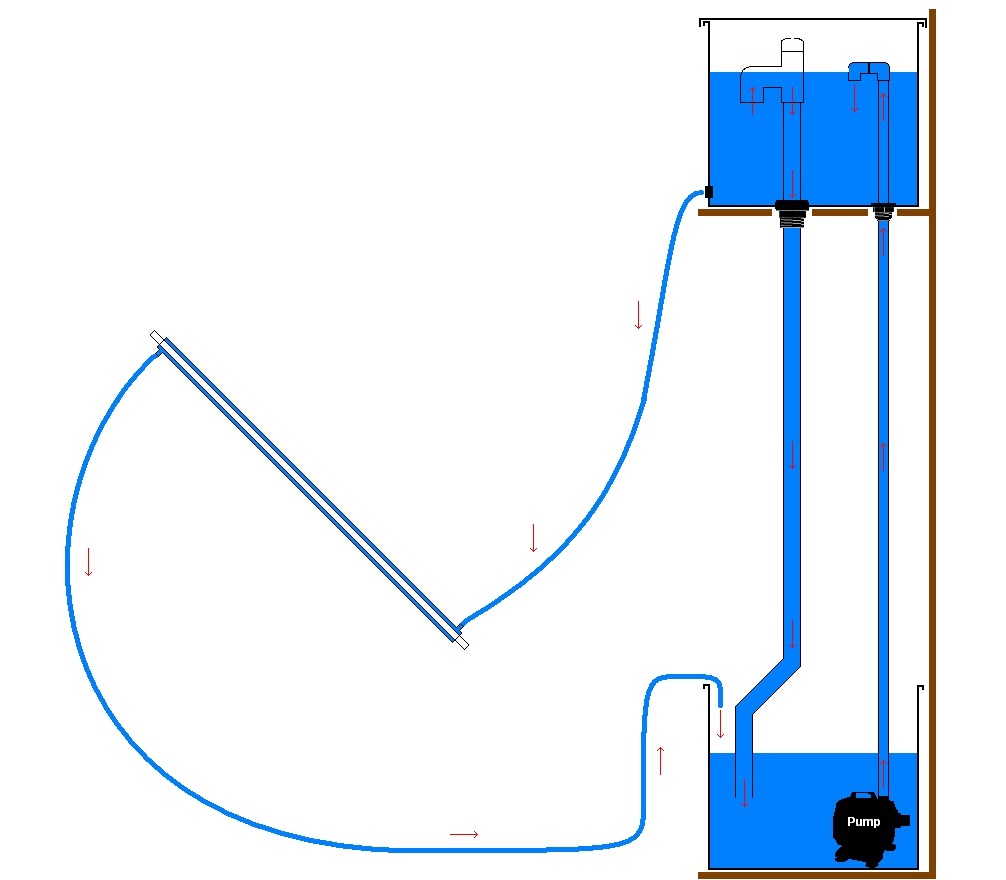

I'm not sure if your system is automated or not, but if it isn't, this is an option I have considered in the past. If you don't mind a pump running nonstop, you could install an overflow in your elevated reservoir that drains down to a reservoir sitting on the ground. The pump would constantly pump water from the lower reservoir, keep the upper reservoir full while continuously overflowing back down to the lower reservoir. Your 12v temp controller can turn your solenoid on and off as needed to feed water through your condenser. Basically ... the only difference would be your pump would run nonstop, but you'll never have to worry about refilling the elevated reservoir manually or manually turn on the pump.
I know of at least 2 different styles of overflows that can be easily and inexpensively constructed out of PVC fittings in the links below. Both are silent in operation, neither create a siphon, both function equally well, but the Durso Standpipe is easier to make. The attached drawing is missing a valve to control water flow through the condenser:
Durso Standpipe
Stockman Aqua-Silencer
There's a lot different ways to automate your water setup, but the overflow would be the most simple way. You could have 2 float switches to turn your pump on and off to keep the elevated reservoir filled within a certain range.
My thought on the drawing below is ... if I'm going to have a pump running nonstop ... I might as well keep it simple, run water through the condenser and bleed off excess flow using a bypass.

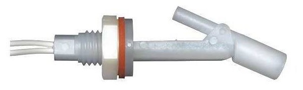

I use a similar setup to what you have there but I use a float switch to control flow versus a overflow. You can control the top water level and then it turns off when it reaches the low level. No use wasting energy with leaving the pump on all the time.
Here's an example - there's plenty more out there:

Re: I need a Liebig pump that runs off a 12v car battery, he
There are micro float switches for as low as $3.00 to $10 or so. 12v or even 110v versions are available. The lowest prices I saw in a quick search is on eBay.Single Malt Yinzer wrote:I use a similar setup to what you have there but I use a float switch to control flow versus a overflow. You can control the top water level and then it turns off when it reaches the low level. No use wasting energy with leaving the pump on all the time.
