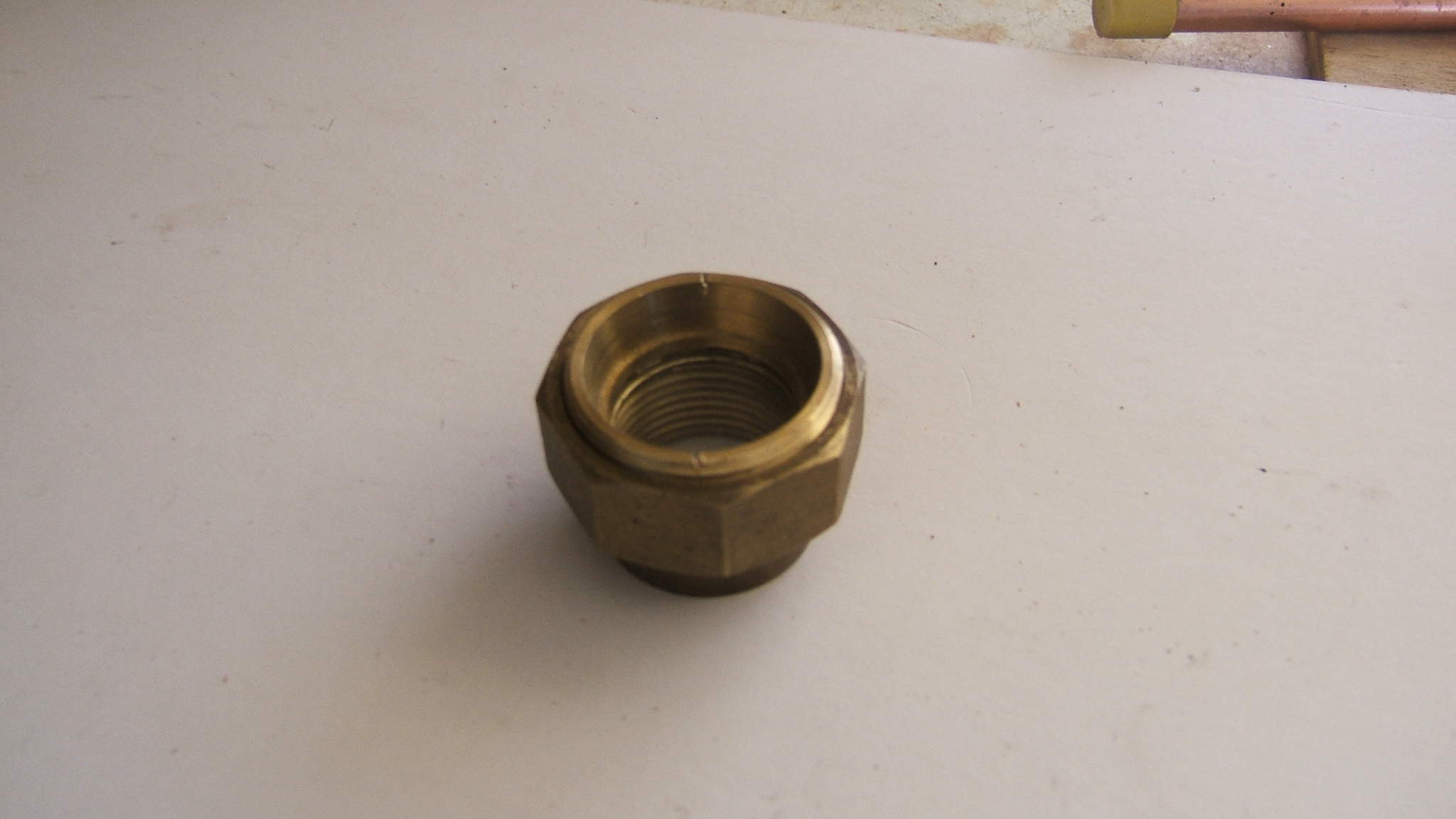

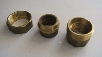

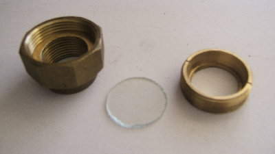

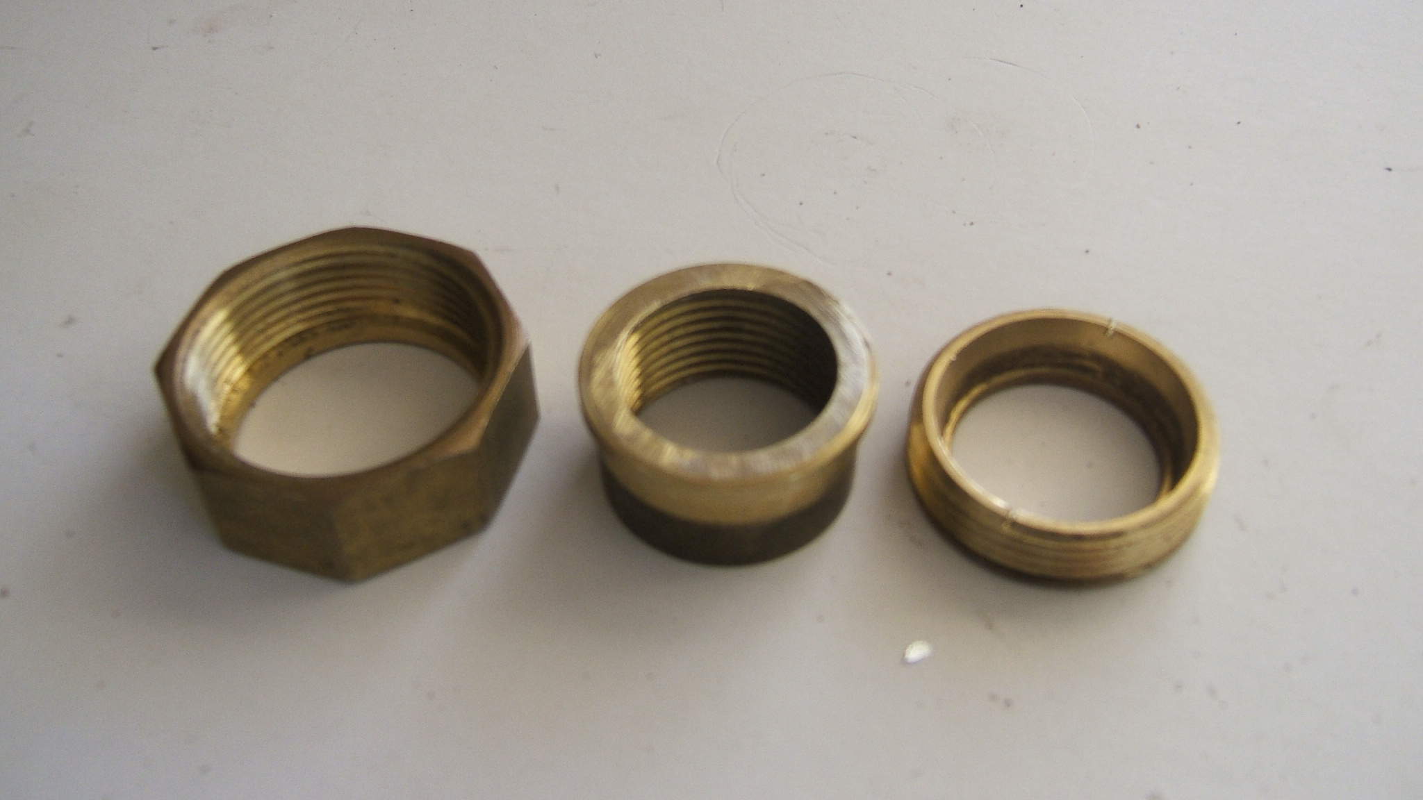

Here's how I made the sight glasses.
The original brass coupling.
Dissasembled parts
Parts modified by cutting off the hex nut
Parts ready for assembly with glass window disc
The finished sight glass ready to be de-leaded and soldered into the new column.
The cost for these were, brass couplings 5 @ 69c each = $3.45, diamond glass disc cutter $7, total $10.45
OD

Allright I'm going to be the dummy and ask. How did you cut the brass fittings to get a good flat surface?
olddog
- Posts: 3618
- Location: WEST OZ
Re: sourcing a sight glass and another Q
Errr, with a hacksaw, and then file flat, I'm using musical cork back and front of the glass, which take up any indiscretions in the surface.pumpman wrote:Allright I'm going to be the dummy and ask. How did you cut the brass fittings to get a good flat surface?
OD

Has anyone ever bought any musical quality cork
I had ordered some for the sight glasses on my new still. A sheet 14"by 4" cost AU$39, It cost more to use the proper cork to seal them than the sight glasses themselves cost to make. Not happy with that price but I did not have an alternative.
OD

OD i may be slow, could you explain what you mean by
as far as the de-lead is concerned, thanks for the help.The finished sight glass ready to be de-leaded and soldered into the new column.
"illigitimus non carborundum"
olddog
- Posts: 3618
- Location: WEST OZ
A small amount of lead is added to brass during the casting process to aid as a lubricant when the casting is machined. By soaking in a 50/50 mix of peroxide and vinegar for around 15 minutes, the lead will be removed from the surface.
