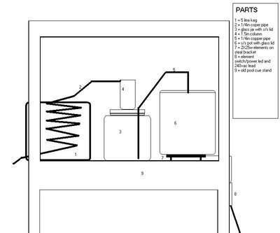

hi to all im new to this site i made my first still this week and i think i got it right this is a basic pic of it
any comments are welcome as this is my first
This is a diagram of my first still (built on fri 17 sep 2010)
i went to run it for the first time on Friday and it didn't go so well sprung a leak in cooling tower and then the seal on the pot ( was just gaffa taped ) it was working as i was watching the thumper bubble when the pot was hot but nothing came out of the condenser and the stuff in the pot smells like it would put hair in ya chest with 1 sip
so my ????? is
1.) what would i be able to use for the seal on the pot that will not contaminate my alcohol (would a rubber seal and then tape be fine)???
2.) will my still work ???? (in your opinion)

glass lids?
glass jars?
1/4 (6mm) pipe?
better do some reading.before you make something toxic or some fireworks.

aussiealex wrote:... 2.) will my still work ???? (in your opinion)
At the risk of being blunt, NO! Or not very well anyway. Dunder has summed it up pretty well, if not perfectly.

"gaffa tape" ? gaffers tape ? for a seal on the boiler ? cob

as i have run this for 6hrs or so and the only reason i can see making it not work
the seal on the pot not sealing and pressure escaping
i have been researching on the net can u enplane y this is a bad idea

Your trying to force heated vapor through a 1/4 Tube
More volume than there is pathway so your building pressure BIG NO NO so your alcohol in vapor form is dissipating out your boiler lid <<<<DON'T LIGHT A CIGARETTE if you like your eyebrows
Oh and the fact that your running it after Blaniks and Dunders warnings shows you probably won't understand what I said either.

i ran it b4 i put this post up in a well ventilated place
there is not much pressure in the boiler because the heat is lower than normal
pot 7.6l
thumper 2l
on a low heat should not create much pressure as the slower vaporisation just means longer time to distill say 5l wash

1.) 1/4 inch copper pipe is this ok for a small pot still ? ( seen heeps of ppl say its ok )
2.) glass thumper ? ( seen quite a few of them on this site and ppl say its all good)
is one of the reasons for my still being bad the column on the thumper
i know most of you all said
"glass lids?
glass jars?
1/4 (6mm) pipe?"
and have read the articles 0re0 said to read and i don't see the problem
the only problem i can see is the seal on the lid (but im gonna change the lid to a s/s lid and hold it in place with a s/s ring with 4 springs coming off it too where the handles were on the pot )
please help as i have put alot of spare time in to reading the posts on here and alot of other ppl have used similar stuff
and said it works and didn't get blasted so is part of the reason also because i said it didn't work properly
thanks again all

You need to make you a flour paste to seal your top. It works amazingly well, get rid of the tape. If you loosing anything at all from around your lid, that is all alcohol vapor. In my opinion you need to use at least 3/8" coming off your boiler, personally if it were me I would use 1/2". The 1/4" may work but don't throw to much heat at it, that will cause pressure to build up with such a small take off. Personally I would ditch the glass thumper. If you gonna use a thumper I would build me one form copper or stainless or order you a small wood keg and make one.
If you loosing any vapor at all from around you lid SHUT DOWN Immediately
Be careful man,, your working with very flammable Vapor that you cannot see..
KS

I thank you better go back and read those articles again, tho some use glass most all frown upon the use . (and if used should be tempered/Pyrex type)
simple GLASS BRAKES . broken /leaking parts and hot ethanol can be disaster ,even at low proof if heated.
small tubing for lyne arm/condenser can /will build up presser and vapor speed both of witch you do not want.
1/4 tubing mite handle 2 hundred watts? that I'm not sure of, others in engineering would be better qualified to answer that
but to put it in layman's terms ,you want the vapor coming out of your still in a "lazy"manner not blowing out like a boiler
for a steam engine.

hey thanks for the input im using 1/4in for that reason (only 2x25 w elements w/max temp of 94 degrees Celsius taking 2 hrs or so to get to temp depending on how much wash is put in still) i think im gonna take the thumper off and just have it as a standard pot still or making a triple thumper out of some 2in pipe at 150ml high and having it sit on the side of the pot so they heat a bit quicker as the pot does not get to boiling point for the water
how would i go about making the paste that u were talking about
ps i have had just water in it to do a test and water dose not boil but almost so the pressure is not that high i will re make the still tomorow morning and do a full test run with just water would that be a smart thing to do
and i also bottled the wash that was in the still (what i went to run on friday arvo) and it looks alot clearer than what it was when i put it in

PLEASE do us all a favor and do the research as has been suggested by your fellow members... We aren't going to hand-hold or spoon-feed you every step of the way... The still you have slapped together is just plain dangerous and inefficient... Any amount of research should enlighten you of these facts... Your dialog here proves that you haven't done enough research... We are here to help you along and keep you, your friends, and family safe...
Stainless steel and copper... No glass, rubber, or plastics...
We aren't going to help those who aren't wiling to help themselves... Simply because we didn't approve of what you thought was a satisfactory still doesn't negate our concerns for your safety...
Scrap the ghetto still idea, do your research, and build a safe still if you are really interested in this hobby... Otherwise, find another hobby or go where folks don't care whether you use inferior components and don't listen to folks who have many years of hands on experience...

That there still is just damn dangerous... You could very easily cause serious harm to both you and anybody else close by...
Vapor is a very flammable gas that, once ignited, detinates in a large flash...
The pressure inside your boiler is caused by the vapour not being able to escape fast enough...
Please, myself and your fellow colleagues here at HD only want you to be safe...

You need to shut down and do more reassure. I want you to be safe and successful in your new found hobby.
I would start with a 1in pipe off your boiler and tapper down to a 1/2in to 3/8in worm coil, minimum of 7 turns on your coil. Skip the thumper for now, you can add one latter.

hey guys thanks for the info and your consern the still is nolonger in action i pulled it apart this morning when i woke up
i did some maths and from what i got i thought 1/4in pipe would be sufficient so back to the drawing board i think
thanks again all
will post plans for the new 1 this weak some time am going to talk to a mate that has been doing it for about 2 and a half yrs but i dont have a ph for him so roadtrip

A worm made from 1/4" tubing will choke and surge due to the wetting effect within the worm... 3/8" is the absolute minimum size for a worm and the larger the boiler and more heat input, the larger the worm needs to be... The information is all here... Calculations don't mean shit when compared to the real world practical experience of many...
