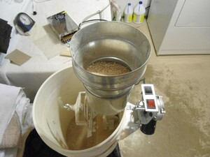

Here's what my corona mill look like as a setup, and does the job well.. corn will take a few passes, and most others one pass..HuckFinn wrote: ↑Thu Feb 18, 2021 2:31 pm I tried a knock-off brand of that. It went terribly. Are you confident that it works out okay? I feel like it also can mar a table like my knock off one did. Maybe 1/3rd the corn wasn't cracked, 1/3rd was cracked, and 1/3rd was flour. I didn't like it, personally.
I can use the mill by hand, or by motor (as shown), or with a half inch drill..

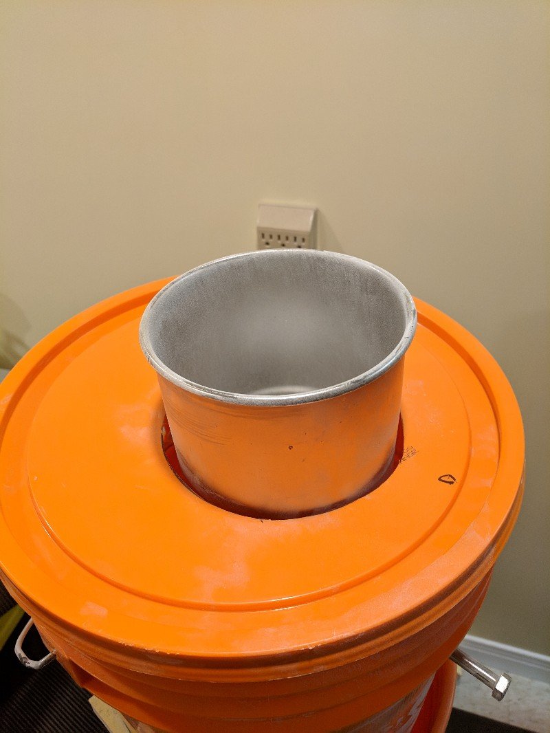

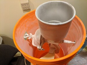

I did a corona mod with some nested homer buckets and running it on a drill. The battery drill wasn’t really enough to get through a run so i bought a dedicated corded drill with more power that wouldn’t overheat. A couple spills of my rigged up hopper was pretty frustrating. Ended up with an agristore and it turns everything to flower or meal which works perfect for corn. If i was doing more single malt barley/wheat I might get fussy and prefer a roller mill for better lautering but not there yet and this works great for my foreseeable future. Well worth the money and by the time you spend on a corona, drill, and any purchases for mods you might just want to spend a little more for a purpose built thing? Just my thoughts
I did re assemble the corona for the kitchen where I use it to mill grains in my koji-cooking endeavors. The fraulein might use some hand milled flour too. Seem to have a variety of whole grains available for some reason and hand milling smaller quantities is sorta cool too

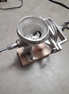

HuckFinn, this was this afternoon's project. I too, tried the hand crank....not so young anymore, and not so fond of that. So I decided I would motorize this Corona mill with a cheap $5 CAD garage sale drill.HuckFinn wrote: ↑Thu Feb 18, 2021 2:14 pm I tried a hand crank one and it did not work well. I am seeing others like kitchenaid grain mills (that have a coarse setting), but I am worried that these will be too fine. It appears that most are made for barley or making flour.
Does anyone have a good affordable (and hopefully reasonably smallish sized) suggestion to crack corn?
Now....I'm not an engineer. I usually do things by trial and error, and a lot of the time, I spend days planning out how I am going to do this before realizing there's a much easier solution to be had right in front of my eyes. Today's case in point:
I had a large plastic funnel, quite stiff, that I have used to pour into carboys, empty bucket to keg, etc. I now need another funnel, but it was something I could get by with (siphon is slow, but it works). I can't get by without a mill for what I want to do, so it was sacrificed to the grain mill gods.
I eyeballed the diameter (cause I'm once again, NOT an engineer) and sliced off the end of the funnel to be just a bit smaller than the opening of the grain mill. Stiff plastic, but with some gentle coaxing it can be made to fit over a diameter slightly larger than the hole, and then sits snugly around it. Step 1 completed.
Step two: I hacksawed off the bottom of the attachment part of the mill, so I could have it a) sit flat on a piece of wood it would be bolted to, and b)sit farther down into the bucket I was going to use, thereby allowing me to put a lid on the entire thing to keep flour dust in. (notice the notch where I started cutting)
Step three: I used some small carriage bolts to attached to a block of 2x4 I had drilled two holes in, running the length of the mill, in order to give it some stability and not want to tip forward all the time.

Step four: I drilled a hole into the side of the bucket for a similar thread bolt with the head removed to slide through, and then attached the drill to it. I did flatten the sides of the bolt in order to give the drill more "grip" on the bolt.
Step 6: Loaded it with malt, cranked it up on high, ensured success for about 3.42 seconds and then the mill tipped, knocked the lid off, and blew flour dust everywhere. The torque from the drill tipped it over onto it's side.
(not me, but a damn good representation).
Cleaned up, thought about it, had some previously run likker with some orange juice, and figure out how to brace it. (Remember trial and error?)
Step 7: Grab the jig saw, outline the bucket on a 2x4, cut just inside the line so it will fit, and screw the carriage bolts through both blocks of 2x4, this time with the bottom one widthwise to the mill and try again - SUCCESS! If you look close in the picture below you can see what I did.
It will mill 2lb of grain in 30 seconds flat. (not corn, but gives you an idea....I've never milled corn)
I would check around with any local homebrew clubs. The nice thing about distillers is that we are everywhere, but the bad thing is that we are underground. Could have someone from the forum next door and I would never know. But homebrew is more out in the open, and someone might be looking to upgrade their mill, as in the case where I sourced mine.
Good luck.
