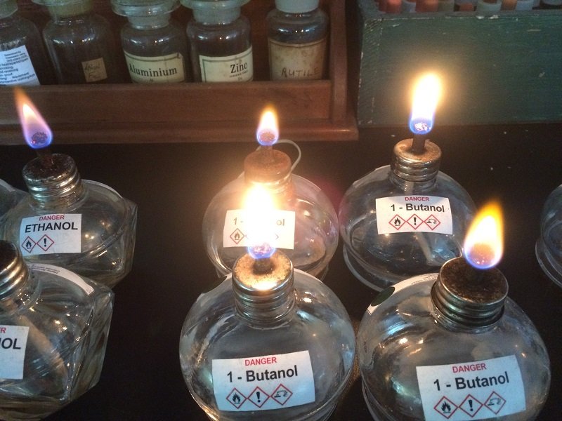

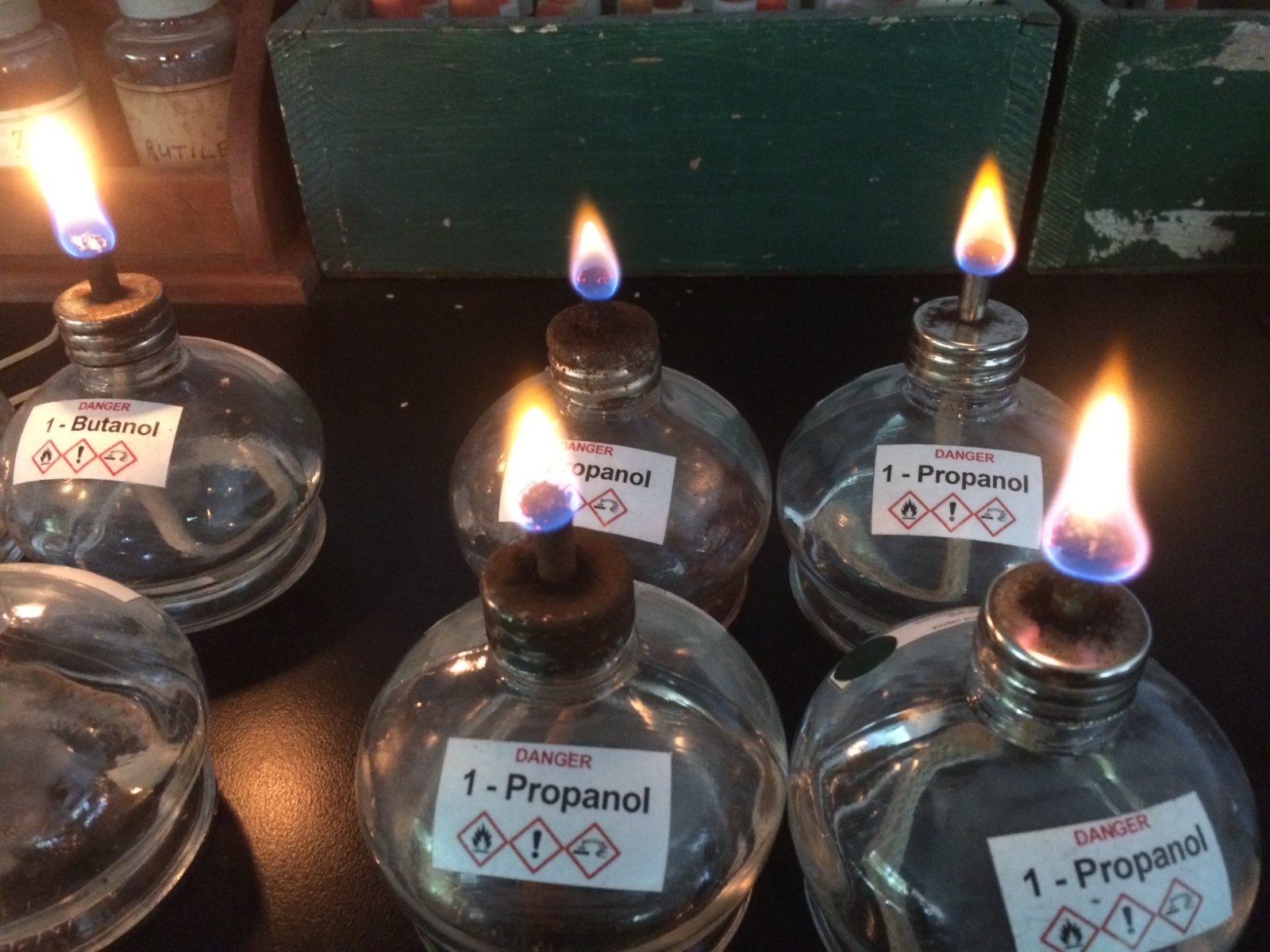

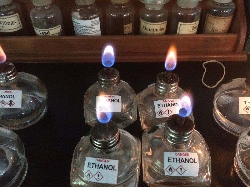

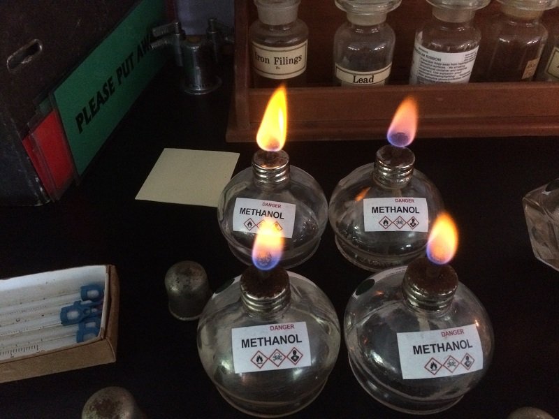

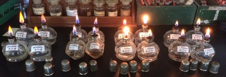

I was setting up some spirit lamps at work today and I thought I'd take some pics as recently there was a mention of checking for methanol by the colour of burning it .
I had to set up 4 x lamps with Methanol , Ethanol , Butan-1ol or 1-Butanol and propan-1ol or 1-Propanol .
Here's a close up of each .

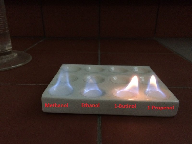

Then I thought , OK does it look the same if you burn them on a spoon .So I set a few drops in a well plate .
The results are completely different to the spirit lamp test .The Very yellow looking Methanol flame on the burner is a very blue flame with no sign of yellow at all . If you look at the tip of the Ethanol flame you can see a slight yellow tinge .
And remember that these are pure alcohols . I don't recon anyone could guess what was in their spoon off the still :crazy:

What has been used to fuel those lamps before hand?
The wicks could have residue from previous fuels.

Also, when burning a substance with a wick, also the wick is burning I suppose, even though slowly.

Saltbush Bill wrote: ↑Mon Aug 19, 2019 12:25 am Nice work Yummy :thumbup:
They are the same year after year Salty ...for that reason ....no cross contamination .
Birrofilo wrote: ↑Mon Aug 19, 2019 12:44 am
I think this has a lot to do with it . But it sure is interesting how the Methanol can go from a yellow with a wick to a blue on its own .

My take from all this - don't trust your life to be able to tell the difference based on a flame test when adulteration is usually a deliberately poisoned mix of ethanol and methanol not pure methanol. I know what comes from my own handiwork and at least here at home feel reasonably safe drinking commercial spirits. But otherwise........

The only thing i've ever been able to deduce using the "flame test" on product taken off the still was a rough gauge of proof. A tall blue flame with a pronounced gold cap that leaves the spoon dry is gonna be 85%+, the more tall and pronounced, the higher proof. A lower blue flame with little to no gold cap leaving water behind is below 75-80%. Approximate test at best and no indication of contamination unless it's really burning an off color.

Good place for it Salty . And more evidence that the flame test is useless.
