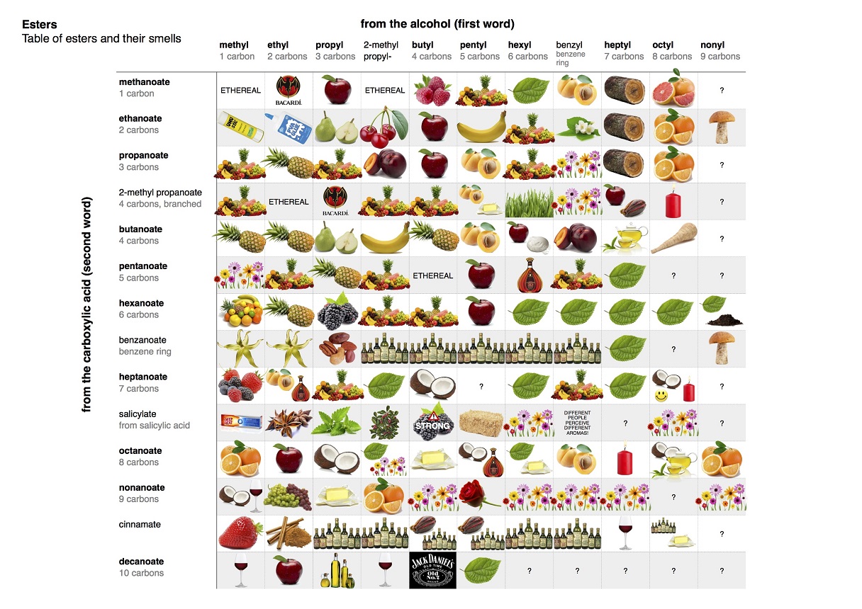

This chart is pertinent to these experiments:
Will see how this works out, am cooking/heating up slowly to allow the formation of esters from the heptanoic as well as the waxes naturally occuring in panela sugar, not to mention whatever shall come from the infection via the added dunder, and esters created from the EDV and high ferment temp.
I read, I write, I still.

Firstly, for purpose of expediency these are the carboxylic acids I've been referring too so far and will be in this post that I've acquired to date. As you can see two are salt form, one is liquid. For reference if you add water to the salts, they will convert to the acid form; I've yet to research how to mix and properly create a 98% solution acid from these salts, but that's for a near-future project.
For today's experiment I had on hand the following:
Sulfuric acid 98%
Feints (heads and tails)
.2 ml disposable plastic droppers
Set of 3 500/250/100 glass flasks
Squares of tin foil
Handheld torch
Steel cooling rack
The three carboxylic acids (octanoic, butyric, heptanoic)
Procedure was as follows:
Place the cooling rack 1/4 over the sink, creating a platform to heat on. Wrap a square of foil around the base of the 100ml flask, protecting it from scorching/black. For salts, place 1/4 a capsule into the 100ml flask, for liquid, place .6ml of acid into 100ml flask. (Flask was rinsed in between and washed)
Following the introduction of the carboxylic acids, I then add .2ml of sulfuric acid into the 100ml flask. Then I add .75oz of feints, or fill the 100ml flask to about 40%. Then I place the full 100ml flask atop the cooling rack over the sink, and apply the torch until the liquid begins to steam and bubble. I let the steam subside, then I smell the flask carefully.
Results:
Heptanoic- berries, over-ripened peach, and lightly a hint of tropical fruit/exotic fruit smells, but mainly this is a 'mixed berry' punch, like mixed berry yogurt smells
Octanoic- citrus and apple juice, not orange but tang, it smells like freaking tang mixed into apple juice; I was hoping for butter notes, but at least this one worked too
Butyric- pineapple and maybe pear, it was a lot of pineapple, but maybe a bit sweet for pineapple which is where I think pear may have come in, the pineapple was overwhelming
So - SUCCESS!! The next step is making solutions for the two salts I have so that I have liquid versions of all 3 acids that are as pure as the heptanoic I have. Then I intend to run trials to figure out consistently the dosing for scaling purposes. It would be a lot easier and less frustrating to do it this way than via my thump and cooks! I will try and figure out via this flask and heat method how much acid equals how many esters/ester density. I'm not sure how I'll do this without a way to calculate/measure esters in gr/laa... But the end goal is to be able to craft custom, intentionally made and flavored rums (or ANY spirits) based on controlled introduction of specific amounts of various carboxylic acids into my thumper prior to the cook so that the esters are strong and present throughout the run, not just in the heads.
Even that Jamaican 'funk' is simply an ester coming from a carboxylic acid, so if I'm able to procure more of these acids in their pure or salt forms, eventually I'd even have no need for infected dunder unless I was making purposeful infections to obtain the top part of the chain of the ester charts via bacterial activity in my wash to prepare for the combination with my carboxylic acids. But this line of scientific distillation inquiry has me deeply excited!
