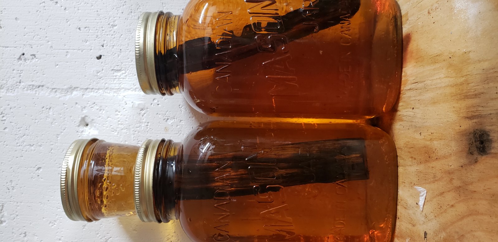

GreenEnvy22
Posts: 198
Joined: Thu Nov 14, 2019 3:25 pm
Re: NChooch's Carolina Bourbon
Post by GreenEnvy22 » Mon Apr 20, 2020 5:03 pm
This is what mine looks like after 2 months in new mini barrels (2L and 3L).
I transferred to 2qt mason jars and put in an oak stave I made from an old wine barrel stave.
