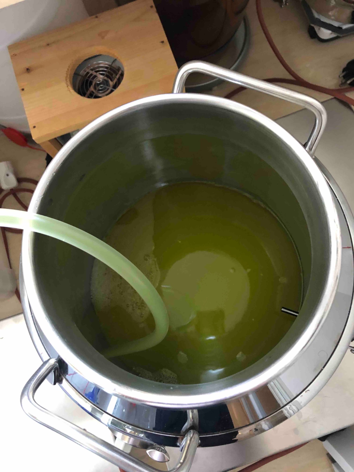

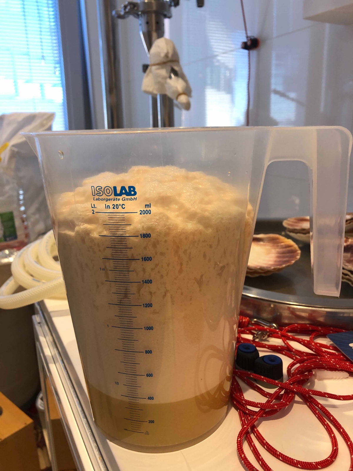

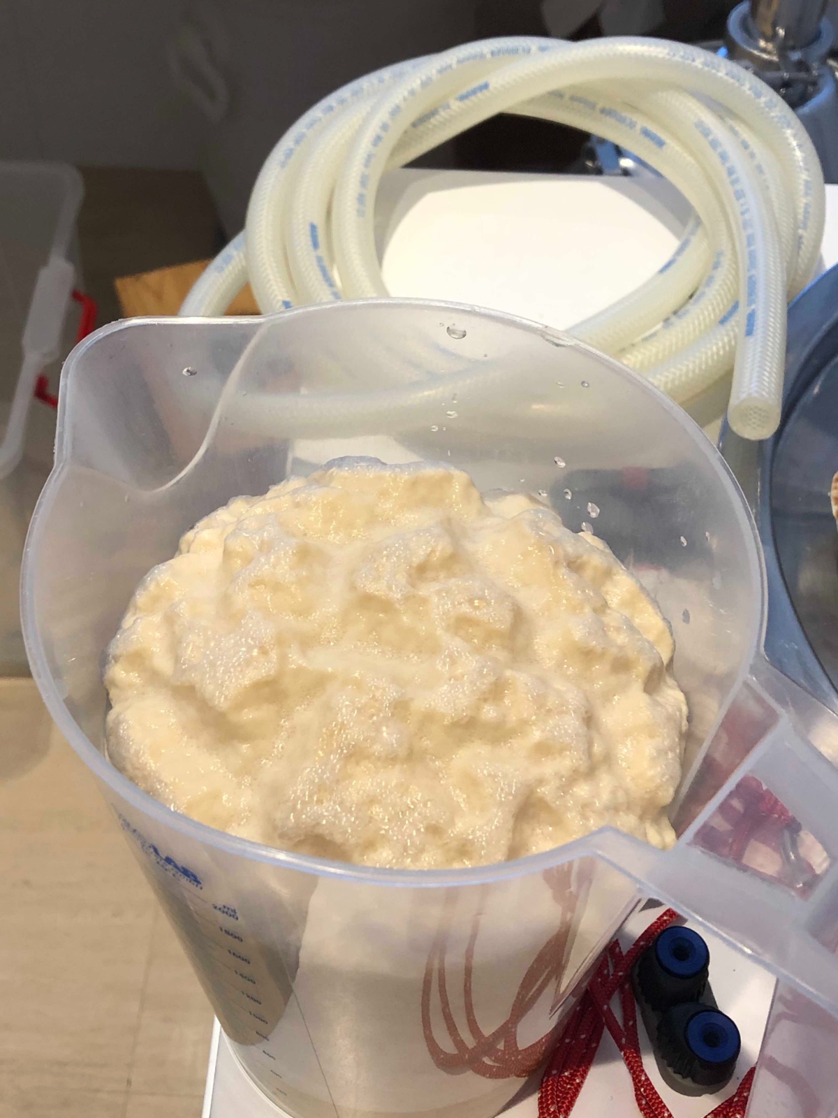

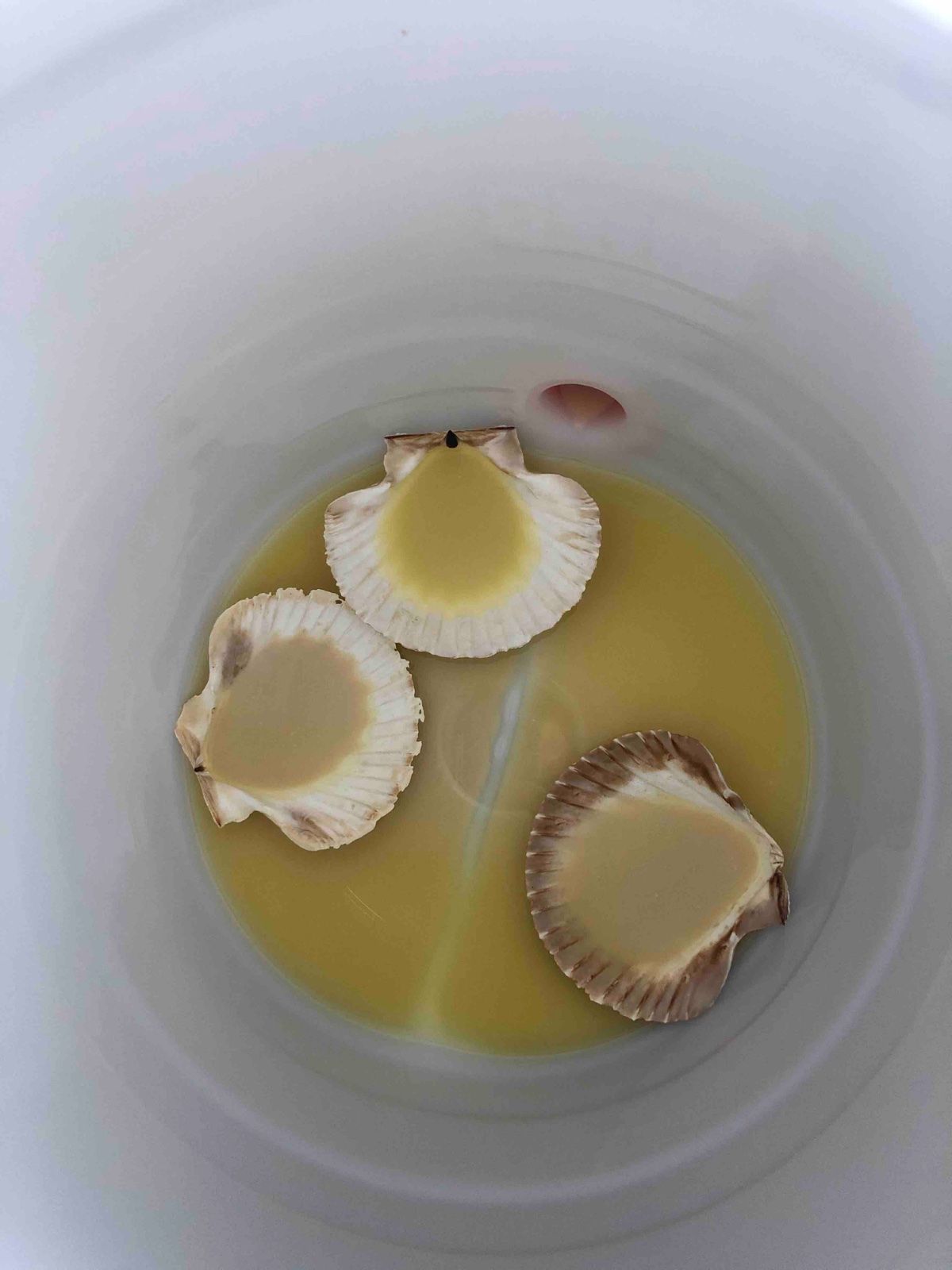

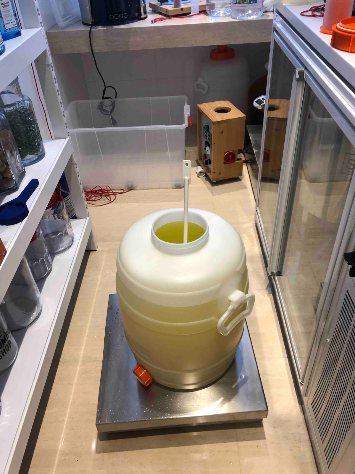

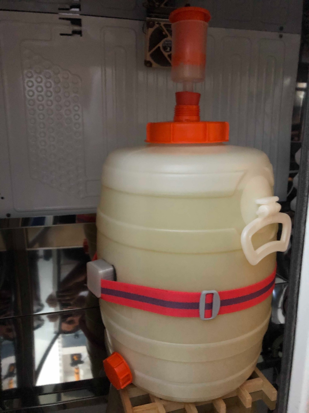

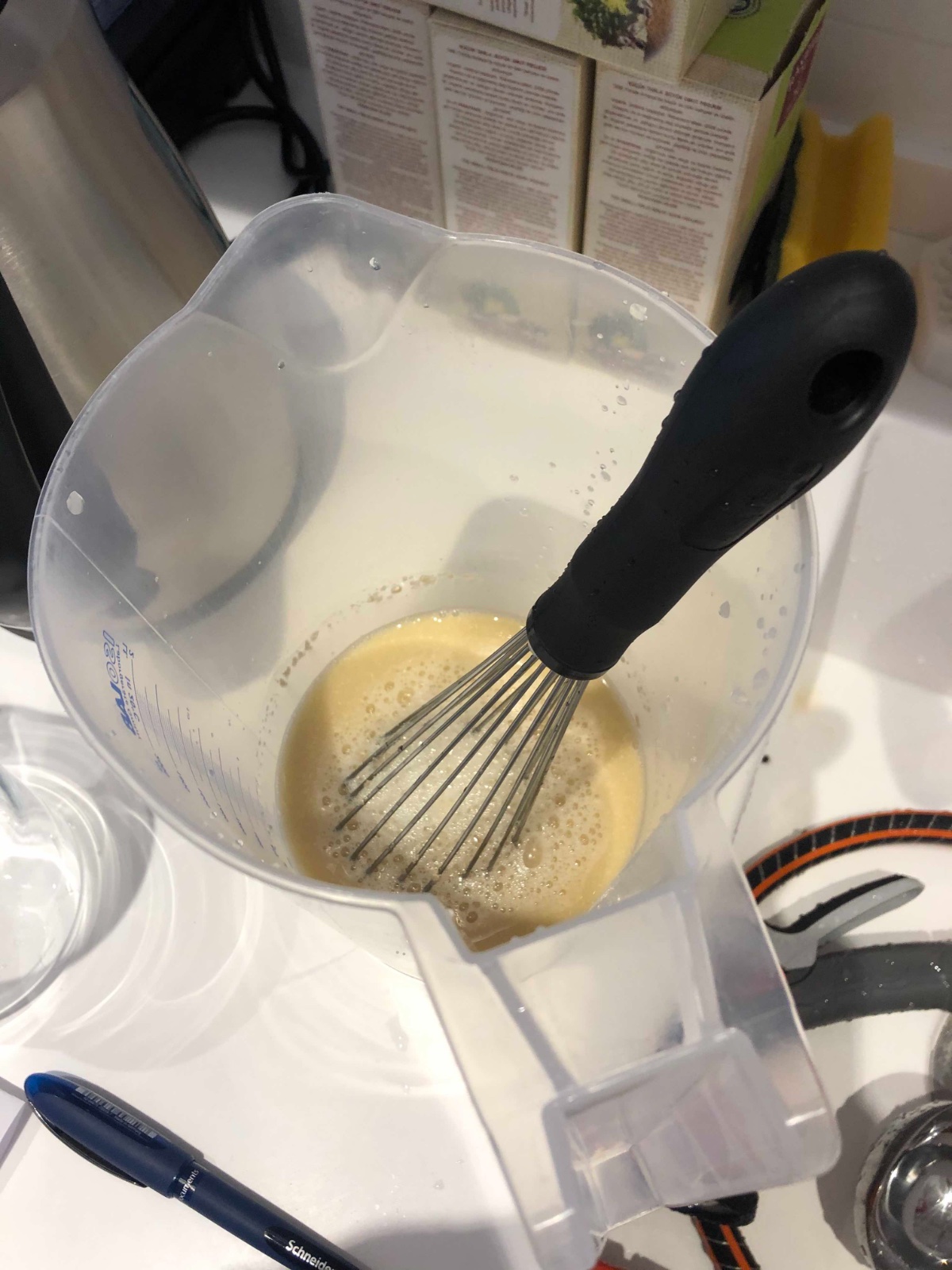

Hi,

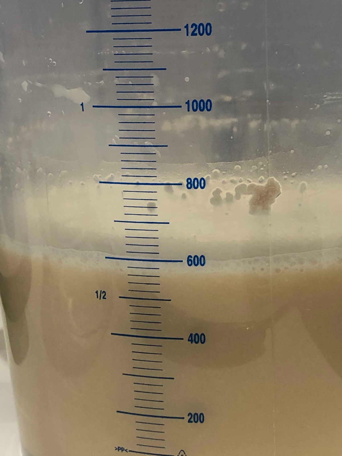

After a 2 year brake from distilling, yesterday I started my first fermentation with this recipe, I also use Vitamin B and Epsom Salt also I use 3 big whole scallop shells to act as a buffer which I usually do, they weigh 7.20 ounce. Most of the time, once I finish mixing up everything I take back 17 oz to a measuring cup and pitch the yeast on top of it and wait 30 minutes, during this time, as you could see in the pictures the yeast starts to activate and fill the measuring cup to the top, once it reaches there I put it right back into the fermenter, so by doing this way, it is more or less acts like a starter, and the fermentation starts very quickly, one thing that I have to mention is that, the amount of yeast seemed quite low compared to some other recipes out there, but everything is now looking very good now, it started yesterday and today the room filled with a nice smell, thanks shady for this great recipe I will give more details along the ways, Pitching temperature of wash: 75.2 F and OG:1.070 and I am fermenting it@86F.
- Posts: 9750
Re: Shady's Sugar Shine
Good to see you back Artooks, god you were a handful as a newbie..lol
Great photos, nice to see you putting back into the hobby.

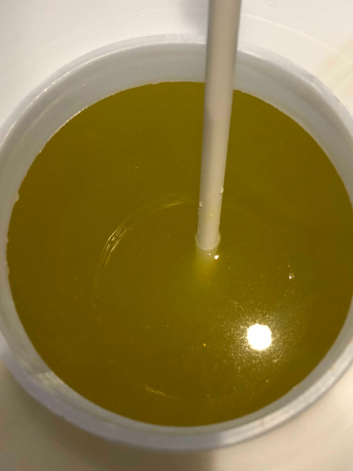

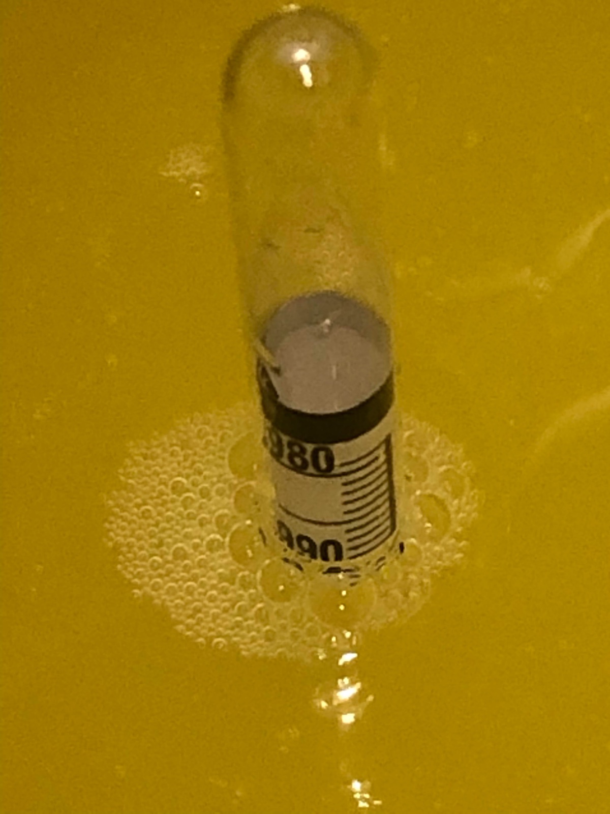

Today, after 5 days and 17 hrs, the fermentation has finished. I can proudly read FG: 990 Again thanks for this great Sugar Shine Recipe Shady, there are many good things that I should mention. But before that I would like to say that the whole scallop shells are also working, tomorrow I will distill and will weigh the scallops to see how much of it is consumed, so today when I opened the lid of my fermenter, oh my god what a lovely smell that the wash has, It really is very good, Also what was interesting for me to see that how less yeast is used in this recipe, I must admit that, I was not expected this recipe to complete with this much yeast, reason being normally recipes call for almost three times of this amount, so that was something new for me, and overall I must say that this recipe calls for less ingredient and it is very economical in that sense, so now I will let you all know once I strip and reflux this wash. Thanks Again Shady this is a Great Recipe.

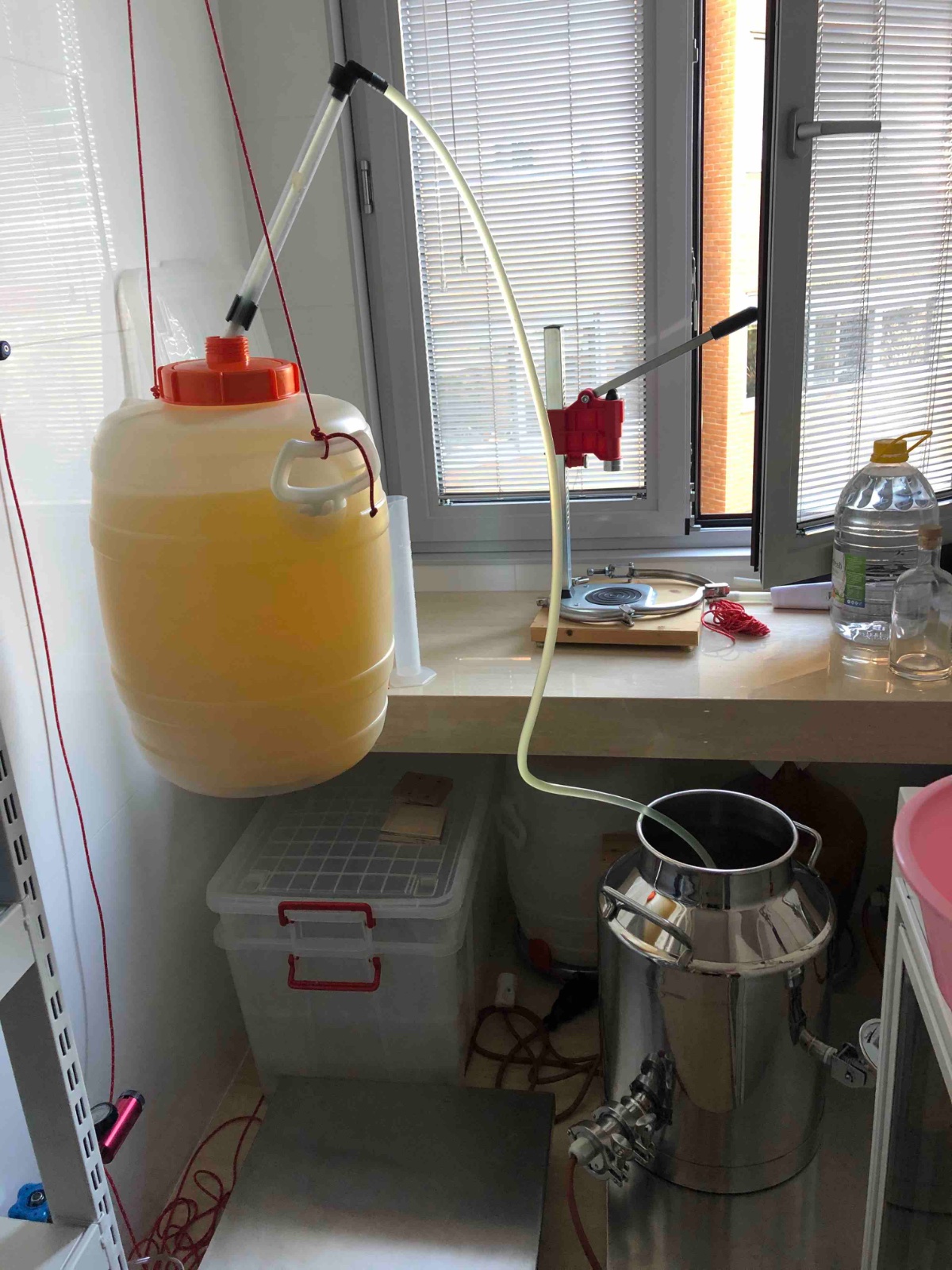

Today I did my stripping run, and it still continues at the time of writing, once I transferred the wash to my boiler I weigh the scallop shells and find out that the shells lost 60 grams ( 2.1 Ounces) I also checked the PH of the wash which was 5, so this basically tells me that the scallop shells did their work, so for and 8 Gallon wash 2.1 ounce of scallop shell is consumed, tomorrow I will be doing my spirit run, wondering how it will be turned out, I am very curious about the flavor we will see. Also what I would like to mention is that, because the amount of yeast used in this was is so little the sediment was also very thin which helped me to get the most of the was only 0.5 litre remained. So far so good.

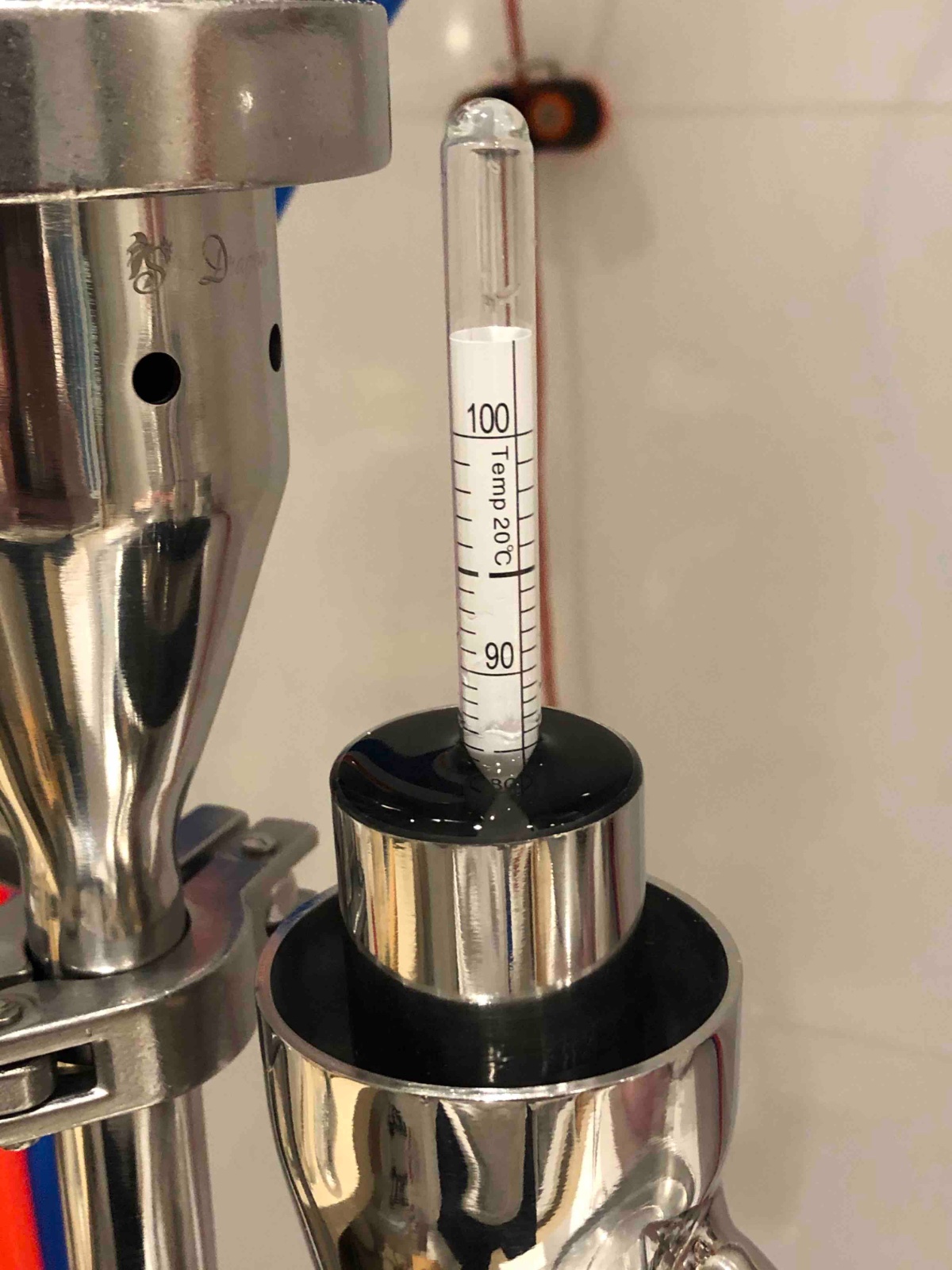

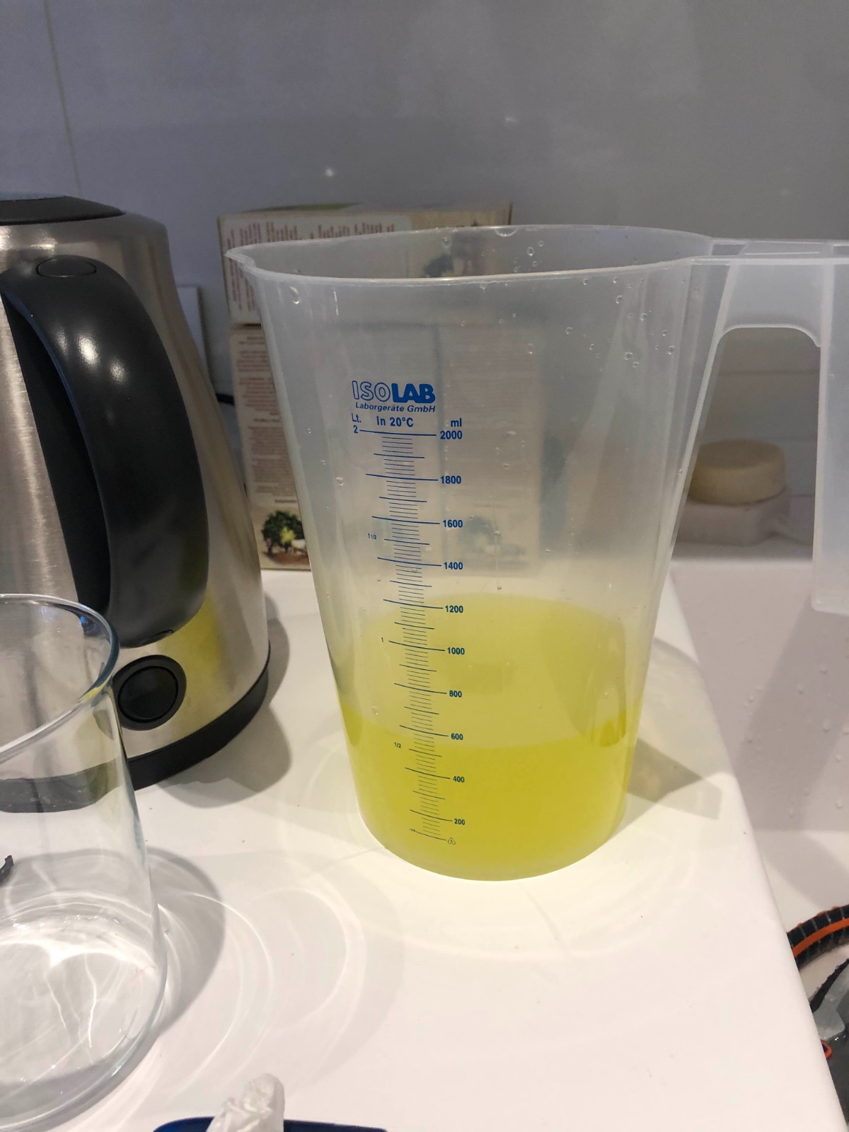

Today I did my spirit run with my CCVM I had some problems, I hope you could help me with that, to begin with I have a small boiler for my spirit run 3 Gallon which I mainly use, so I had 1.32 Gallon of %55 ABV Low Wine, so I add another 1.32 on top of it which lowered my ABV to %27.5 so in total I started with 2.64 Gallon at %27.5 ABV, My Column is 36" long and as packing I used from bottom to top 2 copper mash + 18 oz copper saddles + 1 copper mash + 11 Oz Raschig rings + 1 copper mash + 13 OZ SS Saddles, and that was it, in my new house unfortunately I do not have a tank to place so I had to use tab water for cooling I had thermometers so the cold water goes out at 64F and comes back from the reflux at 108 F, anyway I started the still at 2800 Watt and within 17 minutes I started to see condensation in the sight glass so I was at full reflux for 40 minutes at 900 watt the I started to increase the RC for 1 inch started to collect foreshots, the Alcohol at first was coming at 94 ABV then once I increase the RC by another 1 inch and increased the power to 1200 the ABV dropped to 90, I read ton of CCVM runs but I do not seem to get running it at RC completely open and with increased power to 12OO watt the without losing from ABV, and the distillate came different as well, so when I taste it it had a bitter and minty taste to it I remember it because the same happened to me when I did Birdwatchers, so I cannot seem to do it correctly, this is definitely my mistake so after starting the hobby again, I had some problems, so my questions are:
1) When could I possibly done in the fermentation to get a bitter and minty product ?
2) the reason that the ABV was not high was it my new cooling lines that I use from tab water, with tab water the water always come cold and maybe could it be that it was too cold and not tepid that I faced this problem, or should I use different packing material to reach this goal ?
I was really discouraged to face a problem like that, but I believe that I will find the problem and solve it. Thanks
