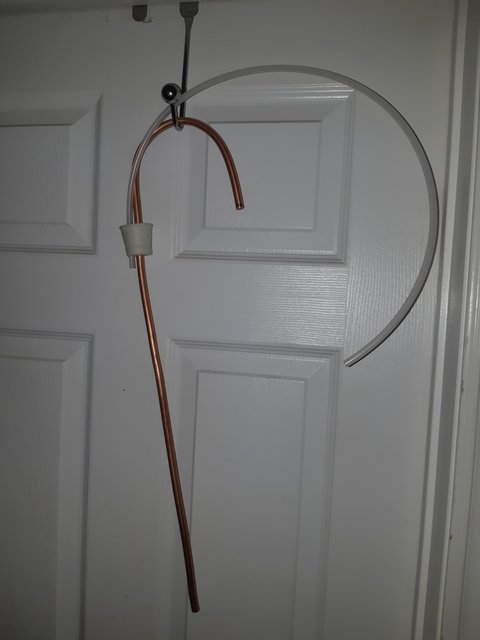

Your suggestion combined with Demy's lead me to this.
Used a bung, drilled a 2nd hole for an air inlet tube.
Is this what you mean?
Force air into inlet tube, and likker will flow from the racking cane?
Cheers
Yes, it is one of the methods that has always been widely used, there are many. The basic principle is that by blowing into the (transparent) tube, pressure is created in the container which will make the product flow into the copper tube. The disadvantage of the method is that you have to create some pressure with your mouth, alternatively use a tool that does it for you (.... like inflating the tires). I wanted to build a kind of self-siphon in copper or stainless steel but I haven't collected the ideas yet ...
