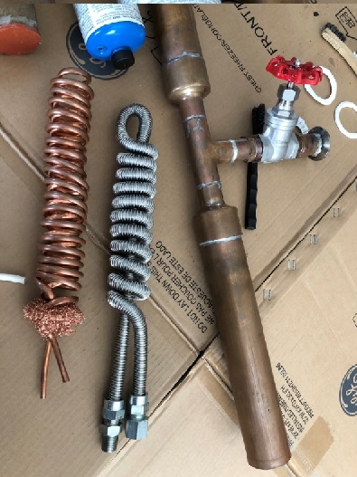

I have never ruined one, not even the first! Plastic hose and a hose clamp fit the ends perfectly.

If capable of knocking down all vapor, no coil should need a cap.
I get these SS Gas lines very cheaply and have never kinked one. I have even coiled one, and straitened them out to change the length of end pieces.
After having used this for years, the SS Scrubbie at the top is more to keep bugs out!
They make great product condensers also! Put a 1/2" x 60" SS Flex Line inside a keg spear for a product condenser that will handle 4,500 watts. 1/2" hose pressed over the ends and hose clamped.

Heck no! That is a stainless braid over a rubber hose! You want a line for natural gas not gasoline... Go to Plumbingsupply.com and check out Gas Flex Connectors. You will see what he means. It is section of corrugated stainless pipe. They have precut sections with fittings on the ends. Heck, Home Depot probably has some but if they are Brasscraft brand they are powdercoated yellow and you don't want that either. If you go generic with hose clamps like DAD did you can buy the brand name Gastite or Armaflex but you will probably have to buy a large section.rager wrote:so this ?

More like this...http://www.ebay.com/itm/DORMONT-20-3132 ... 1c378ff9fe" onclick="window.open(this.href);return false;" rel="nofollow
I have bought the yellow painted stuff and burnt the coating off...but better to look for the uncoated. Some ACE hardware and the HVAC stores sell it by the foot. I've gotten the uncoated 1/2" o.d. x 60" for as little as $3usd each. And I paid $12usd for a 5/8" o.d. x 48" piece.
The 1/2" o.d. can be coiled to fit in a 2" pipe easily or a twisted loop of the larger works.

You could also get Gastite and cut off the outer cover, but you'd be wasting money on that outer cover.
http://www.gastite.com/" onclick="window.open(this.href);return false;" rel="nofollow
It's $3.25 a foot here: http://www.ebay.com/itm/1-2-1-2inch-cor ... 0621596796" onclick="window.open(this.href);return false;" rel="nofollow

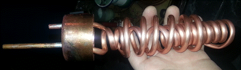

here is my first attempt at winding a double helix coil for my bokabob still. no kinks,
Re: Easy coil condenser
Welcome to HD, did you wind the coil freehand or follow one of the tutorials using a pipe to wind around?
I tried both the winding 1/4" copper and the corrugated stainless gas line. Wow, is that gas line easy to work with! The corrugations allow vapor to pass even when the windings fit tight against the inside of the 2" copper condenser housing. I did the double wound copper on a 1" OD pipe per several posts here, but flattened the tubing enough that it really restricts the flow. Used a 60" long stainless 1/2" OD (3/8" ID) gas line to wind a coil and it couldn't have taken me more than a minute or two, and zero kinks. I think the gas line is the material of choice for a reflux condenser.
