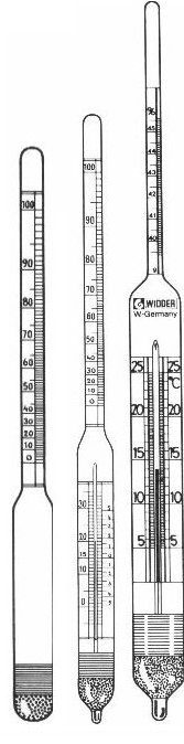

The following picture shows different types of alcoholmeter, with or without inbuild thermometer:

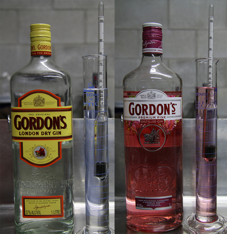

I've just got my kit and am playing with things while I'm (impatiently) waiting for the wash to finish. Tested the alcoholmeter on the sloe gin I made last year. It reckoned it wasn't alcoholic at all so I did another reading on a commercially made gin, realising that the sugar content would knock off the readings. The bottle says 37.5%, meter says 14%. Can meters be that inaccurate or is it more likely user incompetence? The glass test jar was clean and dry, I spun the alcoholmeter, took reading from lower edge of the meniscus. How hard can it be?!

While (very) cheap alcoholmeters can be off a little it's highly unlikely it should be off by so much.
Take a clean glass and fill it with water then put the alcoholmeter in like you did. The reading should be exactly 0% at room temperature.
Most meters are calibrated to 20 C which would be 68 F. It likely the calibration temperature will be stated on the printed part of your meter.
Any kind of product that contains unfermented rest sugars will throw off the reading. Gin wouldn't be a product I would expect to do that.
Most commercial distilled gin would have a neutral spirit as a base spirit and that won't contain any sugars per se.

Thanks Danespirit,
I've now rechecked various spirits as well as water. Most seem to be ok so the problem with the sloe gin must have been the quantity of sugar added! Interestingly, the commercial gin I tested yesterday as a comparison (Gordon's Pink gin) is still registering as 20% but the bottle says 37.5% There's maybe something else altering the reading or I've got a dodgy bottle!

Gordons Pink Gin is artificial trash. You're measuring all the additional sugar, flavouring and colourant.

Yup, it just happened to be in the house. I'm waiting on my first wash finishing so I can learn to make a better alternative!

This wee experiment has highlighted just how much "artificial trash" is actually in it! Quite interesting...

That tallies with my readings
It's pretty interesting as I hadn't expected a professional product to vary so much. Hadn't realised how far from a 'proper gin' it is!

This test is very popular with the rum crowd. It's a dead giveaway when a 'premium' rum has been altered with added sugar or worse.

Added sugar will always alter the reading.
More than likely it's what has been done to the gin in the picture.
It would be interesting to know if color additives have a similar effect even if they are not based on glucose...?

Apologies for bumping an old thread but I'm having a very similar problem with sloe gin, but one that I haven't added any (extra) sugar to yet...
So my base gin is my own 45% ABV (on an alcoholmeter) London dry style gin (so no sugar or other flavourings added post-distillation). I've had a few litres of it macerating with some sloes for a few months. The method I'm using is to add a sugar solution to it (to taste) *after* macerating, so it hasn't had anything added to it yet. It's just gin and sloes.
As I said, when the sloes went in it was at 45% but I've just tested it now and it's only registering as 10% now. I'm assuming it's the change in density, rather than sugar that's throwing it off...
How can I accurately measure what it actually is in it's current state and, also importantly, what it's strength will be once I've actually added the sugar solution?
- SaltyStaves
- Posts: 1117
- Joined: Sun Jun 14, 2015 5:18 pm
Re: Alcoholmeter
If you didn't weigh or measure the berries, then you can't. You'll also subtract a bit of water/alcohol when you remove/filter them too. You'll just have to guesstimate.LondonCalling wrote: ↑Tue Dec 01, 2020 2:35 am How can I accurately measure what it actually is in it's current state and, also importantly, what it's strength will be once I've actually added the sugar solution?
LondonCalling
- Posts: 18
- Joined: Sun Nov 08, 2015 6:00 am
Re: Alcoholmeter
Yep, weighed the sloesSaltyStaves wrote: ↑Tue Dec 01, 2020 2:58 amIf you didn't weigh or measure the berries, then you can't. You'll also subtract a bit of water/alcohol when you remove/filter them too. You'll just have to guesstimate.LondonCalling wrote: ↑Tue Dec 01, 2020 2:35 am How can I accurately measure what it actually is in it's current state and, also importantly, what it's strength will be once I've actually added the sugar solution?
So do the commercial distilleries guesstimate too? Would have thought if they put the ABV on the label, as is a legal requirement in most countries, they'd have to be able to know this as a certainty before bottling...
LondonCalling
- Posts: 18
Re: Alcoholmeter
Also, just had a thought... if I know it's technically still at 45% but reading as 10% on the hydrometer, if I dilute it with water to read 5.5% will that mean the true ABV will now be around 25% (the sipping strength I'm after)?
- Posts: 11628
Re: Alcoholmeter
If its 45%abv and you dilute it by 50% with any other liquid by volume.....water , sugar syrup....mercury or liquid fertilizer it will then be 22.5% abv.......you dont need a Alcometer to do it, a couple of accurate measuring jugs will get you there.
By the way you Dont use a hydrometer to measure ABV.....you use a Alcometer, they are two different tools for two different jobs.
- Posts: 10370
Re: Alcoholmeter
Dilute by volume, not density. I would first assume the %ABV has fallen since maceration, that is, it’s not still 45%ABV. I’d “guess” it to be closer to 35 to 38, due to the juices from the sloes. So, you can use the dilution calculator for the amended %ABV. The hydrometer is “worthless” now.
Commercial distilleries use chromatography to determine alcohol content for BATF label requirements. You could pay a lab to analyze it for you, but is it really worth that? At this point, it’s really about making something you like, not what the alcohol content is.
