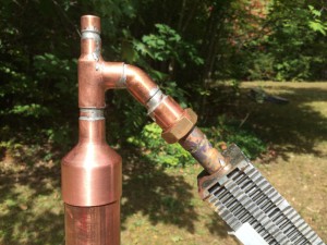

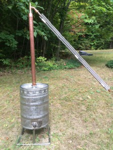

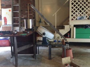

So, I've been thinking some more about the air-cooled condenser lately, just throwing ideas in the pot and stirring.
The first couple of experiments that I've seen involved building a cage to attach CPU fans directly to the fins. The other design that caught my eye was the one with the fins mounted directly to a box fan. I still love that idea, but the numbers people were seeing seemed kinda low to me -- I'm using one of those laser temperature guns, and I'm seeing temps drop pretty drastically, as high as 20 degrees F over a span of ~6 inches, especially right over the fan. Then again, I'm only running a 3/4 column right now.
I was looking at my rig today (for hours, doing a spirit run) and realized that my fan is 8-10 inches away from the fins. So there's a big channel of cooler air to blow over the fins, especially compared to the CPU fans that are attached to them -- they're more likely trying to move a small volume of already warm/hot air, versus this big box fan, which has cooler air between it and the fins to push.
At any rate, I've got no desire whatsoever to build a liebig or any other water-cooled condenser. This thing is just so dead-simple, with no water to cool, hoses to kink, pumps to buy, etc. I can't wait to see how it works coming off the 2" column.
Another thing that's been drifting through my head, and is more an experimental oddity than something I'd suggest others try... I've got a 3' length of it just sitting here collecting dust. What I've been considering is adding it to the top of my existing 3/4 column and blowing a fan at it to see if it will create reflux, and how much it might raise my ABV.
Again, not pursuing some crazy new style of still, but now the question is in my head, so I'll try to work out a good way to measure the effect it might have, and maybe one day actually give it a shot once I have my 2" column up and going on the keg.

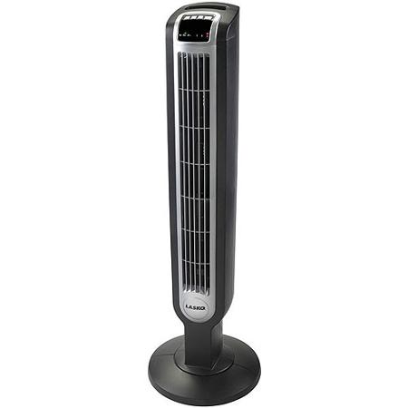

Postby Wooday » Mon Sep 07, 2015 1:05 pm
next level
Strap this underneath for more even air flow?
Wooday
Posts: 226
Joined: Tue Jun 02, 2015 7:14 am
Re: My Journey
Postby raketemensch » Mon Sep 07, 2015 2:23 pm
wooda2008 wrote:Strap this underneath for more even air flow?
OMG IT'S OSCILLATING WE'RE ALL GONNA DIE :esurprised:

Postby Deerhunter » Mon Sep 07, 2015 3:15 pm
Is that vapor coming off the end of your condenser? Its seems like that from the pic. If your running indoors I would be very concerned about filling that room with alcohol vapor.

Postby raketemensch » Mon Sep 07, 2015 3:20 pm
Deerhunter wrote:Is that vapor coming off the end of your condenser? Its seems like that from the pic. If your running indoors I would be very concerned about filling that room with alcohol vapor.
Heh, I hadn't noticed that, it's actually a ball under the garage stairs in the background. It's out of focus, so the blurriness makes it look like vapor. It was about 85 in the garage today, and the condensate comes out at a stable 75-80.
Even knowing that, since I'm still getting started I'm running in the garage with the doors open for ventilation. I want to be all practiced up for running in the basement this winter.
Thanks for the good eyes, tho. :shock:

Postby Deerhunter » Mon Sep 07, 2015 3:38 pm
LOL, talk about trick photography. Your right is a ball. Sorry......but that really look like vapor.

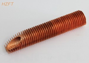

I also just stumbled onto this, I guess finned copper is now a thing in solar production:
http://www.spiralfinnedtube.com/sale-38 ... stems.html
I'm sure it's ludicrously, prohibitively expensive, especially for what would most likely be wasted effort, but interesting to look at anyway.

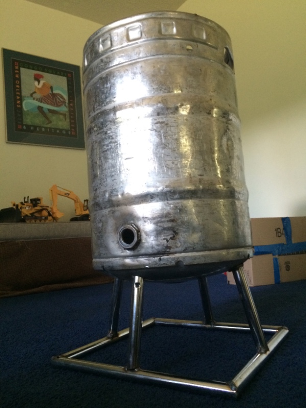

So, this week I finally got the hole cut in my keg for the heating element. I don't have a mapp torch, and I've spent too much money already, so I'm waiting for a friend to get home from vacation to borrow his so I can solder on the stainless nut that I ordered from China. I spent $25 on a stainless "conversion plate" that is too deep to accept a bent (low watt density) element, so in the end I'm using a $2 stainless nut. I should've just gone that route in the first place.
Cutting the hole in the keg was not a pleasant or quick experience. I kept the SS cool the whole time, with a drill in one hand and a spray bottle of water in the other, but it still took forever, even with a diamond holesaw. Over an hour, at least.

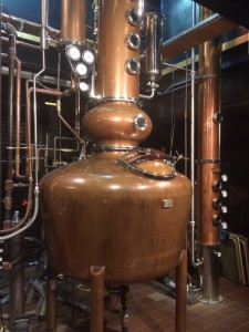

We went to a restaurant and microdistillery in Agawam, MA last night after riding the coasters @ Six Flags for our anniversary. Yup, I picked a good one.
Anyway, I took a few shots of the still. Their booze still needs work (and made me feel much better about my own), but this thing was gorgeous:

Postby kiwi Bruce » Sun Sep 20, 2015 2:16 pm
What a freaking BEAUTY !!! Two nice pic's too.

Postby raketemensch » Sun Sep 20, 2015 2:23 pm

kiwi Bruce wrote:What a freaking BEAUTY !!! Two nice pic's too.
Yeah, it really was. I didn't get a shot of the mash tun, it was a nice piece too. They serve their own rum and vodka. I didn't taste the vodka (not really my thing, and not for sipping anyway), but the rum was OK. It was white, which also isn't really good for sipping, IMHO. I wish they did a dark, too.

Here's a shot of the keg. I can't find an angle that really captures what makes it look interesting in person:

And here's the whole thing assembled, with the element installed:
I feel like it took me a really long time to get here, but it was worth it. My wife is doing one of those mud run/endurance things on Saturday, so I'll hopefully get to the cleaning runs on Sunday.

Postby Wooday » Tue Sep 29, 2015 9:10 am
raketemensch wrote:...I feel like it took me a really long time to get here, but it was worth it.
You started this topic less than a month ago. Blink of an eye compared to how long you'll be enjoying this hobby.
Hell, my "next step" probably won't be for 6 months.
Keg looks damn good
