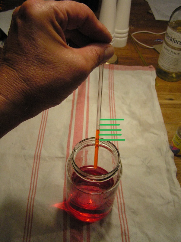

Recently , I come up with a much improved method which makes repeatability of samples during cuts much better and it also eliminates another major issue encountered when making cuts ....Getting Maggoted :oops:
And while a few teaspoons seems good at the time , 10mls becomes 50mls becomes 200mls
This new method means only about 1ml - 2mls per sip ...enough to make a reasonable decision but not so much as to impair decision making when many samples up / down through the jars needs to be made.

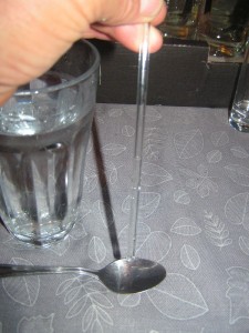

So here it is ....my glass tube
Coloured water added for clarity
Well big woop you say :wave: ....maybe ...but it works :thumbup: ...and its quick as to use .
Its just a piece of glass tube about 4mm in diameter with about a 2mm hole up its clacka .
Sure , you can use glass syringes and pipettes and the like but they are sooooooooo fiddly and time consuming to use ...this dead easy . :D
This is what I do
1) Dip it into the sample up to the mark ....( STICK YOUR THUMB OVER THE END ........so it stays in there)
2)Let it go into a teaspoon
3)Dip it into some water up to another mark which is the ABV of the sample ( STICK YOUR THUMB OVER THE END )
4)Let it mix into the sample in the spoon ( a quick stir won't hurt )
5)Taste it :relaxed:

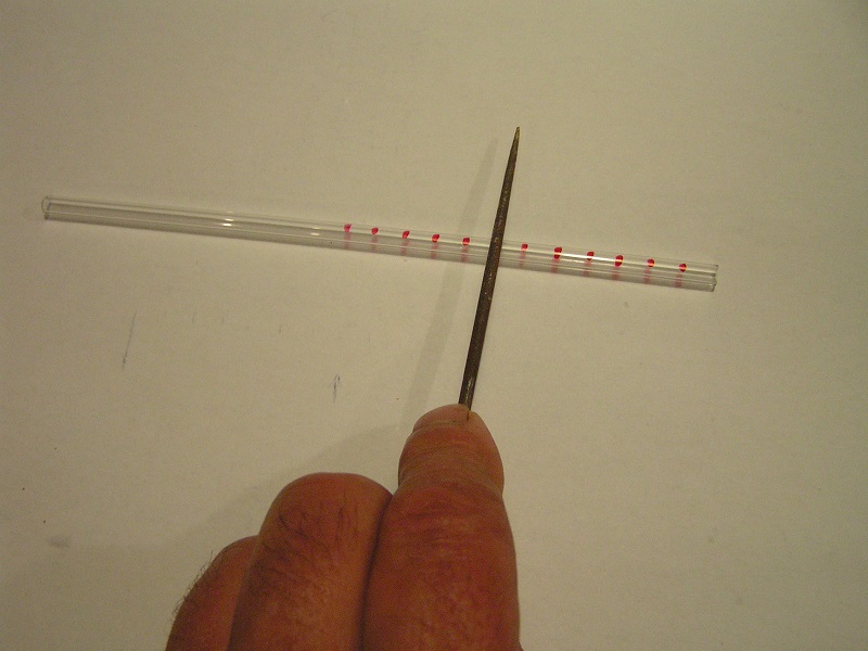

Here are the magic marks ......it just so happened to be a nice linear scale .....Yes you can choose any spacing you like , mm , 1/8" of an inch ...doesn't matter so long as you can dip it far enough into you jar . ...Just scale it .
Now I don't like Maker pen in my drink so I scored the marks I care about with a file and wiped off the Marker pen .
I have made a few ...one for when I do neutrals in the VM that are always around 95% , one for the Pot still which is around 60-80% and one for the Flute which is around 85-95%
( Just be careful not to score the tube too much as this is the exact technique used to "snap" the stuff to size.) :evil:
In-fact you don't need to score it at all if your Eye-O-Meter is good enough at repeated " rough enough is good enough Measurements " :thumbup:

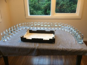

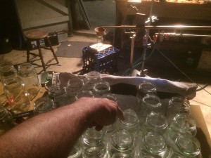

So here's my spirit Run
I'm collecting in 500ml jars .....Thank goodness we buy a lot of Pasta sauce
I have left them covered overnight to air and have them all lined up on the table .
To make decent cuts you need at least 20-30 jars .
If you only have 7 full jars ...it just ain't gonna work so well .......next time only a third fill those jars ...you gotta have choices :thumbup:

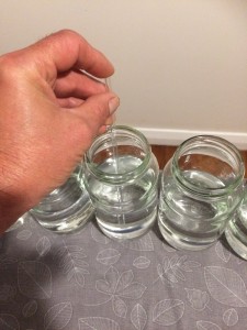

Take a sample from about the the middle jar .....Remember , dip the Glass tube up to the "Sample " position ......it is the same every sample ( only the water level varys) .....(and you don't have to be ubba anal ) .....close enough is better than a random splash in a spoon .

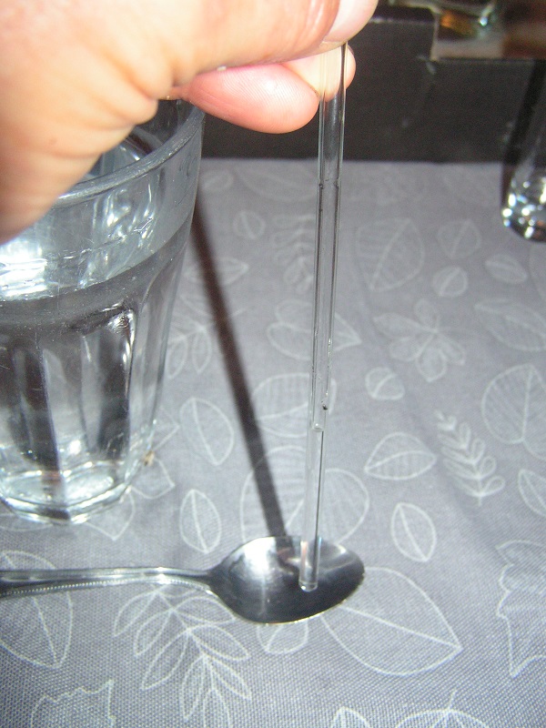

Release the sample into you spoon

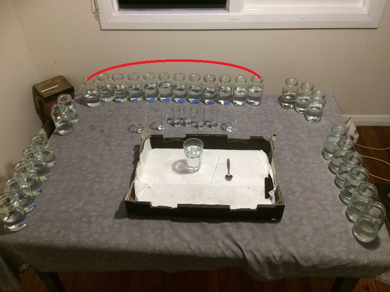

Now repeat up and down the jars

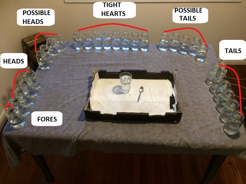

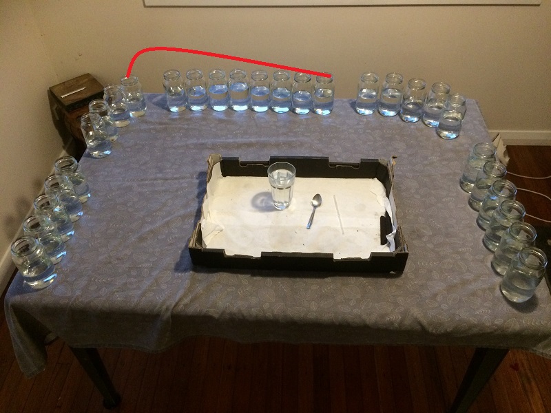

You will find a Bland tight Hearts Cut in the middle that is ...welll...boring but safe
You will find the decidedly heads section that is a definite nogo .......like wise there will be a tails section that is only fit for feints .
Then there will be a group eitherside of the tight hearts cut that you can't quite decide on and likewise a section of tailsy jars that are questionable .
When making flavoured spirits these are the tricky jars that will either enhance or worsen the final spirit .

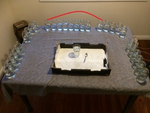

So now we enter the next phase
Setting up some blends
We need to see what the tight cut tastes like :eh:
We take a sample from all the jars in the tight hearts cut and add them to a shot glass . Then for every sample we took we add a measure of water .
8 jars , 8 hits of water . This is our reference shotty
So now we Make up a few blends ....perhaps a bit of late heads
A bit of early tails .
Perhaps you may find one jar is just wrong .......that happens .
Either way , you should end up with several blends .
Taste them , walk away and come back ....taste them again .....you will know which shotty tastes good ......because your taste buds are still working and you're not off your dial :thumbup:
Oh and this was my final cut .....its what I liked when I tasted it ...My choice not yours :thumbup:
This is what I do
Dip the tube into the water up to the ABV % mark that approximates the strength of the sample .
Add the water to the sample in the spoon ....stir if you please .
TASTE IT
Or you can just do a single run, make a reasonable fores cut (3mls per liter of wash), collect into a single container until the distillate is down to 50% ABV, drink and enjoy. No fuss, no muss. You can continue to collect past this point separately and add back to the next wash just before distillation if so desired.
Just sayin.
