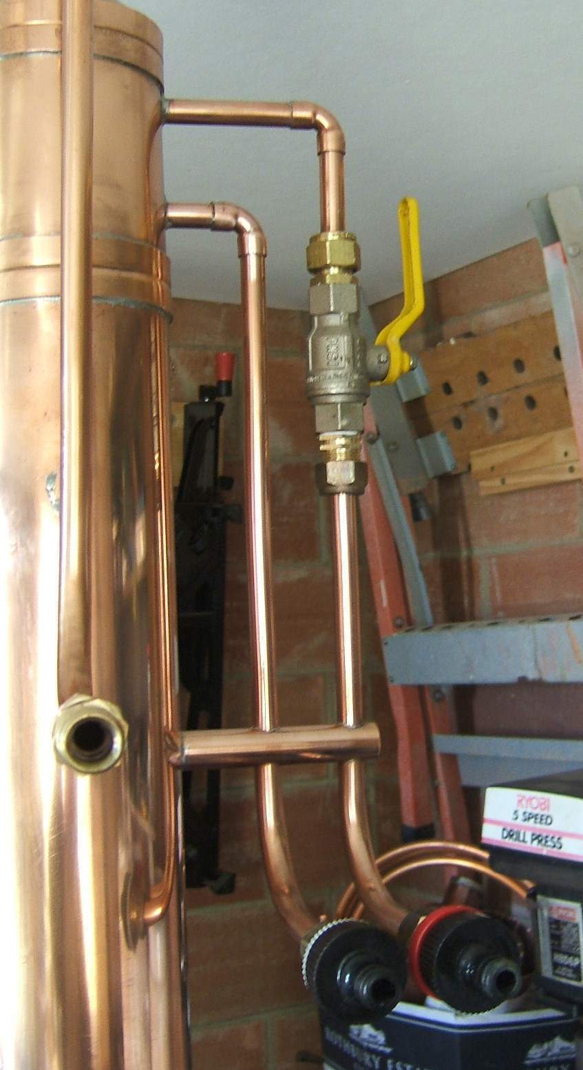

Just fitted the cooling control valve for the dephlagmater.
OD
OLD DOG LEARNING NEW TRICKS ......

Great stuff, once again beautifully executed. What are you using for a condensor? I'm was planning to run the cooling lines from the condensor(liebig) to the dephlagmator, but it appears that it would be best to control the two separately.
LWTCS
Posts: 12848
Joined: Mon Jan 26, 2009 6:04 pm
Location: North Palm Beach
Re: New still build on the way
Post by LWTCS »
Hi Hutch,
On my rig I have put together a series of by-passes that will allow for any number of cobinations for cooling. I can recycle product coolant to the dogdish condenser or run the coolant directly to each apparatus.
Also set up separate coolant discharges to more adaquately control flow rate for each condenser.
Did mine with clear tubing to help me see the water flow better. Also used plastic ball valves and barbs so assembly, knock down and reconfiguration is quite easy.
Once I dial in my prefered perameters for running my new thump tower, I may choose to install some fixed copper valves like OD did cuz it looks so friggin sweet.

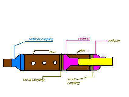

Here is what I am thinking on the way of fittings needed for the flute design with the delphlag. not including the graham condenser. point out mistakes . I hope this is close because i have the fittings on the way.. Nothing is to scale just a quick mock up
MashMan
Post by MashMan »
Hi KS, you need to invert the lower reducer in the deflag, the purple one.
MM.
Kentucky shinner
Posts: 3017
Joined: Tue Jan 19, 2010 8:04 pm
Location: Paradise? Western KY
Post by Kentucky shinner »
if I invert that one wont it restrict my vapor flow? I looks like to me you want to funnel your vapor into the 2". That is why I am posting this so i can be corrected. I am sure more opinions will be comming.
Thanks
olddog
Posts: 3618
Joined: Fri Jan 16, 2009 6:16 pm
Location: WEST OZ
Post by olddog »
You can keep it the way you have it as long as you put a drip ring on the bottom reducer to direct the condensed vapor to the centre of the column, by inverting the bottom reducer the condensed vapor will automatically be directed to the centre.
OD

MashMan
Post by MashMan »
Kentucky shinner wrote:if I invert that one wont it restrict my vapor flow? I looks like to me you want to funnel your vapor into the 2".
Thanks
considering its the inlet to the deflag, which your using to give reflux, which is going to reduce vapour volume at your condensor anyway I dont think having a less efficient entry to the deflag is going to hurt anything, it might even be a benefit by giving some turbulance from the sharp edge entry into the 2" section.
MM.

Ok inverting it is then.
