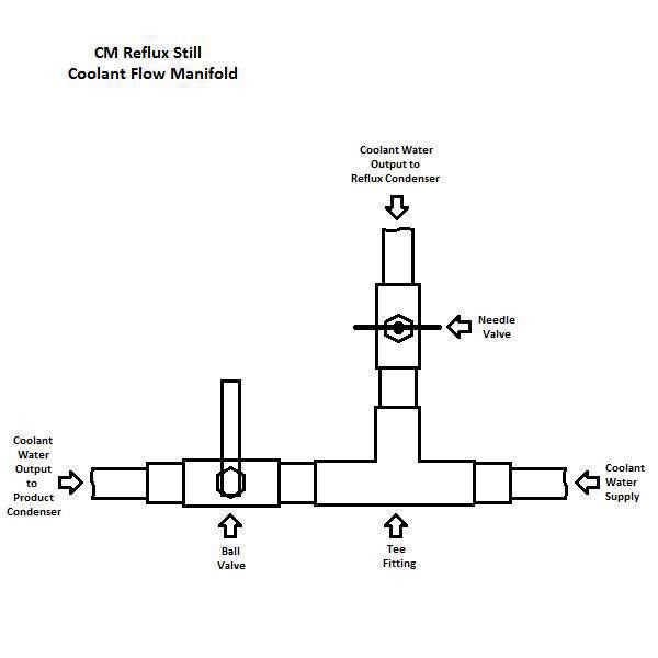

First one that should be done is to reroute the Coolant Flow. This will give you better control over the reflux ratio and product output. Basically you need to separate the two condensers. So the flow is not routed through one into the other. With the water flowing through the product condenser then into the reflux condenser. You get a temperature flux making it hard to adjust the flow. For the optimal reflux ratio and product output. By adding a simple manifold with two valves on it. One a ball valve for the product condenser. And the other a needle valve for the reflux condenser. The product condenser doesn’t need a fine adjustment. As long as you have adiquit flow to knock down all the vapors. It will work. A little extra wont hurt it. The reflux condenser however needs a fine control over the water flow. Using a needle valve gives you the fine control you need. Here is a simple diagram for a coolant water flow manifold. Based on what I use. You could make it as basic or as complicated as you like. Your choice. I use a 1/2" ball valve and a 1/4" needle valve on mine. a 3/8" needle valve will work also.

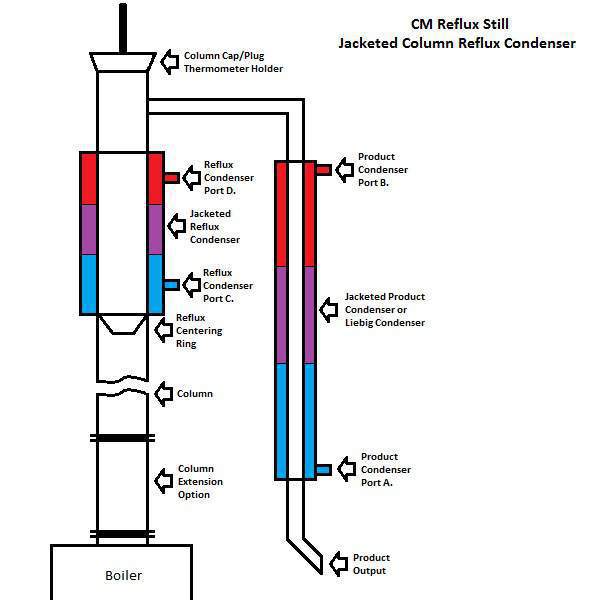

Now there are a few different designs out there as mentioned earlier. And hose routing is different between them. I have made a diagram for the two most used designs you can buy premade.
The first is a Mile High new style Jacketed column condenser. It has a jacketed area around the column that the water flows through. Cooling the outside of the column walls. Which is another problem I will cover later with another mod. Hose routing for this style should be as follows.
From the water tap or a recirculation pump to the input of the flow manifold.
From the ball valve on the manifold to Product condenser port A on diagram. Then out Product condenser port B to the drain or recirculation reservoir. If using a recirculation pump and reservoir.
From the needle valve to the Reflux condenser port C on the diagram. Then out Reflux condenser port D to the drain or recirculation reservoir.
The reason you want the coolant flowing from the bottom of the reflux condenser up and out the top is. You want it to be flooded at all times. If the flow was reversed it mite lead to a siphoning action pulling all the water out of the condenser. By it flowing up it has to fill it to the point of the outlet before it can leave. This maybe contradictory of the way it really should flow. But unless you can devise a system to make sure the condenser stays flooded at all times. The way I described it is the easiest and best way to do it. Especially for a new still operator.

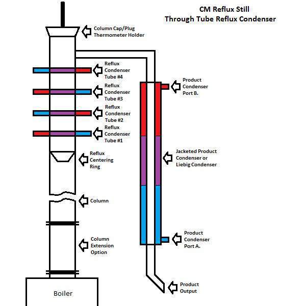

The second is the older Through tube reflux condenser style. Mile High’s first version was this type. Along with the one Brehaus sells the Essential Extractor PSII. These styles can have two or more through tubes. I have seen one with six. Can’t remember who made it? But anyway the reflux condenser on this style is comprised of tubes that are routed through the column. So one end of the tube sticks out one sid of the column and the other end the other side of the column. Some the tubes are criss crossed. Some are inline. My diagram shows a four tube inline setup. For ease of making the diagram. This style the water flowing through the tubes causes the vapors to condense on the tubes. And fall back down the column. The drip is not really centered but can drip in the center. So this style will also benefit from the mod I will go over later. Here is how the water should be routed for this style.
From the needle valve to the lowest most Reflux condenser tube in the column the. Out from the other side of that tube to the next higher tube. Out from the other side of that tube to the next higher tube. So on and so forth until you get to the upper most tube. Then out the last tube to the drain or recirculation reservoir.
And again for ease to keep the tubes full is why I described it this way. Although the tubes have been described as not having the same problems of not staying flooded. And yet others say they are worse.

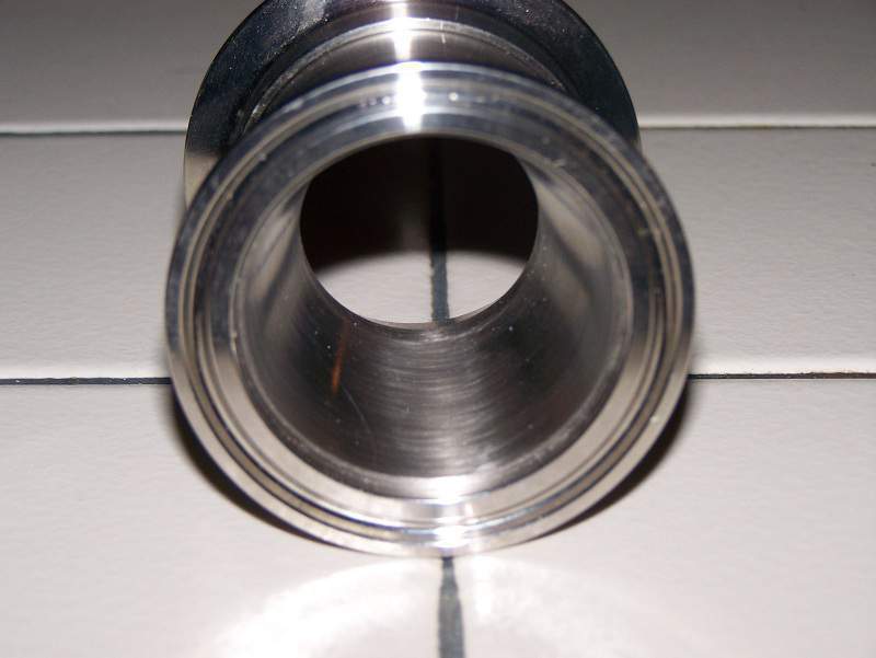

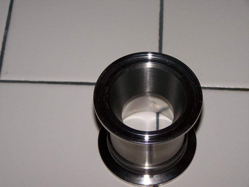

Prairiepiss already has the bases covered pretty good but here is what I did to my Brewhaus rig to improve it.
Eliminate the Rubber Bung:
To eliminate the rubber bung I had a 2'' Short Weld Tri-Clamp Ferrule added to the top of the column. I used a 2.0" Tri-Clover x Female Pipe Thread: 2.0" x 1/4" FMPT fitting with a 1/4 inch x 1/4 inch King Nipple fitting to hold my thermometer probe. I drilled out the 1/4 inch opening in the King Nipple with a 5/32 inch drill bit, this allowed my temperature probe to snugly fit into the opening. After gently compressing the King Nipple against the temperature probe it formed a vapor tight seal. No sealants were used on the probe.
Eliminating the Chemical Tolerant distillate collection hose:

Good post prairiepiss,i made a custome centering reducer out of stainless that is tri clamp to fit my column it reduces on both sides the iner is 1"1/4 for beter flow,as i can see a trap in just one sided reducer.and you can put your packing right to it to get the flow back to center of packing like you stated.
Prairiepiss
Master Distiller
Posts: 16355
Location: Heatland Prairie USA
Re: CM Still Output Improvement Mods Mile High / Brewhaus PS
Post by Prairiepiss » Mon Jan 09, 2012 4:50 pm
That's a nice centering ring. :thumbup:
