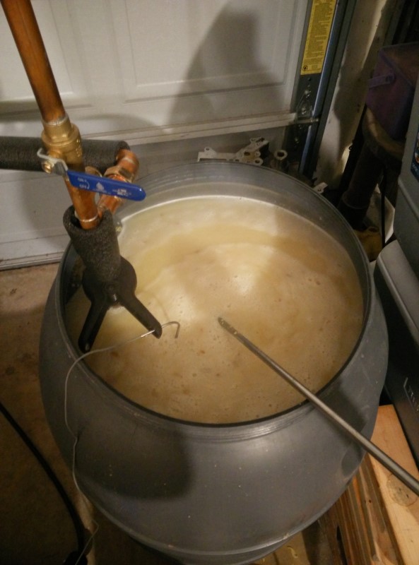

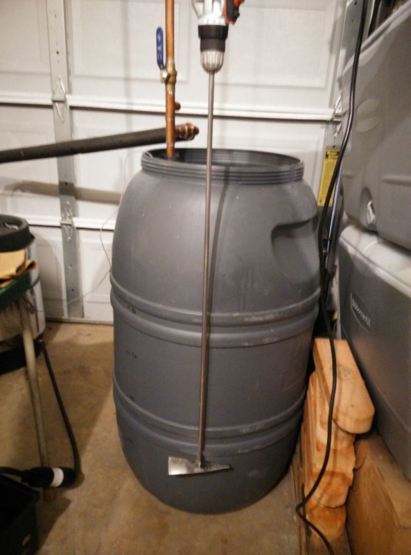

Its cookin' day. This is the first time I've done a batch this size and I thought I'd share it here with you good folk. You can see my steam injection attachment here http://homedistiller.org/forum/viewtopi ... 83&t=52926.
I started by graduating my big barrel at 10 gallon marks up to 40 gallons. I marked them on the outside with a sharpie, and 40 is right at a very easy to identify spot on this barrel. (Probably put all the pics in second post.) With 40 gallons of tap water in the barrel the PH was 7.5. Then I dumped in 2 50lb bags of cracked corn straight out of the bag. Then it sat uncovered in my dark, somewhat cold garage for a day and a half. I don't know if steeping is the right term for this so I'll just call it soaking for now.
Today its at 57 f with a pH of 6.3. According to Woodshed this pH should be perfect for the Sebstar high temp enzyme. Let's hope it doesn't change during heat up. There is a slight sign of bacterial activity in the barrel. Very slight smell of bread, and just a light layer of tiny bubbles on the surface. In a warmer environment this could be significant, but today its no problem.
I filled my 15.5 220v electric boiler with 14 gallons of tap water that was at 51f. Turned the element on full at 10:26 am. While I wait for it to boil I will set up the steamer and try to make sure I have everything I need out here in the garage.

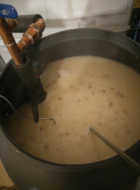

Its been 30 minutes and the steamer is all set up with the vent valve open. My boiler is at 146f (this number may be inaccurate. Temp probe was just stuck under the insulation.) Got out and cleaned my new as mash stirrer I bought from pintoshine. I've only got a 3\8ths drill to run it in right now but I can whip the whole barrel up using it. Pretty nice.

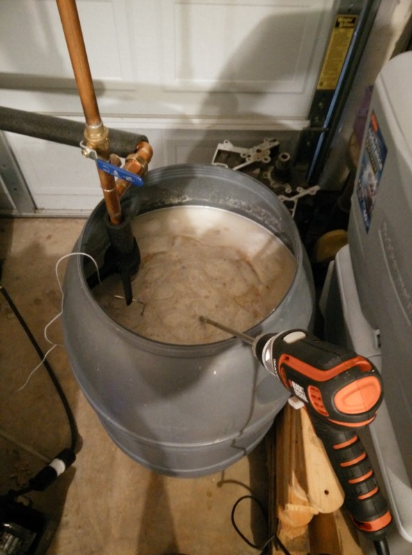

11:33am steam starts flowing out the vent and carrying along the ceiling. I turn my controller down to 12.5 amps and let it go for a little while to get the copper hot. Then I close the vent and turn it up to 15 amps. This is the part where I need a pressure gauge. I keep cracking the valve as if I can tell the pressure by the sound.. That gauge will be on before I do this again. Takes until 11:40 before I feel comfortable with it. Wrote this and then turned the power on full throttle 23 amps at 11:42.
Sebstar from the start this time. Mash is up to 71f. .36 x 100lbs of grain is 35ml of Sebstar. Put that in now and the starches will be broken down as they are released during gelatinization. This will keep the mash from ever becoming thick.
1 hour mark and mash barrel is at 111f. Smells good.
2 hour mark. 150f. Smelling good and getting slightly easier to mix. Even with no bubbles reaching the surface there's lots of steamy vapors coming off the surface.

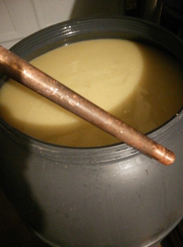

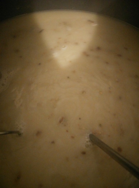

3 hour mark. 180f finally. From here I'm going to stir often and try to get it close to 188-9 before I turn off the steam. Its important to keep the temps even throughout the mash as you reach the upper limits of your enzymes. The Sebstar is good to 190f.

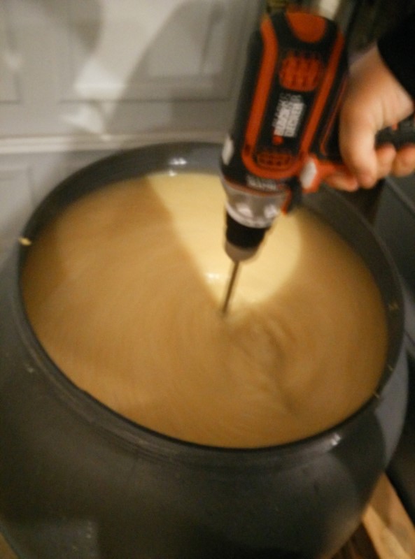

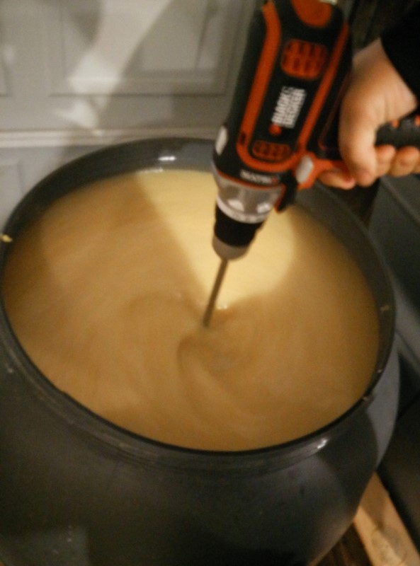

Alright I took another 15-20 minutes getting the mash up to 188 and flashing 189. Its very liquid. I threw a blanket over the fermentor and I'm going to go in the house for a while. Going to come back in about an hour and work on dropping the temp and pH. Maybe get some pictures up here while I wait.

With a 4 foot deep grain dense bath you don't lose much. If I let it go without stirring for too long it might have though.

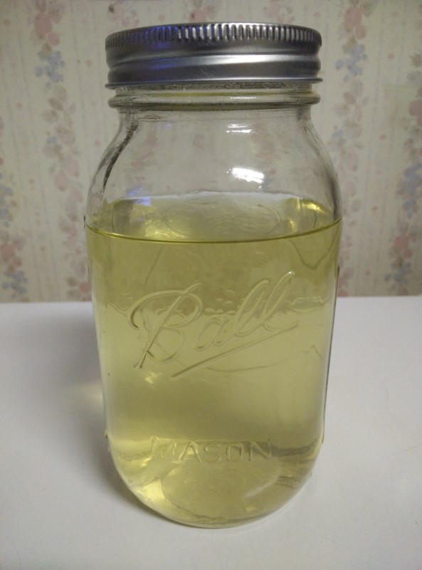

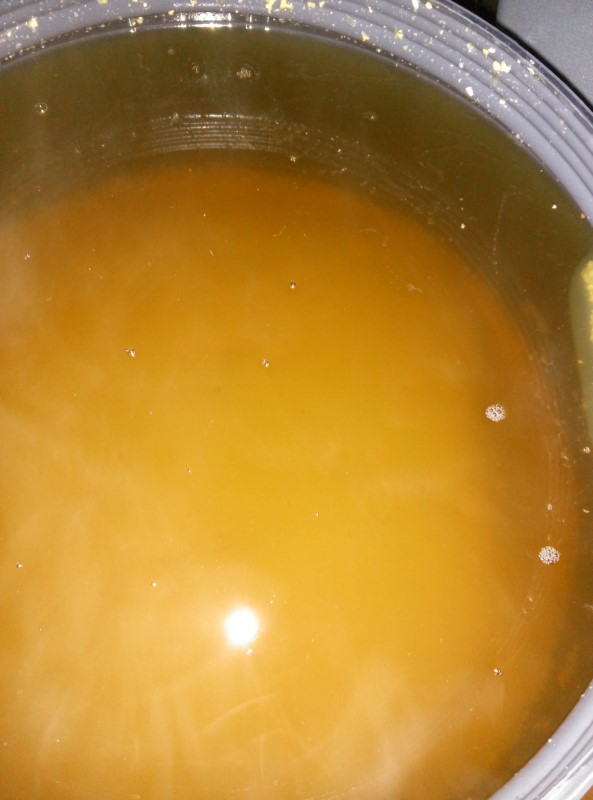

So I've added the Sebamyl now that I finally got the pH down to 5.3. I had read in the BCAC thread Woodshed likes his at 5.2 and I remembered it wrong lol. Either way I was out of time. 5.3 will do fine I'm sure. I removed the steam injector and mixed it all up a few times. I drained the boiler and it had 7.5 gallons left in it. So I added 6.5 gallons to the barrel this time.
The plan from here is to get up a little early tomorrow morning and start cooling off a wort sample and wake up some yeast in warm water. Then I will get a gravity reading, iodine test, and depending on the temps in the barrel I might pitch the yeast. If it's too hot it will have to wait till tomorrow night after work I guess.
I got a whooooole barrel full of all grain corn mash!!!

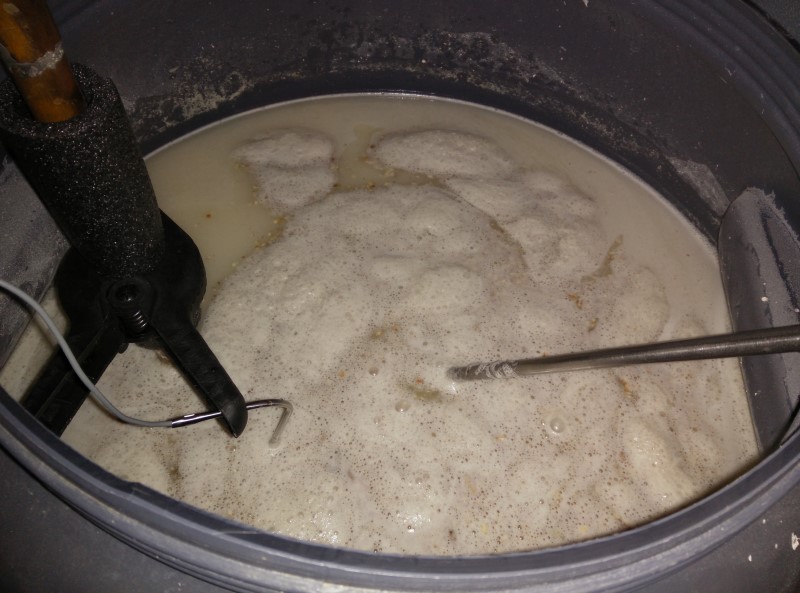

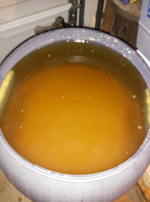

This morning I ended up not going to work (for a non-moonshine-related reason) and I got to finish this off the way I wanted to.bellybuster wrote:thanks Brutal, make sure you post up your SG once its done please.
I hope this thing doesn't foam up. I only have 2.5-3 inches of head space in there.

1.060 with cracked corn right out of the bag, Nice!! Now all I need is corn, scarce here right now. I got the enzymes in the mail last week.

Brutal, I'm predicting a fast and violent fermentation.
Hope you left enough head space in the fermenter.
- Brutal
- Posts: 1357
Re: Mashing 100lbs of cracked corn with steam injection
I didn't. Look forward to pictures of the carnage if you are right.shadylane wrote:Brutal, I'm predicting a fast and violent fermentation.
@Humbledore I didn't take it that way at all. I'm really not sure if it's aerated enough. I know I am risking under pitching here too with only three packets. I thought I had four..
This is my first full size baseline for making a batch like this. I will learn and tune the process from here and will share it all with you good folks. I could have never come this far without you. I have plans for a couple more barrel mashes like this and with the results from this I will be better prepared for those. There are so many things that can be changed. It really is an amazing hobby. Next batch is going to be a more conventional bourbon style mash. I have about 25 or so pounds of various malt grains hanging out that I think have been here a little too long to trust the enzymes in them. I think a 70% corn 30% various malt recipe is in order. I might even mix in some oats and make it 60% corn. My first thought is to ignore the malts and mash it just like I did this batch with the enzymes. Maybe stop at 149 on the heat up for a rest. Maybe not. I want to make a wheated bourbon ala Jimbo too. I'll be buying all new malt for that so maybe I should run it more conventionally? I could heat just the corn and sebstar to 190, and then instead of using the sebamyl just add the malted wheat at ~150? So many options. One thing I can't control is heat during the summer. I am going to have to use a yeast that likes it hot in a few months. Hoping for a nice calm cold ferment on this one with us-05 but I know I need more head space in that barrel. This batch will answer a few questions about yield too. Should I expect to keep closer to 3 gallons from this? or closer to 5 at barrel strength? If I was to distill on the grain how much would it raise those numbers? Is taste going to be affected from the trub? If so will it be good or bad? I want to create two main things. A product that I like in the white, and a product that ages well in the short term. They might end up being one in the same. Guess I've rambled on enough. Thanks folks.
