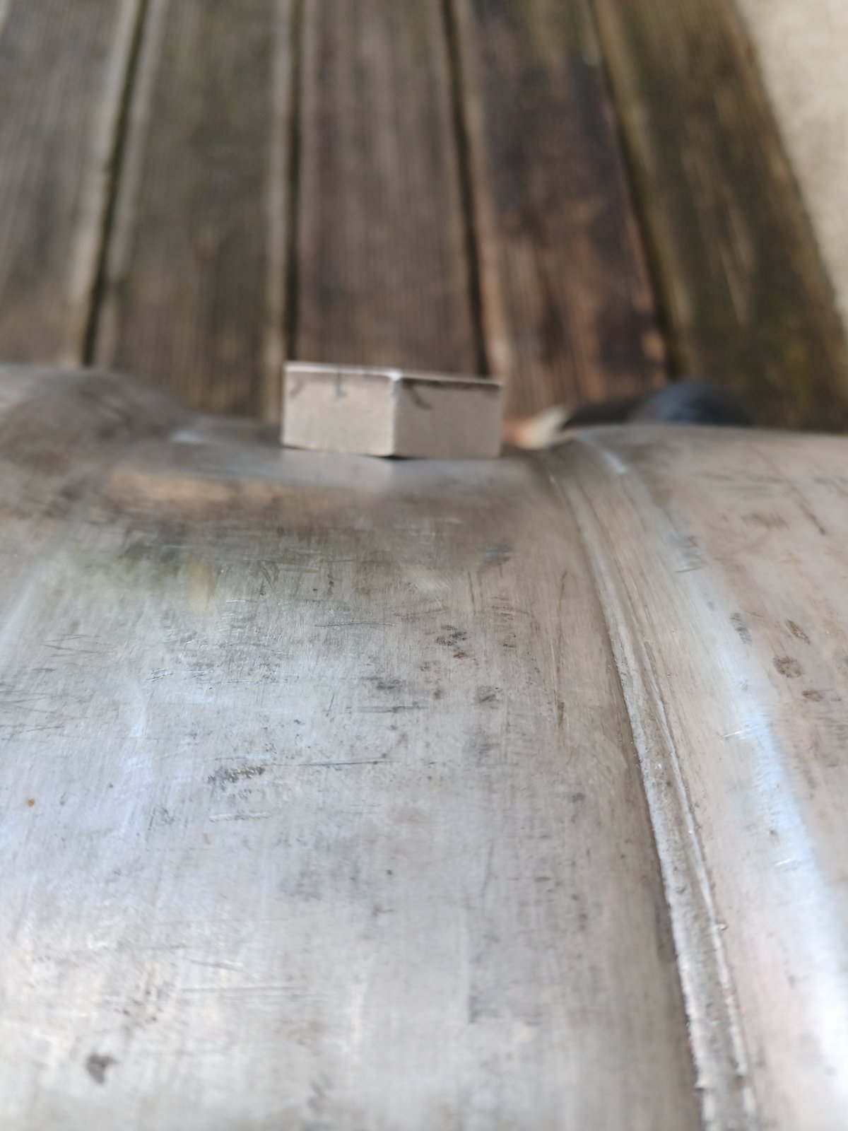

Re: CCVM still first time build
Thanks guys your support and advice is reminding me why i love forums and hate using FB.
Progress on the first hole/fit.
That's looking like it might do the job. When you come to heat it, you'll want to put more heat on the nut than on the keg as there's more material. Keep the heat moving all the time, but move it more on the nut. And maybe when the solder starts to melt and wick into the joint, put a bit of heat right inside the nut where you cut the shoulder to encourage it all the way inside. That way you it'll be sealed on the inside of the keg as well (And you'll get a nice solid joint). I suspect that a soldered joint like that will handle any stress you put on it as well as a TIGed one.

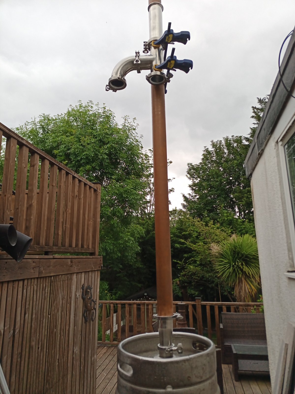

Quick update.
I've had a couple of "Spare" hours, so cut the copper column to length and made another easy flange on the other end, cleaned up and faced off.
All fitted together lovely so I'm very pleased with progress so far. I now need to turn my attention to what PC I make.
I have about 40" of 2.5" copper left, plus several lengths of 28mm, 22mm, 15mm and a coil of 10mm. And a foot of 3" that I found!
Suggestions very welcome!
Make Booze, not War!
You could make a liebig from the 22mm and 15mm but I would suggest a shotgun using the 2.5" and the 15mm. Its a bit more difficult to build but with a flange would fit your existing TC set up and be a lot more compact.
Short update to my progress here, as I'm very frustrated. It's rare that I let something beat me.
I have tried 3 times to silver solder the element inserts into the keg and, despite doing the research, the nice tight fit on the turned shoulder, good prep and having what seems to be the correct materials (5% silver solder, kester liquid flux) I simply cannot get the solder to take well.
After the 3rd attempt with the solder beading off and clumping, I called it a day.
My time is too precious at the moment to keep wasting it.
I reached out to a few local friends and managed to get a guy in a local car specialist place to tig them in (Back flushed, proper job) for £50, picking the keg back up next week.
I wish I'd done that to begin with...
My keg boiler took a while too. In the end I had one little pin hole leak around the element fitting. Solved that by using some soft plumber's solder as a filler with less heat so as not to liquefy the silver solder. I got that good advice from Swedish Pride who is well known for f'ing things up and finding ways to fix it - man's a genius...
Price seems reasonable so not a total loss.MooseMan wrote: ↑Fri Jul 02, 2021 3:01 am Short update to my progress here, as I'm very frustrated. It's rare that I let something beat me.
That said. Which flux was it? I just took a look at the Kester product line and their liquid fluxes seem to all be for wave soldering of circuit boards. You need a flux designed for use with stainless steel. I have one from Griffon (A Belgian manufacturer which is for stainless and zinc). StayBrite have one which you might have more joy getting in the UK than I had in Europe. If it doesn't specifically mention that it's for stainless, then it probably won't work. If you have any friends in the roofing trade who work with zinc, ask if you can test their flux.
If it's not the flux then I'd guess that you didn't get it hot enough. You do really want to try and get some solder to flow onto a piece of scrap before you start working on the real thing though. Just to get an idea of how it behaves,
Thanks guys, I think the flux may not be the correct one, I was given it when I asked at work for "Acid flux" and didn't want to explain further.
I did look around for flux specific to stainless, and the only one I found that's not online order was £40, so for another tenner I'm actually very happy that I'm having them tigged in.
I would have spent way more by the time i bought the flux and higher silver bearing solder.
I'll still give the area as good a polish as I can when I get it back, just to make sure. I can get a finger in and around to the back of the weld.
Is there anything recommended to use for helping re-passivate?
NormandieStill wrote: ↑Fri Jul 02, 2021 11:38 amNeglected to mention, before I had a go at the keg, I tried soldering the waste nipples that I parted off my inserts, to a scrap bit of stainless plate, and got a bead, but nowhere near good enough for a seal, and it didn't have any strength at all.
Possibly got a partial result with that as there was no real material mass, to wick away the heat.

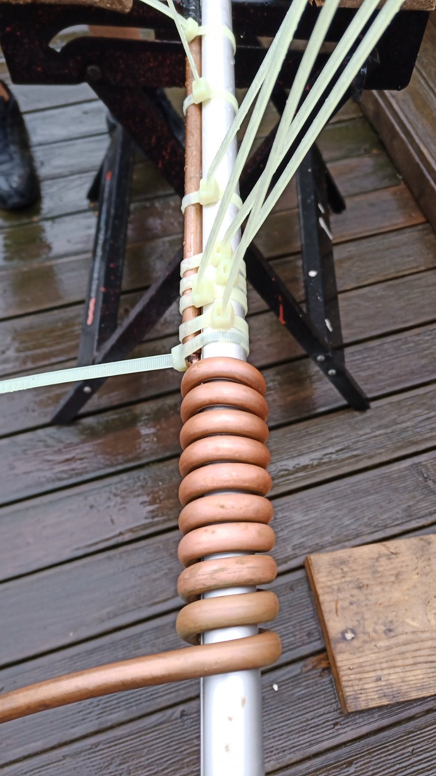

First go at winding a coil went surprisingly well!
3/8" packed with well dried builders sand. Made a rough and ready mandrel out of a length of Ali that had a useful flat on it to help hold the copper tail.
A mate came over to rotate the mandrel for me while I ran the coil over it nice and slow.
Not at all pretty, but it should do the job, great water flow through it too.
Coils for some members are one of the hardest part of the still to build. My first still was a VM with a double helix coil. I was lucky enough to pick up a couple pillow blocks for cheap at a garage sale that made the job a lot easier. I also filled the tube with silica sand, a lot easier than salt to remove to keep it from kinking.
Good job, should serve you well.
Thanks Bushman I'm really pleased with how it went. I expected some flattening and thought it would be harder to keep tight to the mandrel, but it wound pretty easily really!Bushman wrote: ↑Sat Jul 03, 2021 7:21 am Coils for some members are one of the hardest part of the still to build. My first still was a VM with a double helix coil. I was lucky enough to pick up a couple pillow blocks for cheap at a garage sale that made the job a lot easier. I also filled the tube with silica sand, a lot easier than salt to remove to keep it from kinking.
I had no pillow blocks/bearings, so I used a pair of house bricks (The type with holes in) lined with plastic film to rotate the mandrel in. Very rough and ready!
In fact it went so easily that I'm thinking of doing it again and making a Dimroth type PC, instead of buying copper sheet to make a shotgun.
Will a Dimroth knock down as well in 2.5" do you think?
Yes. I have made and used a 2”, 3”, and 4” dimroth style condenser in my columns and I have a 2” dimroth PC that I’ve used with success for years. Designed/sized right they offer a lot of knockdown power in a compact space, similar to a shotty. Otis
I should note there is one issue I have found with a dimroth PC. Product output can be warm or hot at higher powers. The issue is that the shell of the dimroth is heated by vapor and the shell is not cooled (unless you do some extra design work). Product cooled by the coil drips onto parts warmed by the shell before existing the condenser giving you warmer output. My 2” dimroth will produce cool output up to about 2000- 2500w before it starts coming out warm. Stripping at 5500w my output is very warm. Warm output has never been a problem for me, but I did build a 2” shotty I use more now and am happy with its performance. My dimroth can be seen in the Pot-n-thumper thread in my signature below, and i built my shotty with Twisted Brick’s plates that he sells.
Thanks for the info Otis, really useful!
I do understand what you mean regarding the shell warming the product back up after its dripped off the coil.
This may, oddly, not be a problem for me, as I was planning to make some kind of "Brace" or leg to support the PC section and make the still setup in general a little more stable.
So if I surrounded the bottom section of the Dimroth shell with Ali and bolted on a couple of heatsinks, this should provide extra cooling mass and keep the shell much cooler?
If it still proves an issue I could even add a couple of 12v computer fans to add air cooling!?
(Fully air cooled still was actually my intention when I started research, but I think I need to learn to run a still first before I start getting clever!)
